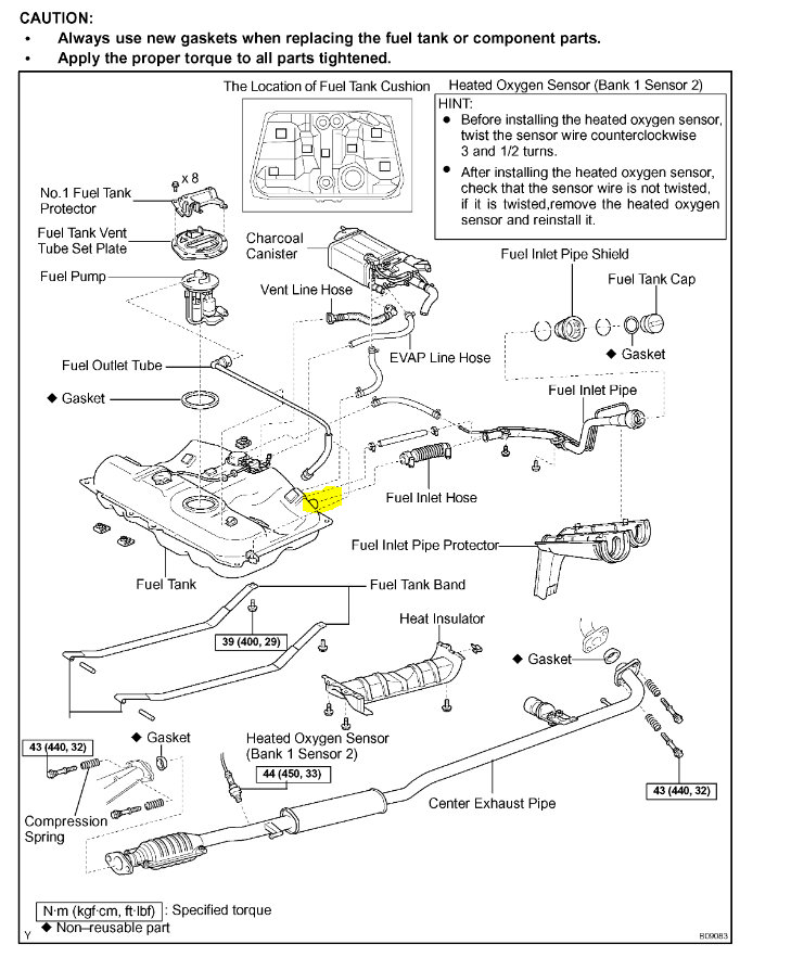

hello, i have the car listed above that was in an accident.
The car was total, and i have a full tank of gas that i would like to siphon out, but
the problem is the tank has a restriction stopping the hose. so, i removed
the fuel relay and jump the contacts, and my fuel line is removed from the
fuel rail, and i turn the key on, and i don't get any fuel from the line. Any idea
how to get the fuel pump to pump, don't have time to drop the tank. thanks
Sep 7, 2022 at 5:26 AM
SQM
  • 6,383 POSTS
You will have to remove the fuel filler tube from the tank and then use a siphon to remove fuel.
See attached picture for reference.
Here is a helpful video:
https://youtu.be/Q5MH2gnyFH0
Let me know if you have any questions.
