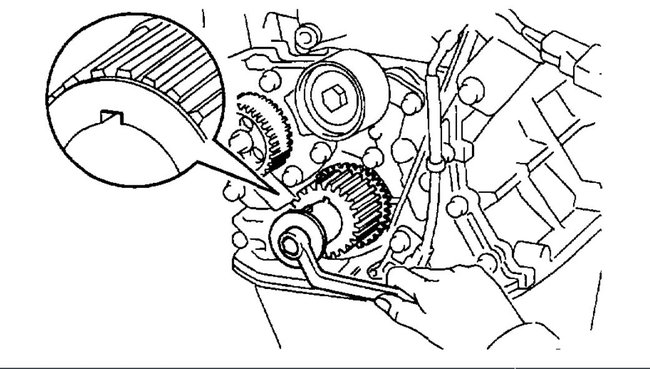

I miss set the timing. Can you help me set the timing right please?

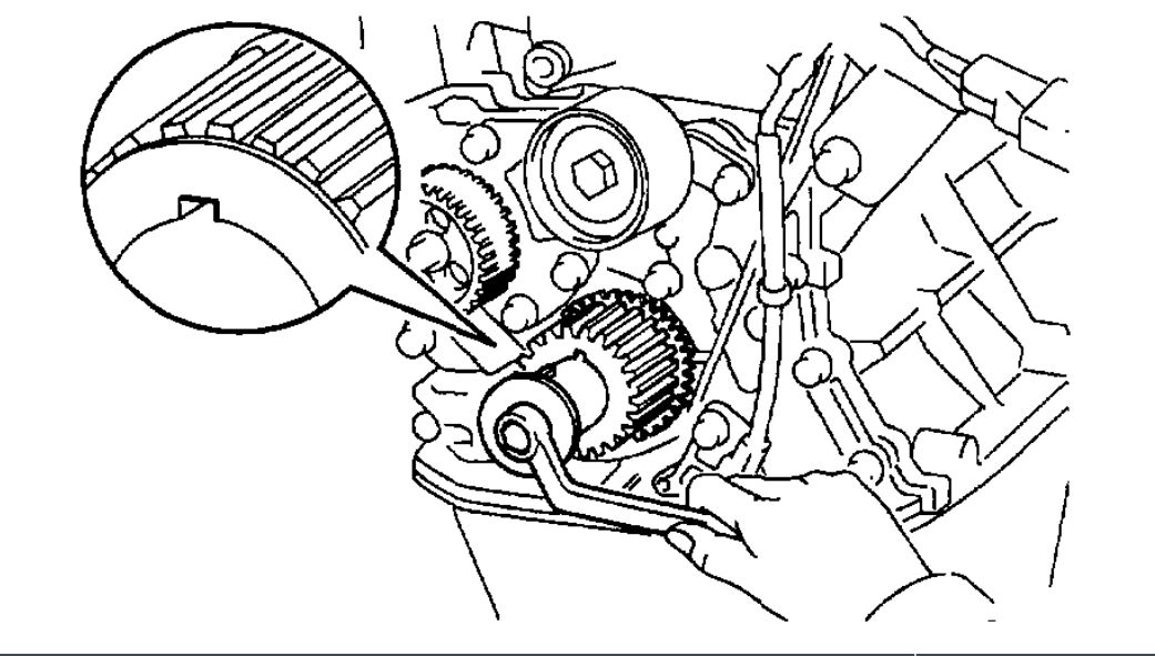

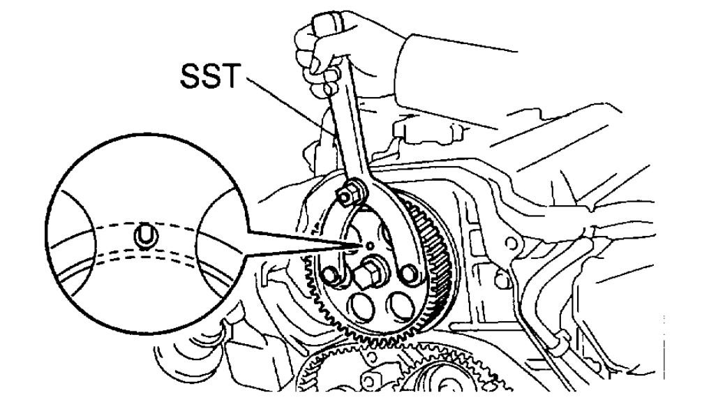

The cam gear has a dot and I posted a picture of it for you. It has to be straight up.
The crank gear has a dowel pin. that pin goes straight up as well.
I attached a YouTube video as well for you.
