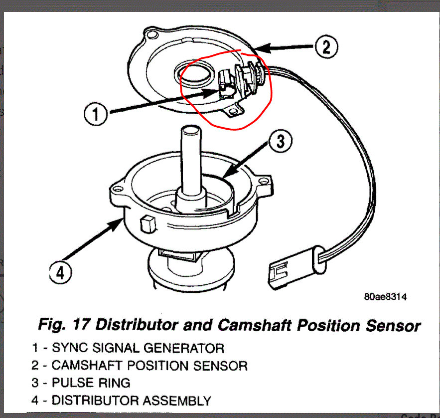

The timing isn't adjustable on this vehicle. As far as the sync issue, I would really like to know what code was found, but I suspect it deals with the camshaft position sensor. These distributors are equipped with an internal camshaft position (fuel sync) sensor. If it is failing, injection timing could be off.

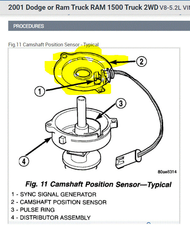

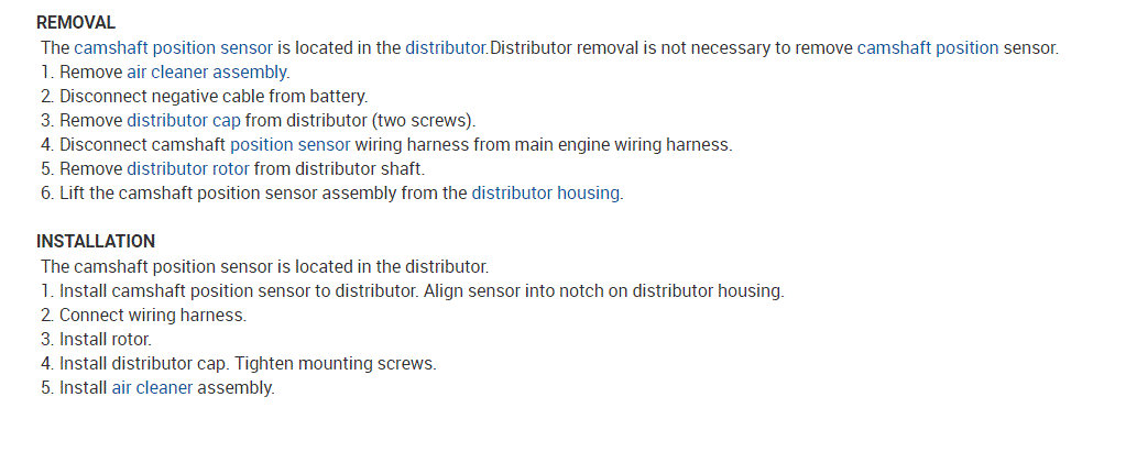

If you look at the attached picture, it shows the part I am referring to. Pics 2 and three are the directions for replacement. The first thing I suggest is to remove the cap and rotor. make sure there is no oil getting into the distributor. The distributor has an internal seal to prevent oil from entering the distributor. If the seal failed, it could be causing the issue.

Thanks, but what and where is the sync signal generator? Frank
Mar 28, 2021 at 10:01 PM
  • 110,248 POSTS

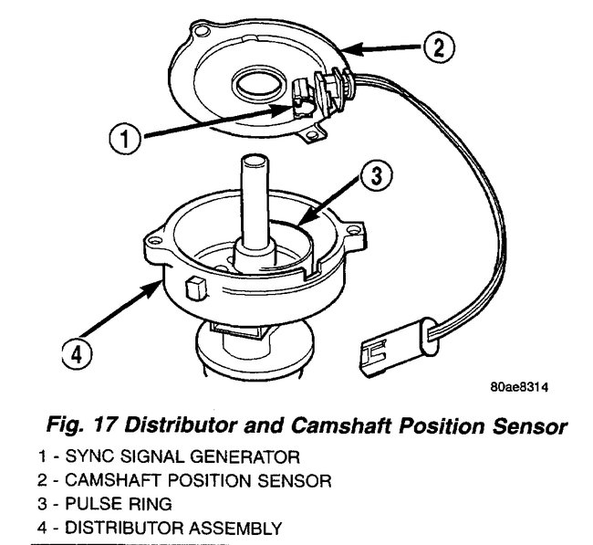

That is the component in the distributor. See the pic below.
Mar 29, 2021 at 11:54 AM
FRANKIEDONNN
  • 60 POSTS
in other words, it's the cam-sensor/ pick-up coil. i thought that might be the answer, it is just that i never heard it called the signal generator before now. in the automotive world, things have many names. by the way, i adjusted the sync. and it now says in range, but i have to drive it and see if it remains in range. i wonder if the sync has to be reset whenever the adaptive are reset because i still don't know why it was out of range if the distributor was not moved. i only recently learned that when parts are replaced that the adaptive have to be reset, and i have replaced some parts. Thanks
