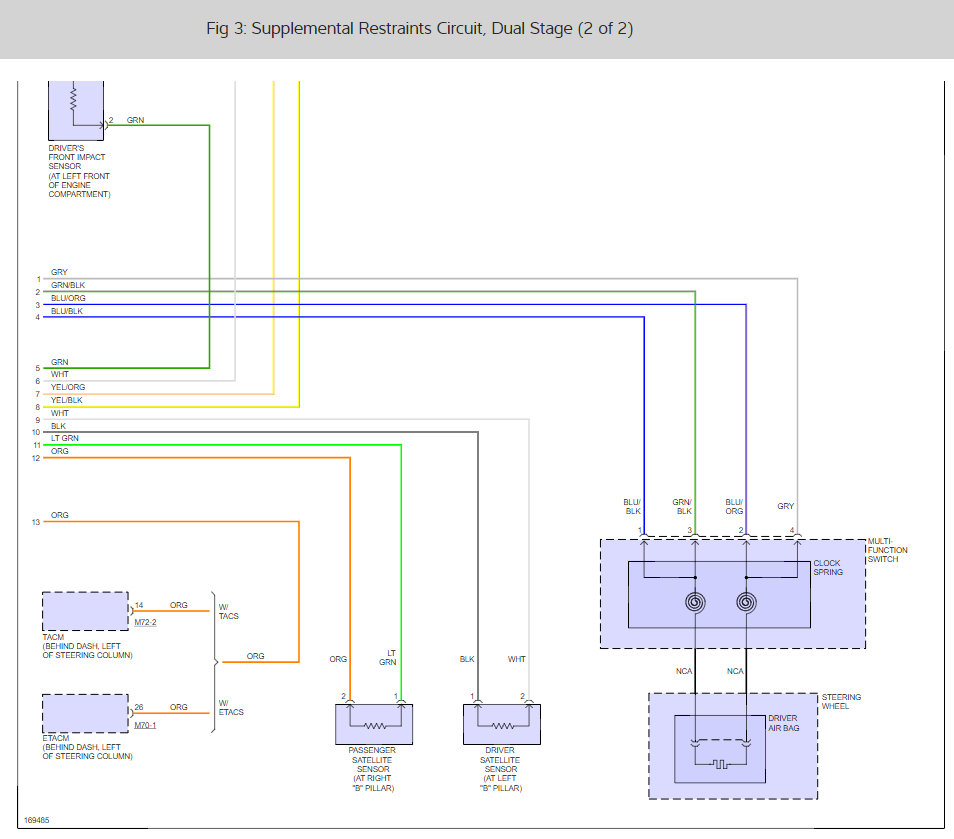

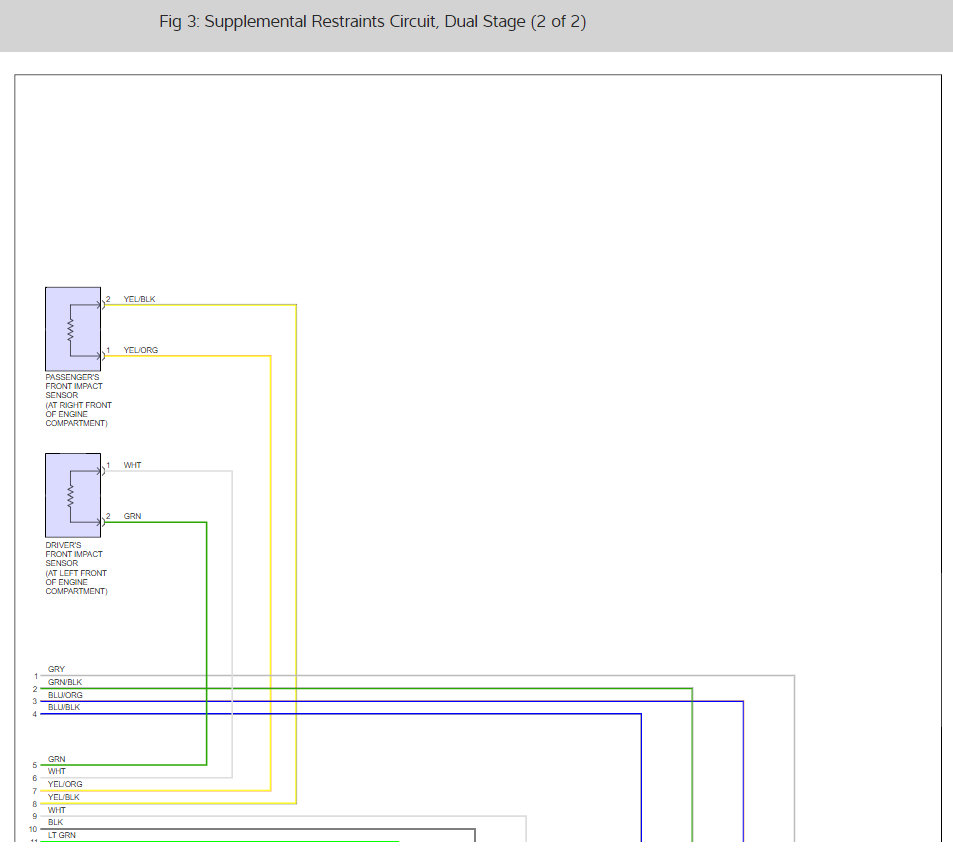

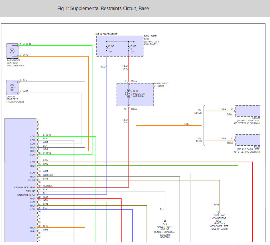

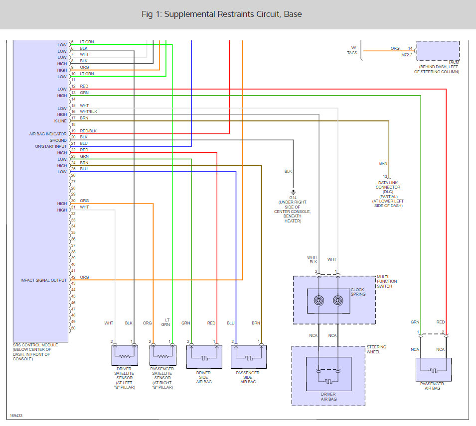

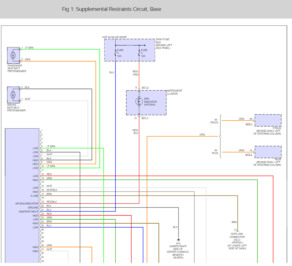

Can I get a seat belt wiring diagram for the warning system please?

Yes, I have found these seat belt safety wiring diagrams for you (below).

Thanks Ken, kindly help me I want only seat belt wiring diagram chart.

The seat belt wiring is in the diagrams, you are going to need to reference. They do not have just the seat belt wiring.
