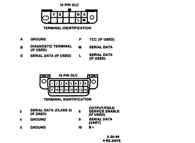

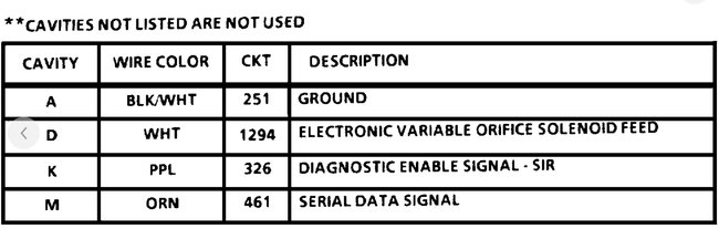

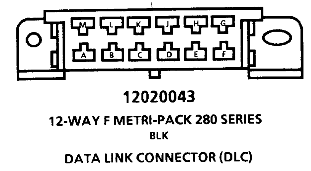

My car has a service engine soon light on. The scanner port is the same shape as an obd1 scanner but the two pins on the scanner that are close together are side to side and on my car the two pin terminals are up and down. I was told about it being a obd1.5, but I cannot find one that I can buy and the obd2 scanner does not have the same shape plug.

Following is some information on pulling the codes without a scan tool.
FLASHING DIAGNOSTIC TROUBLE CODES WITH 12 PIN DATA LINK CONNECTOR (DLC)
Due to software changes and the removal of the diagnostic enable circuit (by using 16 pin DLC), Diagnostic Trouble Codes (DTCs) may no longer he obtained by grounding "A" to "B" at the Data Link Connector (DLC). The use of a Tech 1 scan tool or equivalent will be needed to obtain both curent and history DTCs. If the vehicle has a 12 pin DLC that contains a pin "B" then flashing codes MAY be possible by following this procedure.
Although it is recommended that a diagnostic scan tool be used to read diagnostic trouble code(s), it may be possible to flash trouble codes on certain vehicles equipped with a 12 pin DLC. The DLC terminal "B" (diagnostic terminal, if equipped) is the second terminal from the right of the DLC's top row. The terminal is grounded by connecting it to terminal "A" (internal PCM ground), the terminal to the right of terminal "B" on the top row of the DLC.
Once terminals "A" and "B" have been connected, the ignition switch must be moved to the "ON" position, with the engine not running. At this point, the Malfunction Indicator Lamp (MIL) (Service Engine Soon/Check Engine) should flash Diagnostic Trouble Code (DTC) 12 three times consecutively. This would be the following flash sequence: "flash, pause, flash-flash, long pause, flash, pause, flash-flash, long pause, flash, pause, flash-flash." DTC 12 indicates that the diagnostic system is operating. If DTC 12 is not indicated, a problem is present within the diagnostic system itself, and the Diagnostic System Check should be performed.
Following the output of DTC 12, the MIL (Service Engine Soon/Check Engine) will indicate a diagnostic trouble code three times if a diagnostic trouble code is present, or it will continue to output DTC 12. If more than one diagnostic trouble code has been stored in memory, the diagnostic trouble codes will be output from the lowest to the highest, with each diagnostic trouble code being displayed three times.

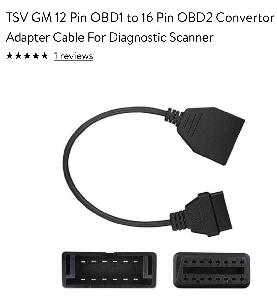

How do I know if the scan tool is a tech 1? I have a cen-tech obdII/EOBD and a simple LED obdII scanner if one of these would work then all I need is the cable adapter right?
Jun 28, 2018 at 10:22 AM
There is no adapter from obd 2 to obd 1.
You need a real scan tool that can read obd 1 systems. Your readers are for obd 2 only.

Why is it that I can buy an obd1 scanner for 1986-1993 for $30.00 and an obd2 scanner for newer vehicles for $110.00 but there is not one for a 1994 without breaking the bank. Also, there is an adapter from a 16 pin to a 12 pin.
Jun 28, 2018 at 10:34 AM
1994 is a different scanner and I guess no one manufactured a simple one. The advanced ones will read it.
As far as the adapter, be careful, it may only read up to the 1993 and then you will be out the money for the adapter.
