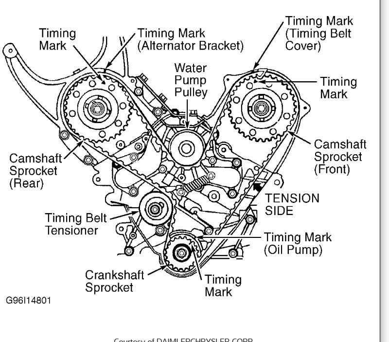

264,000 MILES • 3.0L • 6 CYL • 2WD • AUTOMATIC
MR.OSOLOC

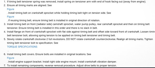

I fix the rear seal cause it was leaking n i put it to timing marks put the new timing belt on n it wont start it wants to strt but it wont start i took it apart like three times it has new spark plugs new distribarator cap new rotor new wires
Sep 3, 2016 at 1:20 PM
HMAC300
  • 48,601 POSTS
see pics make sure you have it at tdc prior to starting.....
