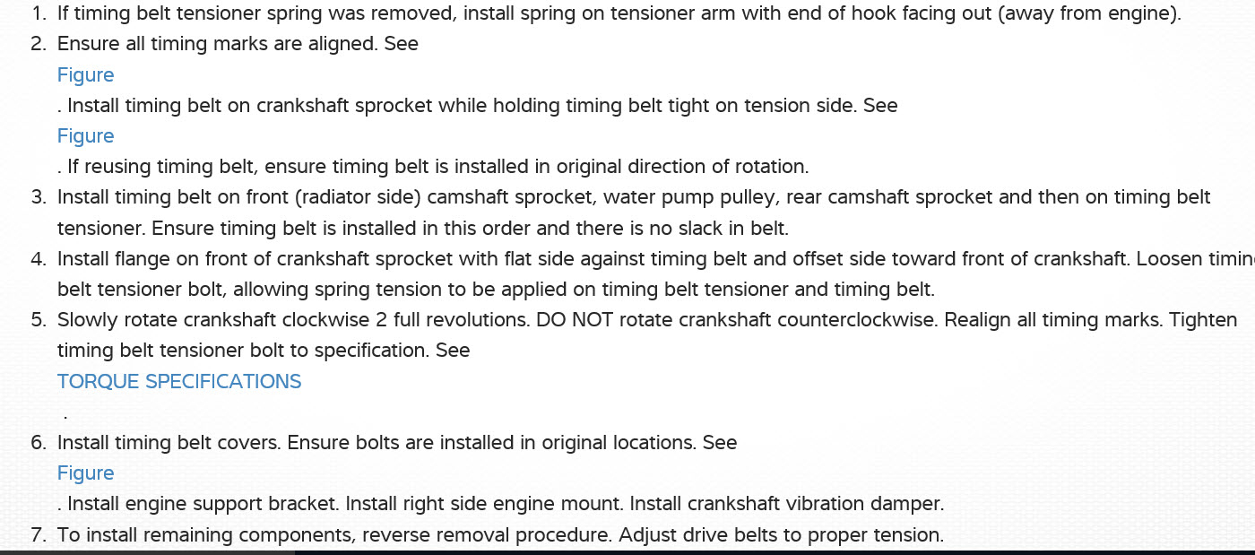

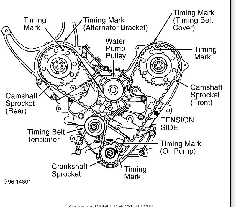

I fix the rear seal cause it was leaking n I put it to timing marks put the new timing belt on n it wont start it wants to strt but it wont start I took it apart like three times it has new spark plugs new distribarator cap new rotor new wires

See pics make sure you have it at tdc prior to starting.
