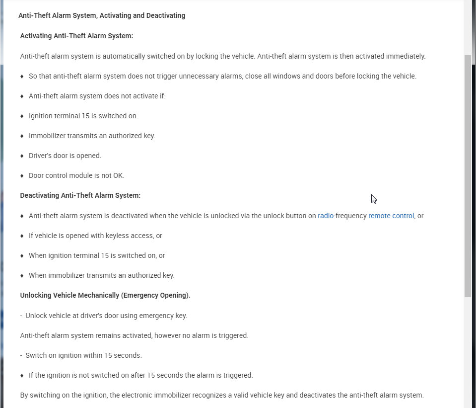

I just bought this car an I was told to check my fuses because my A/C wasn’t working. After finding out most of my fuses are in the wrong place I fixed it. now my car won’t crank anymore. something about anti security and my car didn’t come with the manual.
Jul 18, 2020 at 1:23 AM
I attached the info on activating and deactivating the system. When you say your fuses were in the wrong place, do you mean the amperage of the fuses were wrong?
Let me know and let me know if you need more info. Thanks
