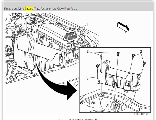

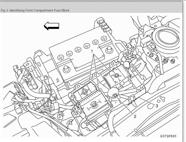

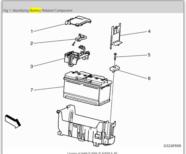

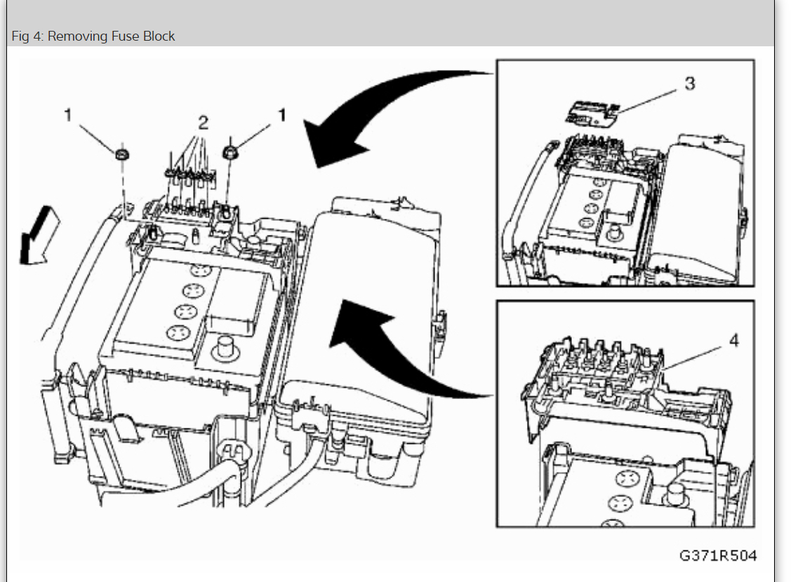

I would install a new battery so jumpers are not needed, but before you reconnect the negative cable turn the key on. This should reset the security system. Here is a guide to help walk you through the battery install and diagrams below to show you how on your car:
