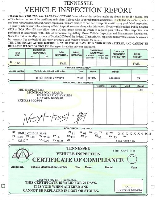

Hope this file can clarify issue I'm having.
Aug 27, 2016 at 4:11 AM
SATURNTECH9
  • 30,869 POSTS
I can't zoom in to read it.
Aug 27, 2016 at 12:51 PM
KEN ANAME
  • 7 POSTS
says obd inspection monitors not ready: evaporative system
oxygen sensor. how do i resetwithout taking car apart?
Aug 28, 2016 at 6:05 AM
SATURNTECH9
  • 30,869 POSTS
So you only have two monitors not set?
Aug 28, 2016 at 7:14 AM
KEN ANAME
  • 7 POSTS
That is correct. What do I do?
Aug 28, 2016 at 10:30 AM
SATURNTECH9
  • 30,869 POSTS
So again how far has it been driven since the battery and codes have been cleared?
Aug 28, 2016 at 12:22 PM
KEN ANAME
  • 7 POSTS
It has been driven about 20 miles since battery has been changed. Can't be driven further until registered to be on road.
Aug 29, 2016 at 2:00 AM
SATURNTECH9
  • 30,869 POSTS
20 miles isn't far enough to set the monitors it will have to be driven Alot further.To set the evap monitor you will have to have 3/4 of a tank or more.Can you get a temporary moving pass?Otherwise your never going to get the monitors set.
Aug 29, 2016 at 11:05 AM
KEN ANAME
  • 7 POSTS
How many miles does it need to reset. Approximately? I'll see what I can do.
Aug 30, 2016 at 5:00 AM
SATURNTECH9
  • 30,869 POSTS
Honestly it varies from car to car even the same make and models .Some pretty quick some take more time.For the evap make sure it's got a 3/4 tank of gas or fuller to set the evap monitor.
