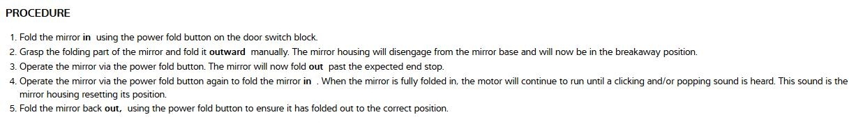

When I unlock or close door, side mirror folds the wrong way instead of inward. How do I disable this completely?

I found a TSB on incorrect mirror position, follow this procedure and it may fix the problem, otherwise you may have to speak to a dealer.

okay, please re post when you try this out and let me know how it goes.

Hello, it has not worked so far but I will have my husband try it.
Jun 20, 2017 at 1:48 AM
TANYA BRYANT2
Is there a way to reprogram the key to factory settings because the previous owner set it to fold it when he locks the door and fold outward when unlocking. But it's going out too far and it clicks several times like it it's going to break off

the info i send is for that problem, please re try as described, this came from BMW if no luck you will have to contact a dealer.
