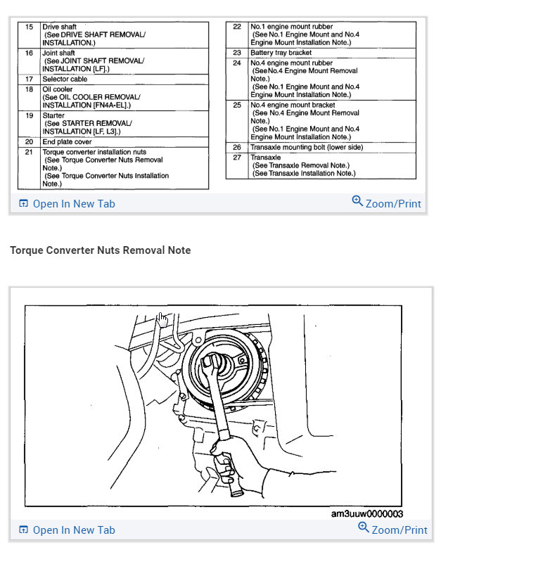

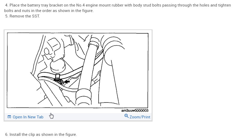

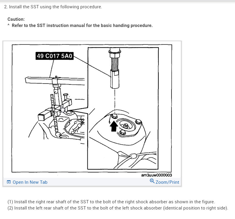

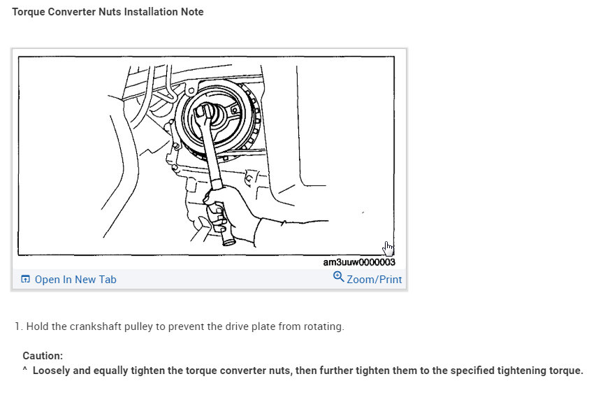

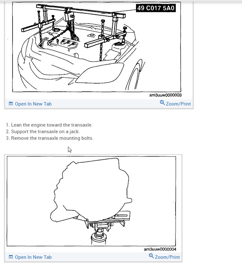

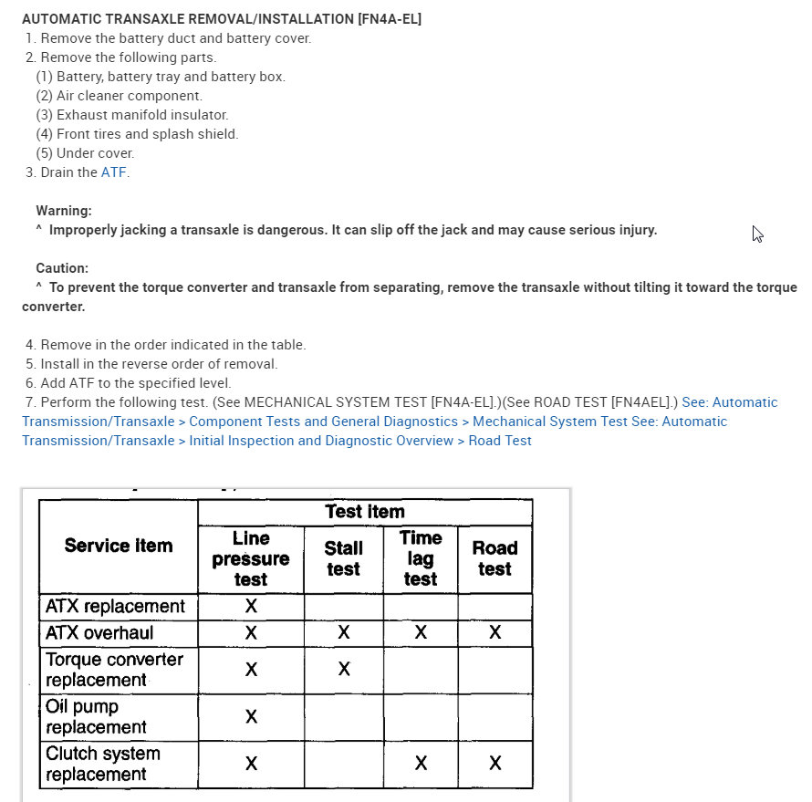

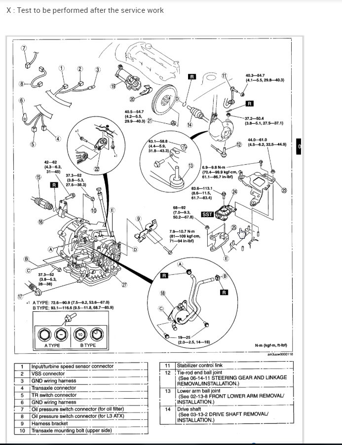

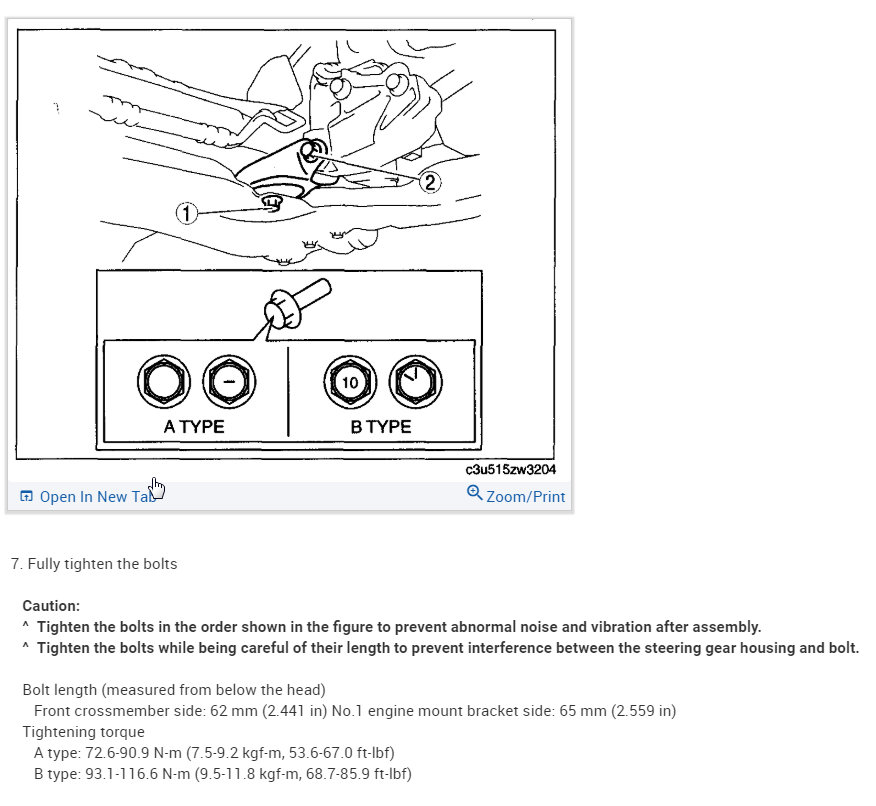

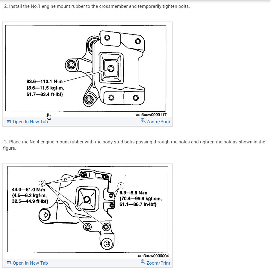

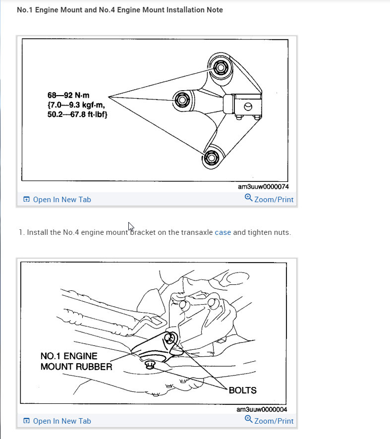

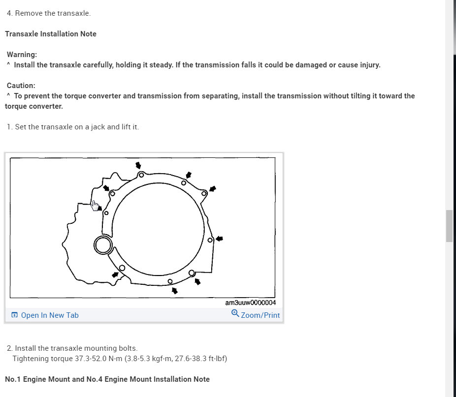

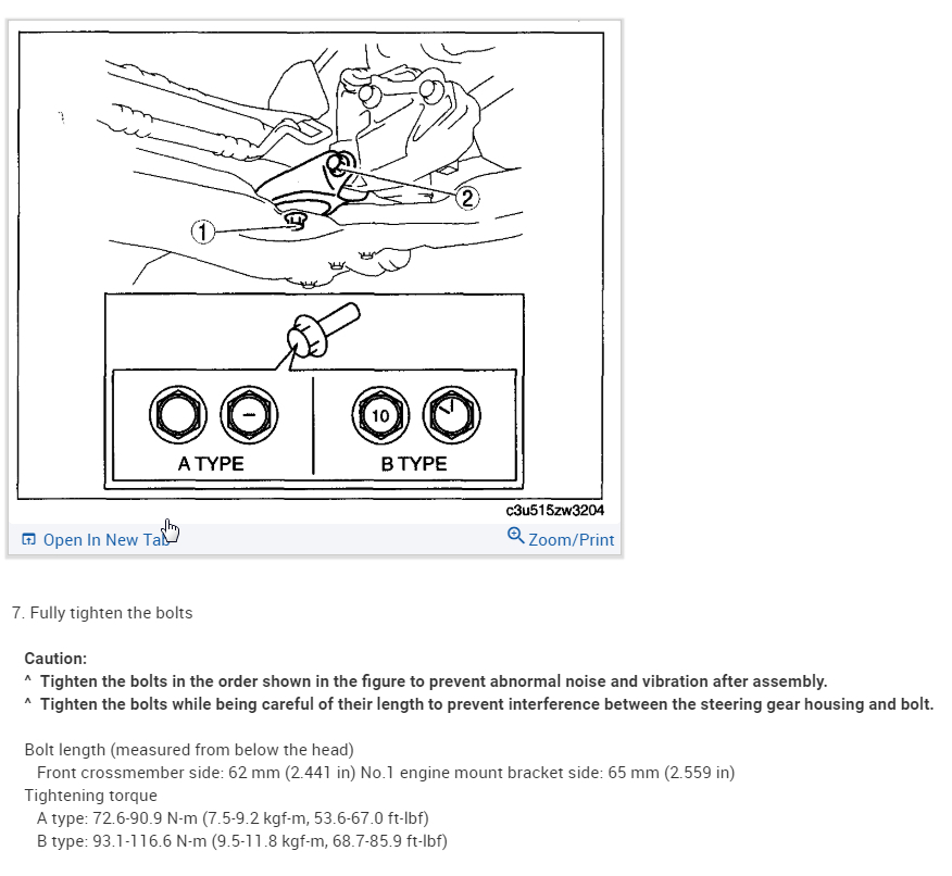

I have the car listed above with an automatic transmission. I’m trying to figure out how to replace the transmission.
Jul 2, 2019 at 10:50 AM
Hi Jsanes,

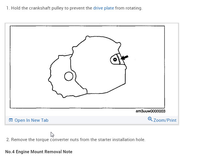

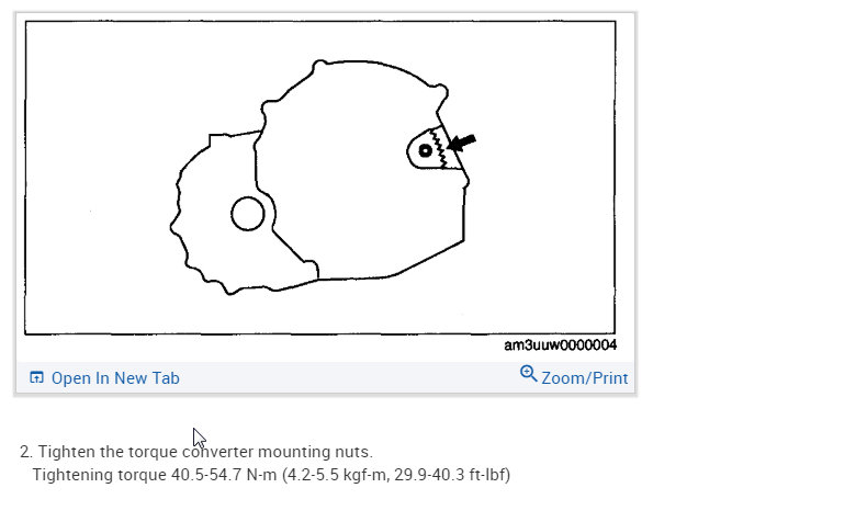

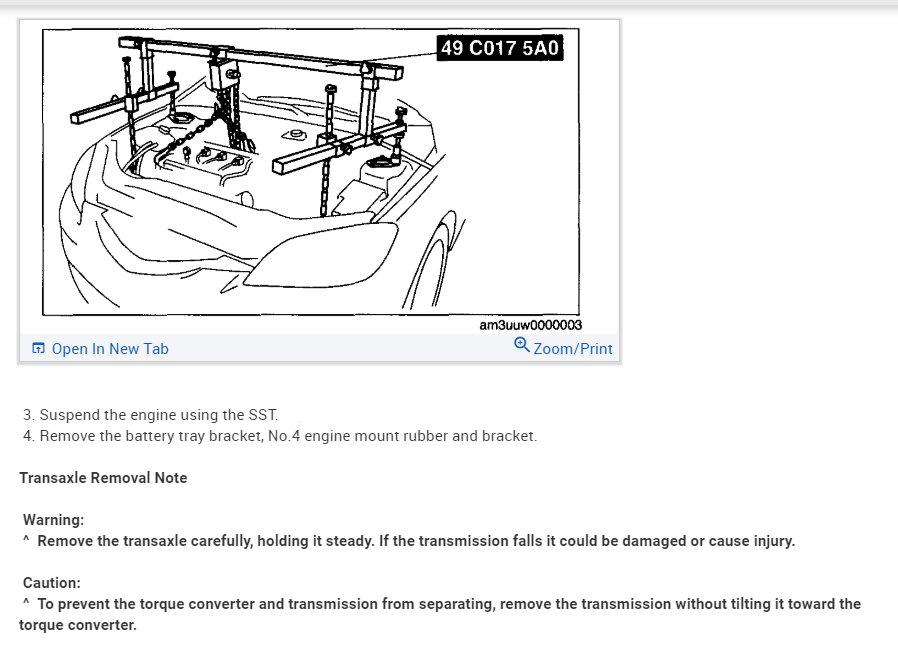

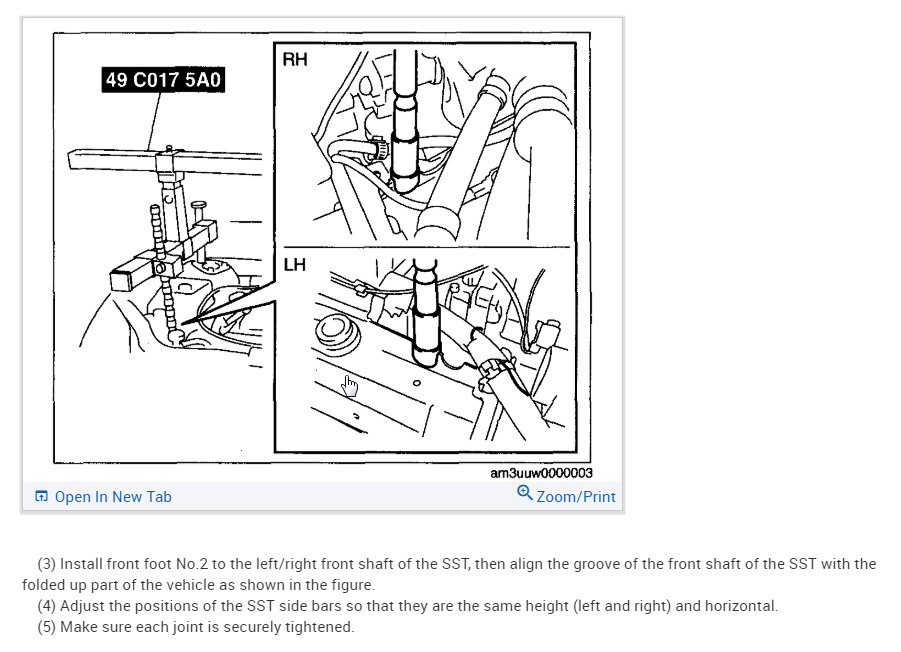

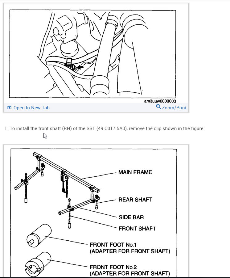

Here is the process on how to replace the unit. Check out the diagrams (Below). Please let us know if you need anything else to get the problem fixed. Thanks
Jul 2, 2019 at 11:43 AM

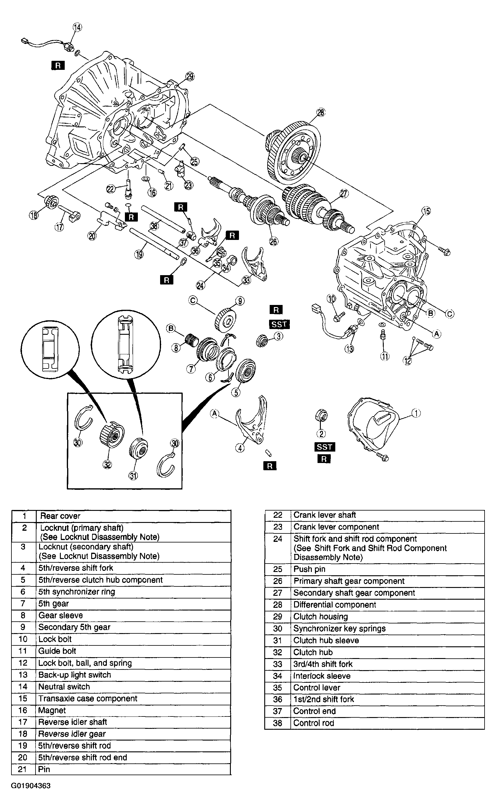

I am separating transmission from bell-housing to replace sealant can you help me?
Oct 14, 2020 at 5:35 AM (Merged)
DOCFIXIT
  • 18,828 POSTS
Here is an exploded view of the transmission so you can see how it comes apart for repairs. Check out the diagrams (Below). Please let us know if you need anything else to get the problem fixed.
