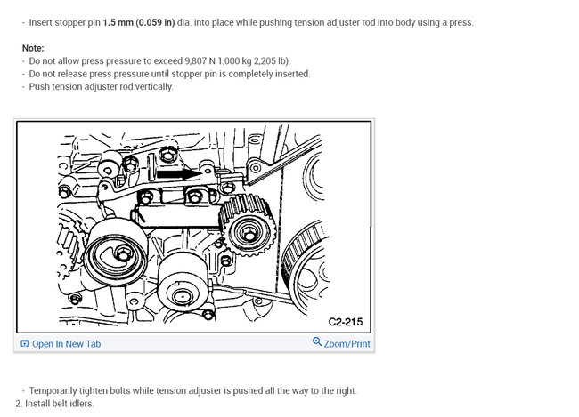

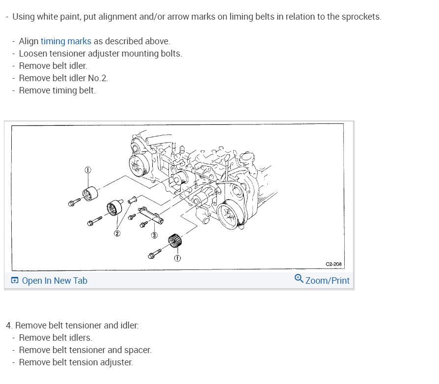

I was changing the water pump and I think I messed up on putting the timing belt back on because now the car won't start, it just makes a noise. which is in the video attached .
Jun 4, 2023 at 6:13 PM
  • 55,433 POSTS

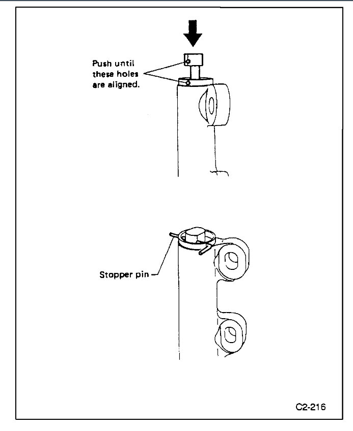

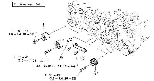

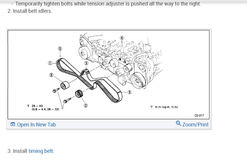

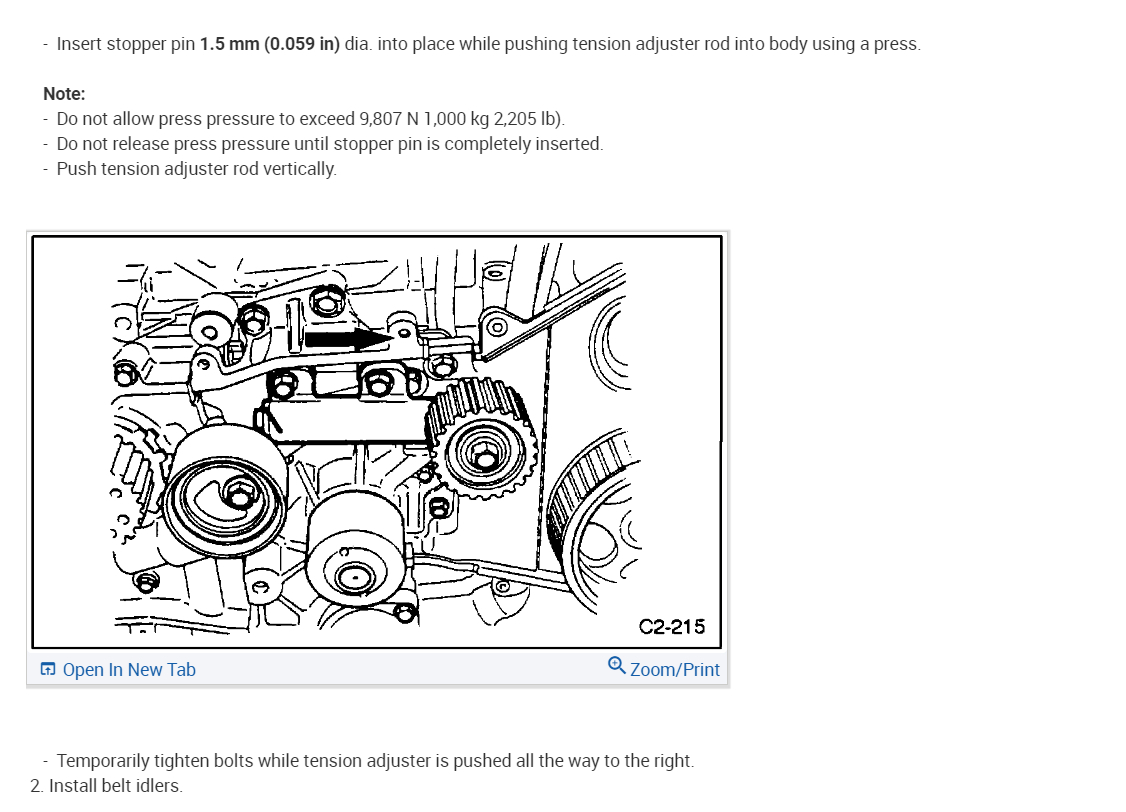

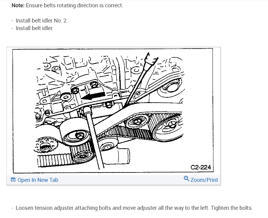

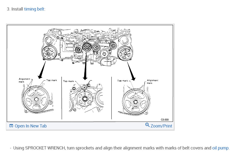

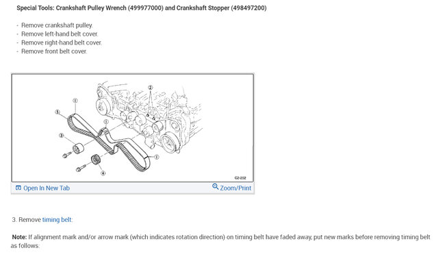

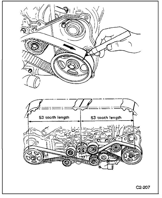

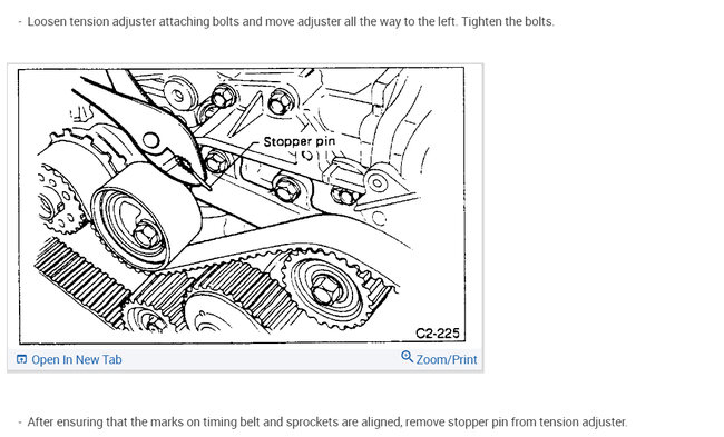

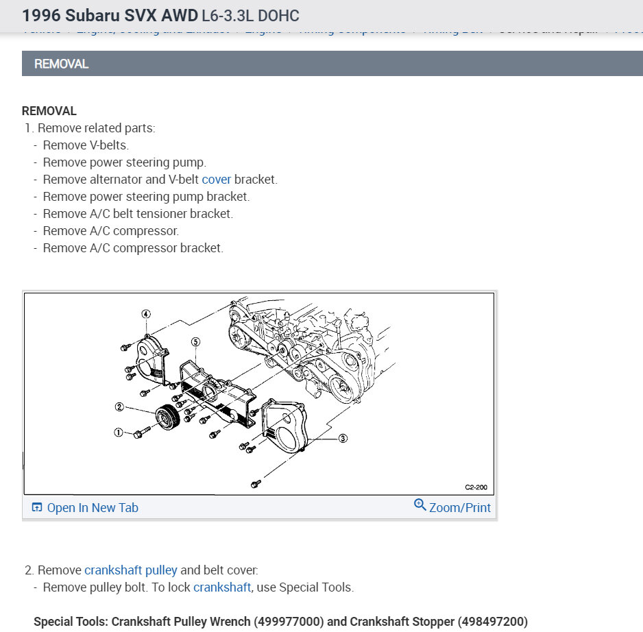

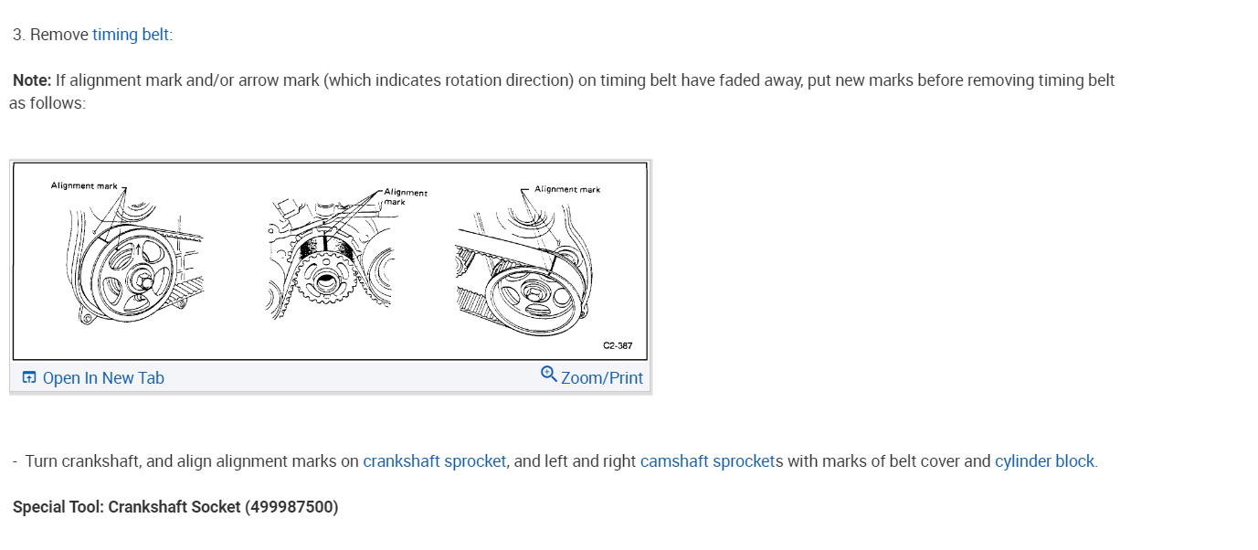

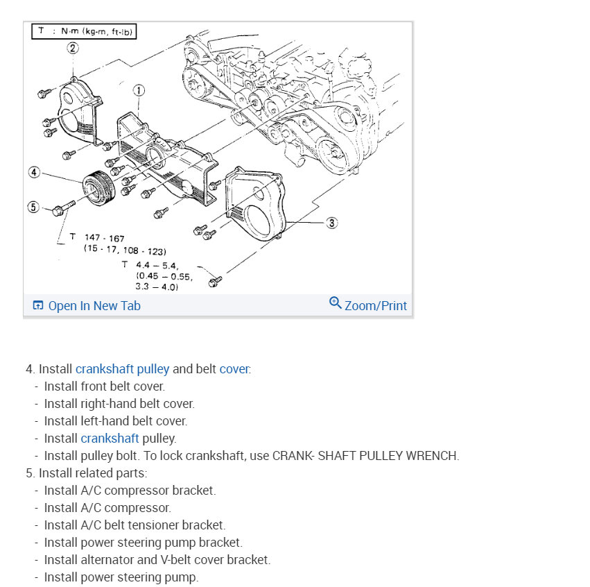

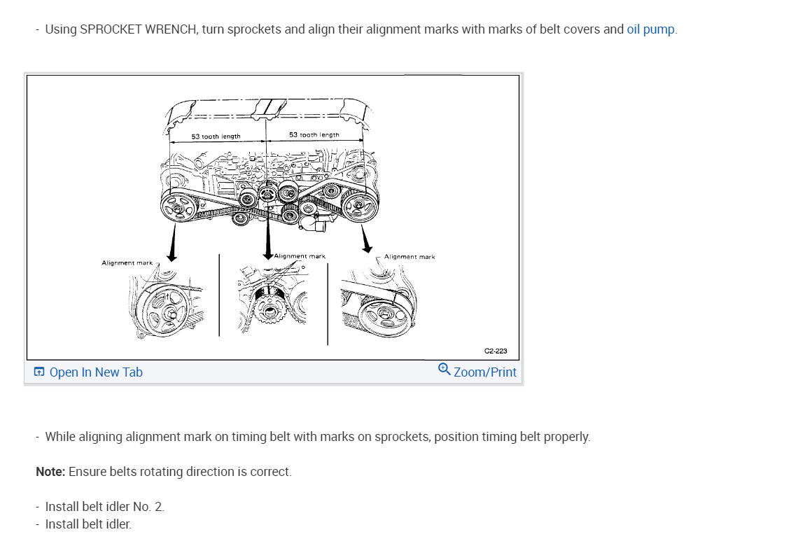

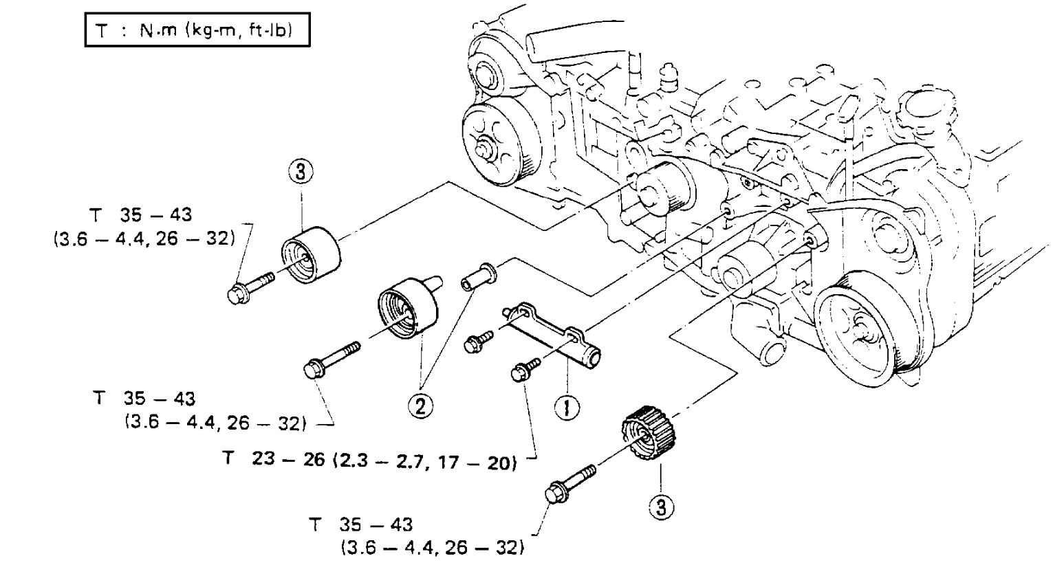

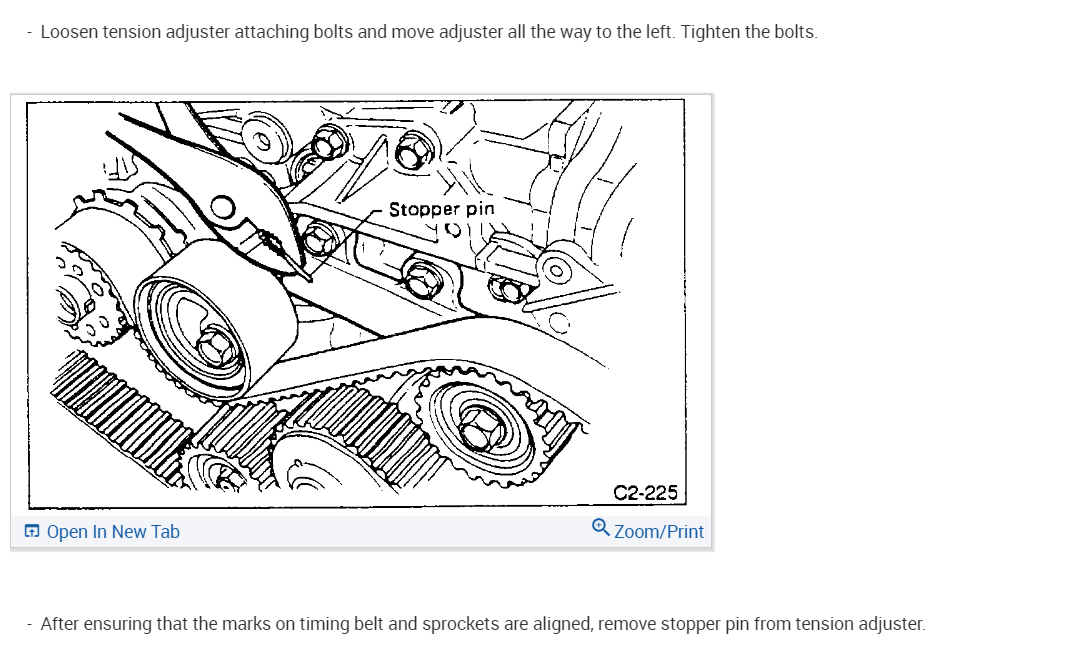

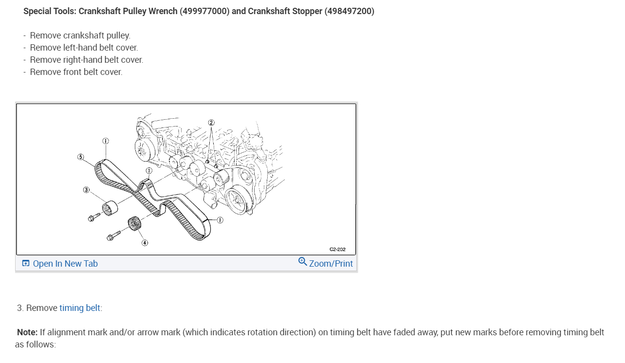

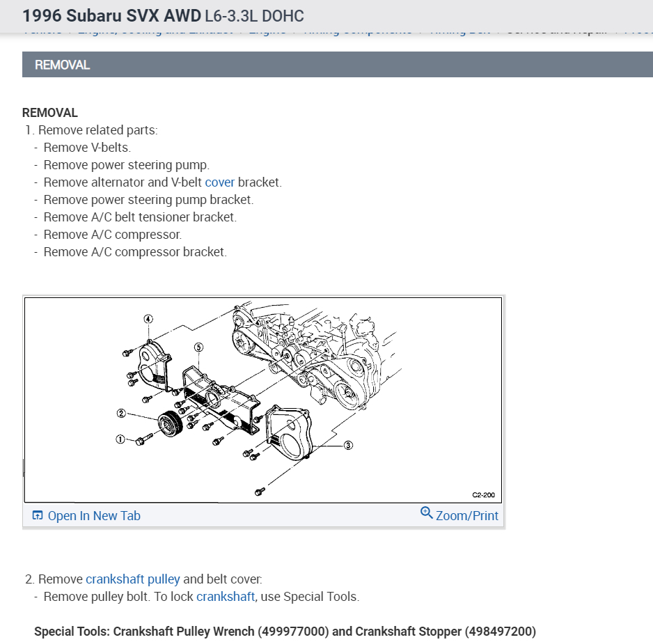

Thanks for the video. Yep, that is not right, I believe the timing belt is on incorrectly, here are the instructions to help you fix it. Check out the images (below). Please let us know if you need anything else to get the problem fixed.

After putting timing belt back together it started shaking engine badly and smoking under hood and popping noise from exhaust.
Jun 20, 2023 at 8:28 AM
  • 55,433 POSTS
It sounds like the belt is not installed correctly. On these engines there is a procedure, I don't think you can just put the marks on and put it together. If you are confident the timing belt is on correctly let's pull the spark plugs and do a compression test. Here is a guide that can help:
and
https://www.2carpros.com/articles/symptoms-of-low-compression
Please go over these guides and get back to us.
