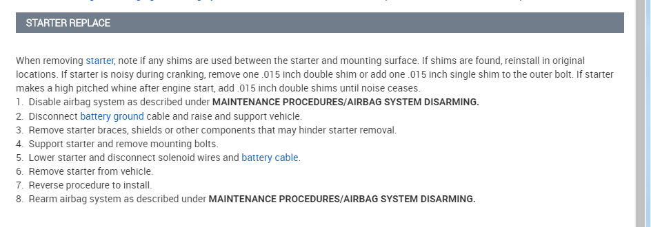

I am curious on how to replace the starter on my car and the tools i will need?
Jun 22, 2020 at 7:09 AM

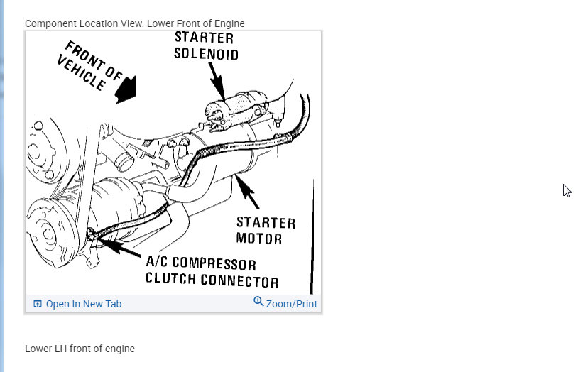

I attached the process from the manual. It is not detailed so I attached some other info that is more general that should help as well.
Let me know if you need more info and I will see what I can dig up. Thanks
