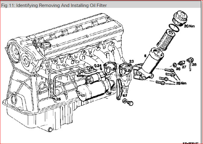

All the videos I have seen show a oil cooler attached to the oil filter housing. My car does not have a oil cooler. I am looking for instructions or a video on how to remove the oil filter housing. Any help would be greatly appreciated. Thanks guys

DANNY L
  • 5,648 POSTS
Hello, I am Danny.
I have attached a picture. Let me know if this is correct. Hope this helps and thanks for using 2CarPros.
Danny-
Oct 14, 2018 at 8:03 PM
DENNISFR

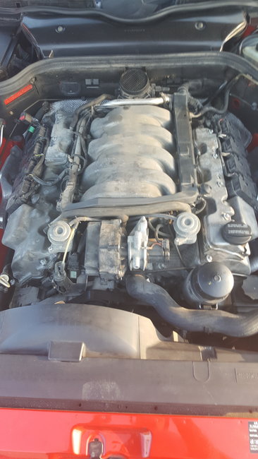

Hey Danny thanks for your help. But the picture you sent is the wrong picture.

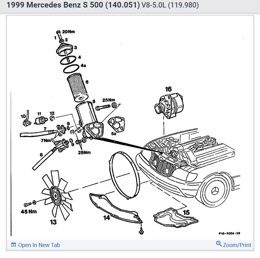

I believe I have told you the wrong engine. I have a 5.0 not a 5.. I am attaching some pictures. Hope this helps.
Oct 14, 2018 at 8:55 PM
  • 55,273 POSTS
Here are the instructions with a diagrams below:
- Remove engine compartment panel.
- Remove generator.
- Unplug plug connection (10) of oil pressure sensor (11).
- Unbolt oil pressure sensor (11) and remove with seal (12).
Tighten to: 15 Nm.
- Unbolt oil pipe (8) of air-oil cooler at oil sump.
- Unbolt oil lines (7) and (8) of air-to-oil cooler at oil filter (5).
Tighten to: 7 Nm.
- Replace seals (9).
- Unbolt oil filter (5) at crankcase.
Tighten to: 25 Nm.
- Remove oil filter (6) upward.
Installation Note: Clean sealing surfaces.
- Replace gasket (5a).
- Install in reverse sequence, observing tightening specifications and the installation note.
- Check oil level in engine, adjust to correct level.
- Run engine, check for leaks.
