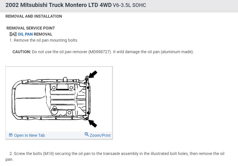

The seal is leaking.
Jul 17, 2022 at 10:50 AM
SQM
Experienced Mechanic
6,383 POSTS

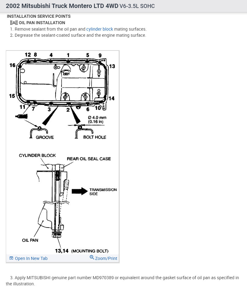

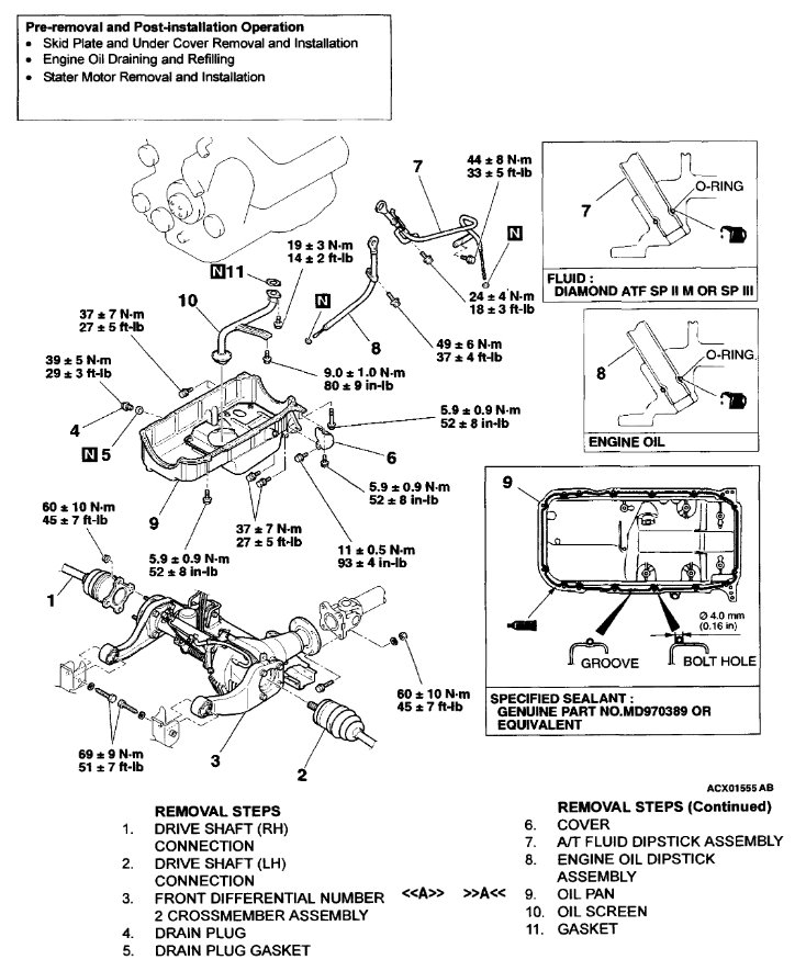

I have attached the oil pan/gasket replacement procedure below including all the torque specifications.
Let me know of any questions.
