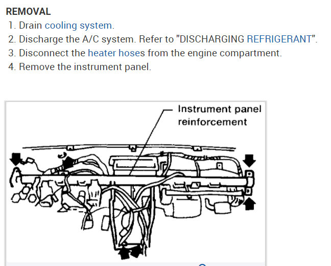

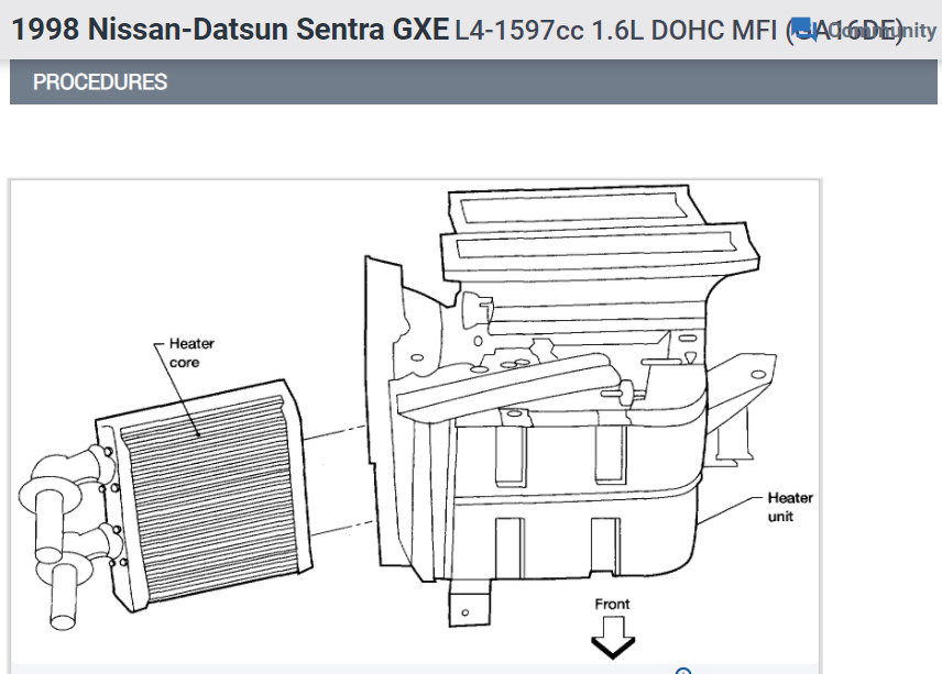

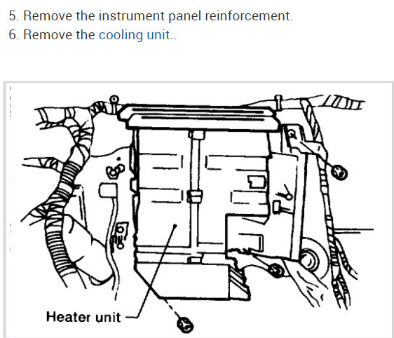

Hello, I'm Danny.
Here is a tutorial showing how to replace a heater core:
https://www.2carpros.com/articles/replace-heater-core
I've attached picture steps below for heater core replacement on your car. Hope this helps and thanks for using 2CarPros.
