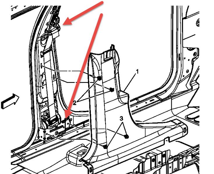

My seat belt retractors were never replaced after my vehicle was in a fender bender so I'm just trying to get a detailed description on how to remove and replace the front driver and passenger seat belt retractors on a 2011 Chevy Malibu.

if they weren't damaged then there should be nothing wrong with them you have to remove the center garnish molding first top and bottom then the retractors see pic.
