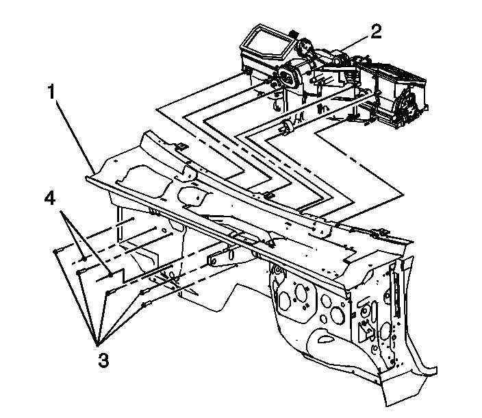

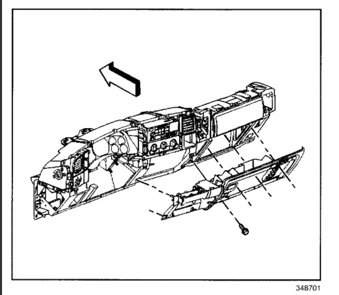

I have replaced the actuator as well as tried to fix the mount of the blend door, but each spring is broken and the door wont move for the third year in a row! How can I replace the entire enclosure so it will work like new?
May 20, 2019 at 9:21 AM
  • 110,244 POSTS
Welcome to 2CarPros.
Here are the directions for replacing the HVAC module. The attached pictures correlate with the directions.
HVAC MODULE ASSEMBLY REPLACEMENT
Air Conditioning and Heater Module Assembly Removal and Installation
Tools Required
- J 43181 Quick Connect Connector Removal Tool
Removal Procedure

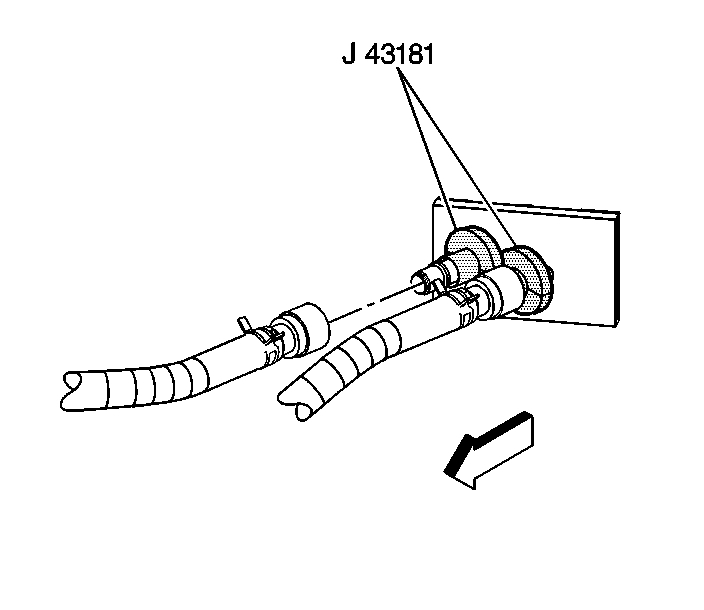

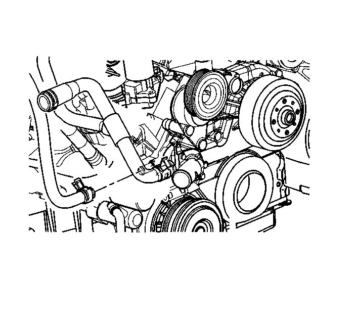

1. Drain the engine coolant.
picture 1
2. Using the J 43181 disconnect the inlet heater hose from the heater core.
2.1.Install the J 43181 to the heater core pipe.
2.2.Close the tool around the heater core pipe.
2.3.Firmly pull the tool into the quick connect end of the heater hose.
2.4.Firmly grasp the heater hose. Pull the heater hose forward in order to disen(gauge) the inlet hose from the heater core.
3. Using the J 43181 disconnect the surge tank outlet hose from the heater core.
3.1.Install the J 43181 to the heater core pipe.
3.2.Close the tool around the heater core pipe.
3.3.Firmly pull the tool into the quick connect end of the heater hose.
3.4.Firmly grasp the heater hose. Pull the heater hose forward in order to disen(gauge) the surge tank outlet hose from the heater core.

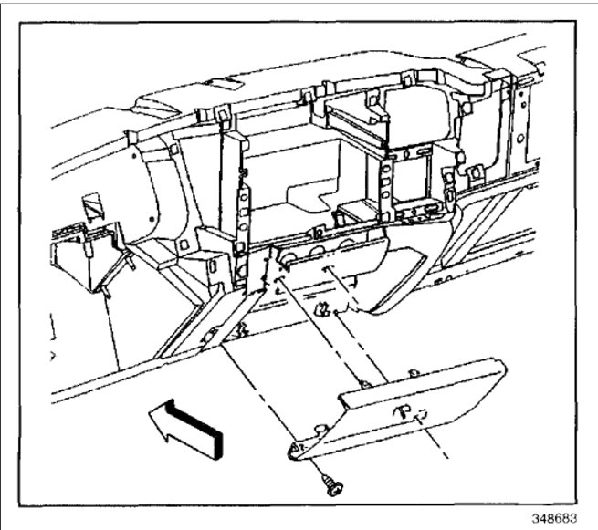

4. Remove the accumulator.
5. Remove the instrument panel carrier. See: Dashboard / Instrument Panel > Removal and Replacement

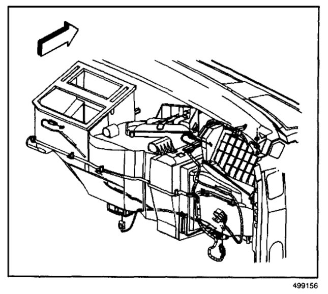

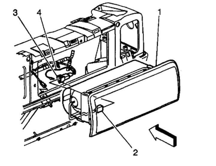

6. Remove the HVAC module drain hose.
7. Disconnect the electrical harnesses and the ground connections from the HVAC module.

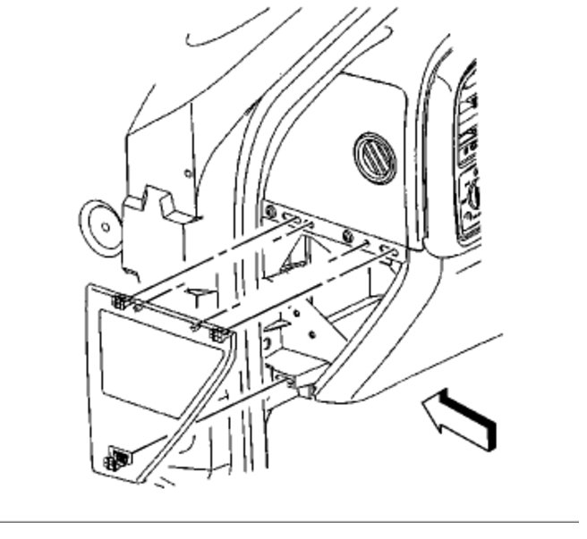

picture 2

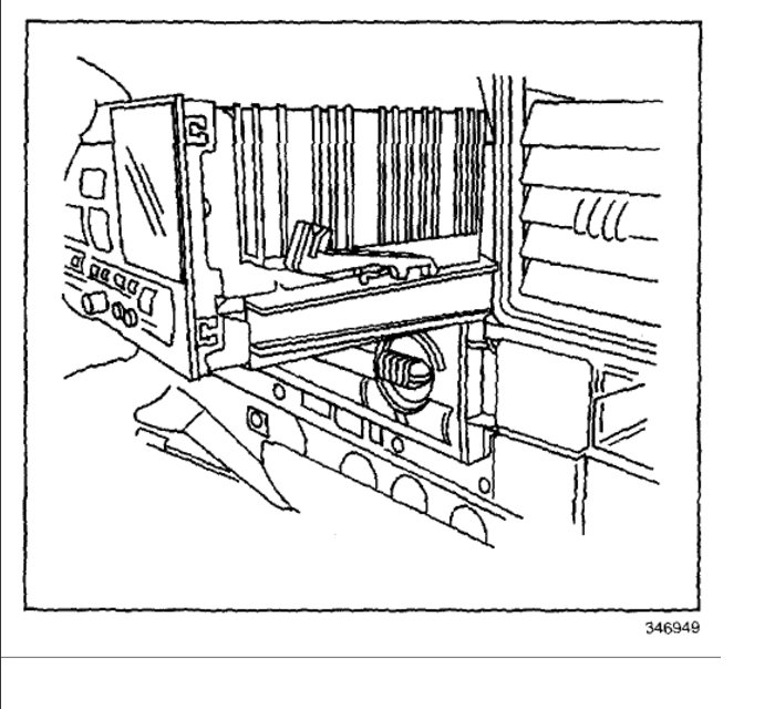

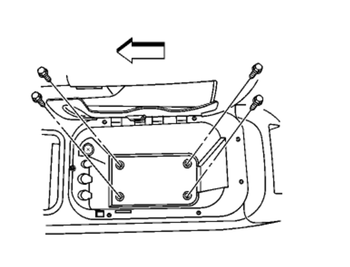

8. Remove the nuts (4) from the HVAC module (2).
9. Remove the bolts (3) from the HVAC module (2).
10. Remove the HVAC module (2) from the vehicle (1).

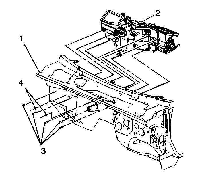

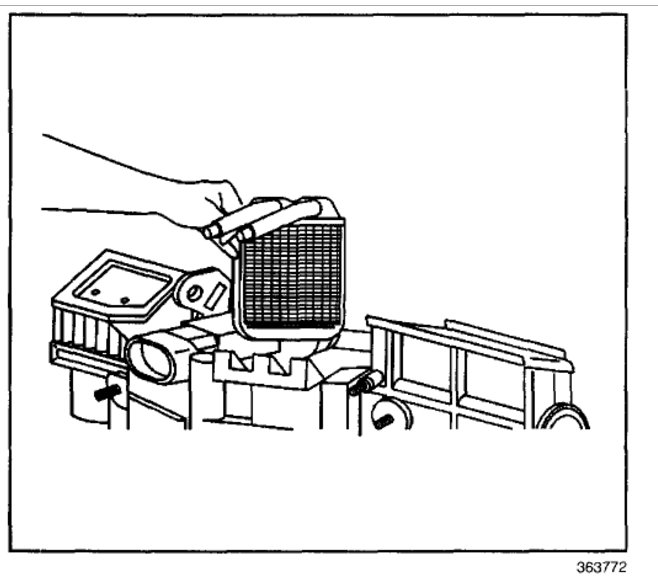

Installation Procedure

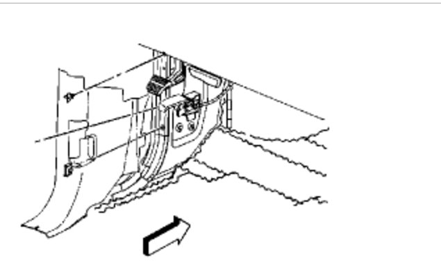

picture 3
1. If replacing the HVAC module, transfer the components from the old HVAC module as necessary.
2. Install the HVAC module (2) to the vehicle (1).
Notice: Use the correct fastener in the correct location. Replacement fasteners must be the correct part number for that application. Fasteners requiring replacement or fasteners requiring the use of thread locking compound or sealant are identified in the service procedure. Do not use paints, lubricants, or corrosion inhibitors on fasteners or fastener joint surfaces unless specified. These coatings affect fastener torque and joint clamping force and may damage the fastener. Use the correct tightening sequence and specifications when installing fasteners in order to avoid damage to parts and systems.
3. Install the nuts (4) to the HVAC module (2).
Tighten
Tighten the nuts to 9 Nm (80 lb in).
4. Install the bolts (4) to the HVAC module (2).
Tighten
Tighten the bolts to 4 Nm (35 lb in).

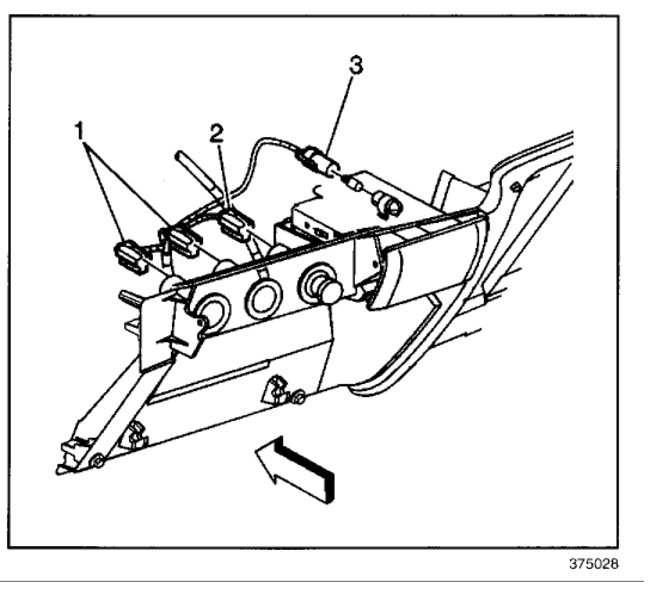

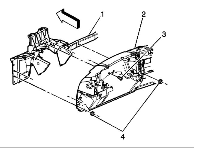

5. Connect the electrical harnesses and the ground connections.
6. Install the HVAC module drain hose.
7. Install the instrument panel carrier.
8. Install the accumulator.

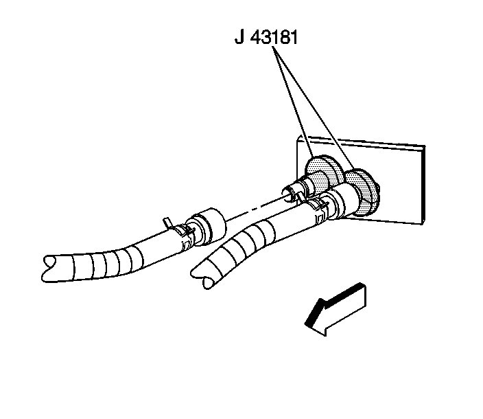

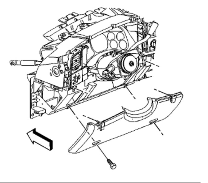

picture 4
9. Install the surge tank outlet hose to the heater core.
- Firmly push the quick connect onto the heater core pipe until you hear an audible click.
10. Install the inlet heater hose to the heater core.
11. Fill the engine coolant.

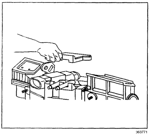

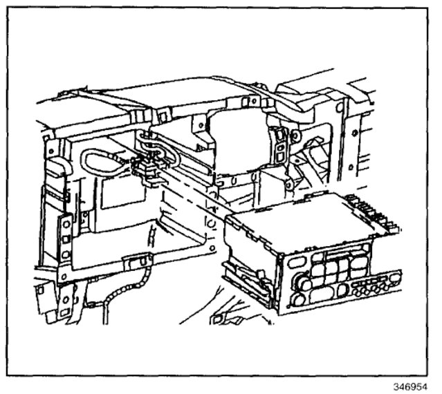

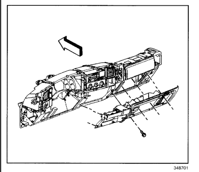

Hello I just encountered the same issue, did you find a resolution to your problem? I'm trying to find a way to replace it as well without taking the dash off!
May 23, 2019 at 12:20 PM (Merged)
  • 55,433 POSTS

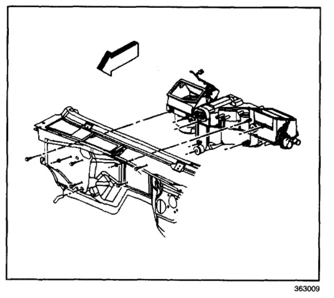

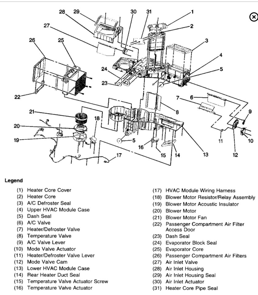

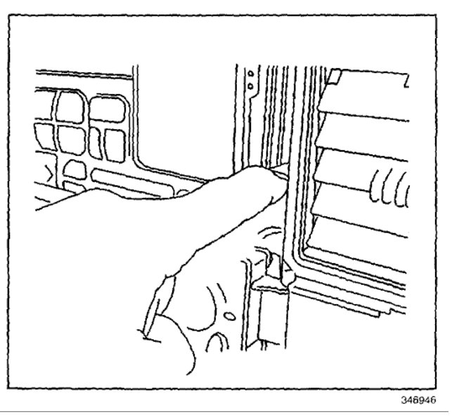

Sorry the dash must come out and the heater plenum to fix the blend door. Here are diagrams to help you get started. Disconnect the battery and vacuum down the AC to be recharged when complete.
