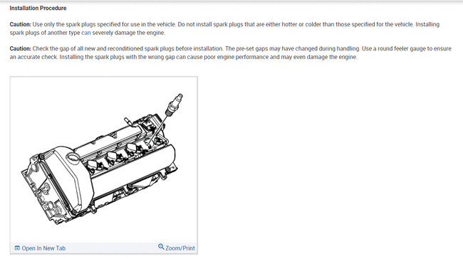

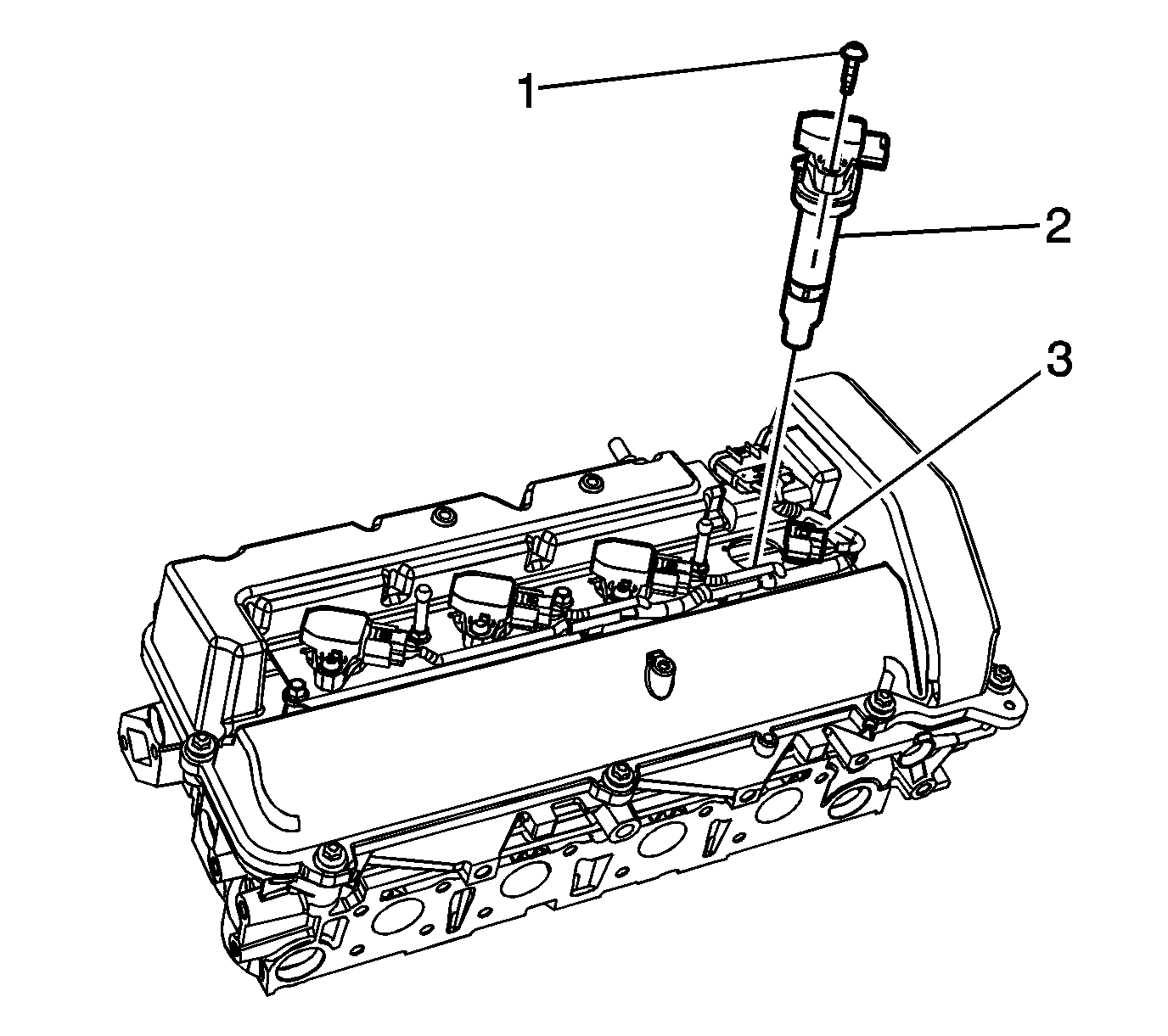

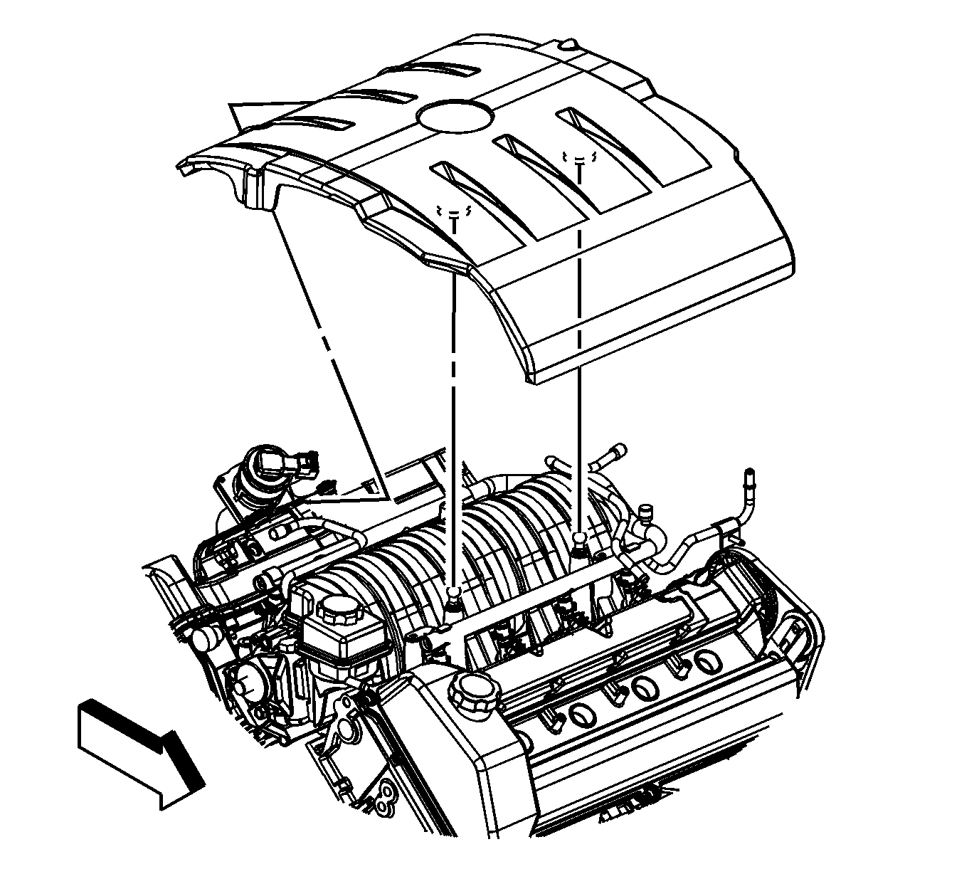

Car listed above is a DTS Platinum Edition. I need to know how to replace the spark plugs. Are there any special tools needed? How much time does it take?
May 26, 2021 at 8:18 PM
  • 110,194 POSTS

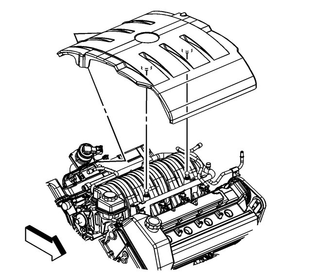

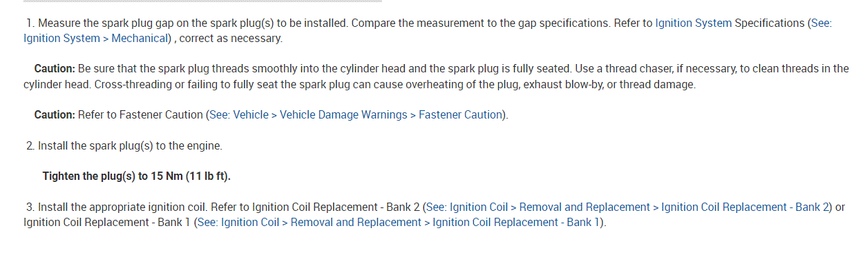

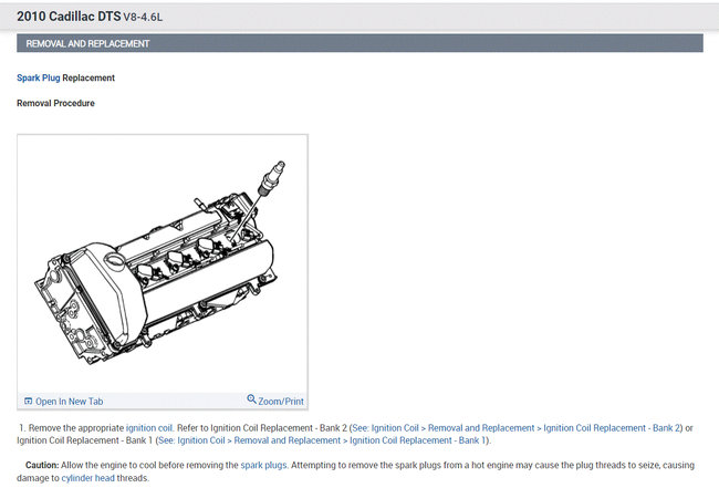

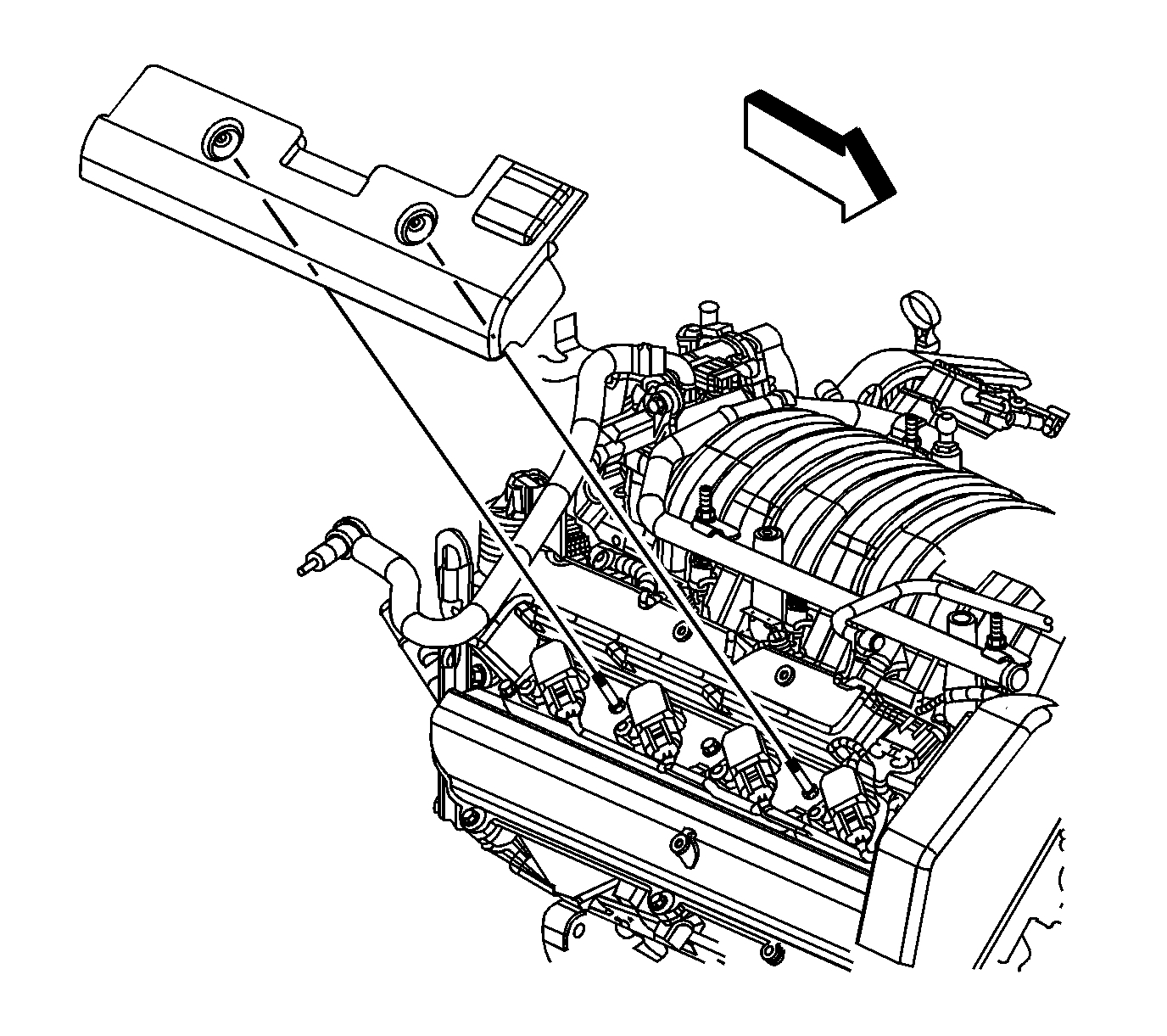

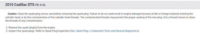

The only special tool you will need is a spark plug socket and extension. The spark plugs are recessed in the valve covers. You will need to remove the coil packs to access the plugs. Only do one at a time so nothing gets mixed up.
To get you started, here is a link that explains the procedure in general. It will be a great guide for you when working on your vehicle.
https://www.2carpros.com/articles/how-to-change-spark-plugs
If you look below, I provided the directions specific to your vehicle for replacement. The last three pics below show two covers that need removed (they are clipped on) and then the one bolt to remove the coil.
