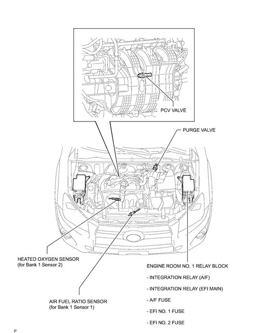

I want to replace the oxygen sensor in bank 1,sensor 2 for vehicle listed above limited model. Could you tell me where is location bank 1, sensor 2? It is better with picture.
Thanks,
Lee
Oct 19, 2018 at 8:16 PM
  • 110,194 POSTS
On engines that are V type (V6 or V8) they have a bank 1 and bank 2. Since your vehicle is a four cylinder, there is no concern because there is only one bank.
The sensor you indicated is a heated oxygen sensor. It is located on the front exhaust pipe. When you open the hood, it will be on the engine side that is facing you. I attached a picture of its location for you.

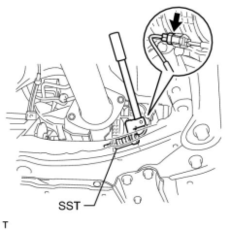

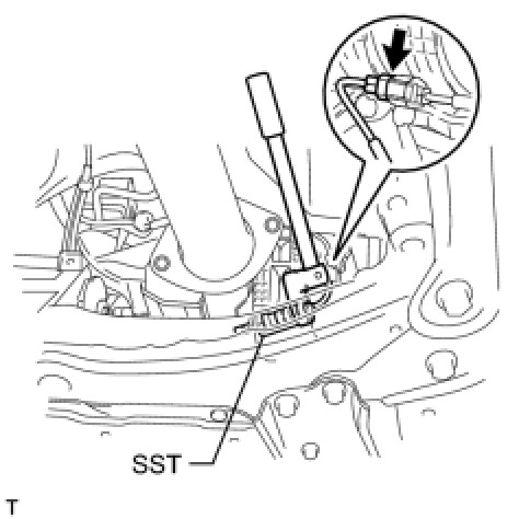

Here are the specific directions for removal. Picture 2 correlates with removal.
2AR-FE ENGINE CONTROL SYSTEM: HEATED OXYGEN SENSOR: REMOVAL
REMOVAL
1. REMOVE HEATED OXYGEN SENSOR (for Bank 1 Sensor 2)
(a)Disconnect the sensor connector.
(b)Using SST, remove the sensor from the front exhaust pipe.
SST: 09224-00010
____________________________
1. INSTALL HEATED OXYGEN SENSOR (for Bank 1 Sensor 2)
(a)Using SST, install the sensor to the front exhaust pipe.
SST: 09224-00010
without SST - Torque: 44 Nm (449 kgf-cm, 32 ft-lbf)
with SST - Torque: 40 Nm (408 kgf-cm, 30 ft-lbf)
HINT:
- Use a torque wrench with a fulcrum length of 300 mm (11.8 in.).
- Make sure SST and wrench are connected in a straight line.
(b)Connect the sensor connector.
2. INSPECT FOR EXHAUST GAS LEAK
