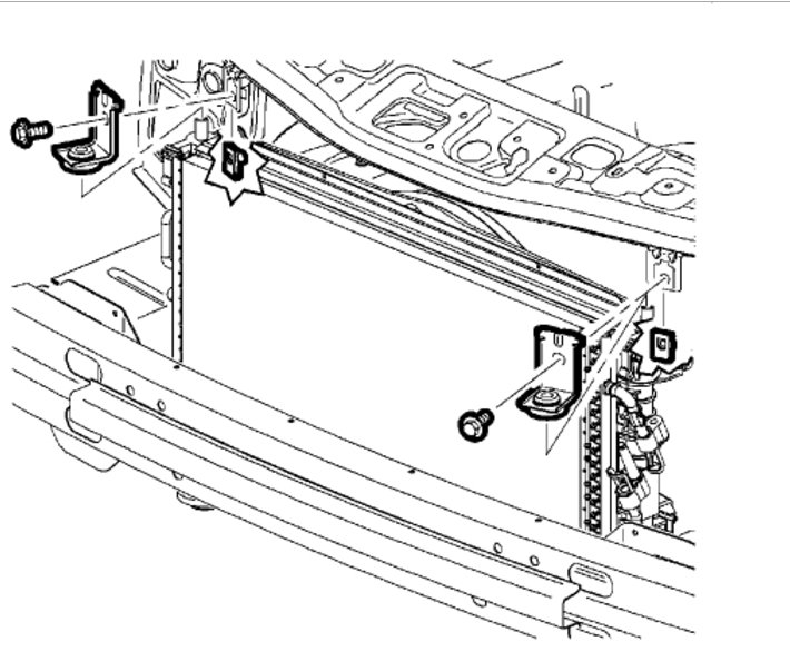

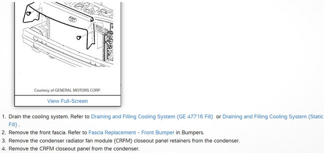

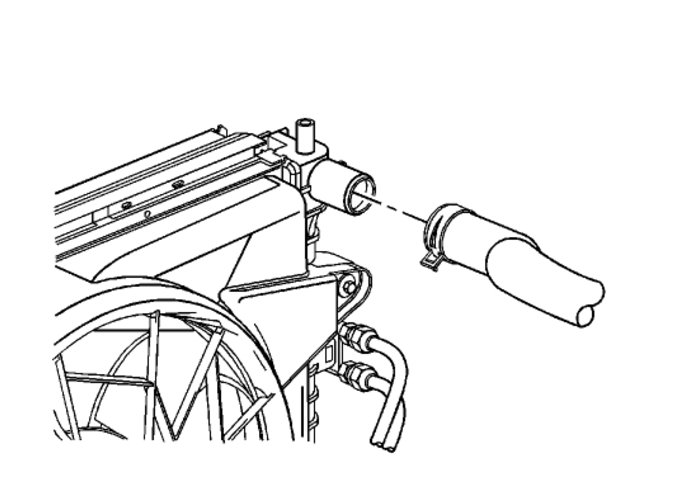

I need to replace the radiator 2006 saturn vue 3.5 V6. I need help :)
Jan 17, 2016 at 5:33 AM
WRENCHTECH
  • 20,761 POSTS

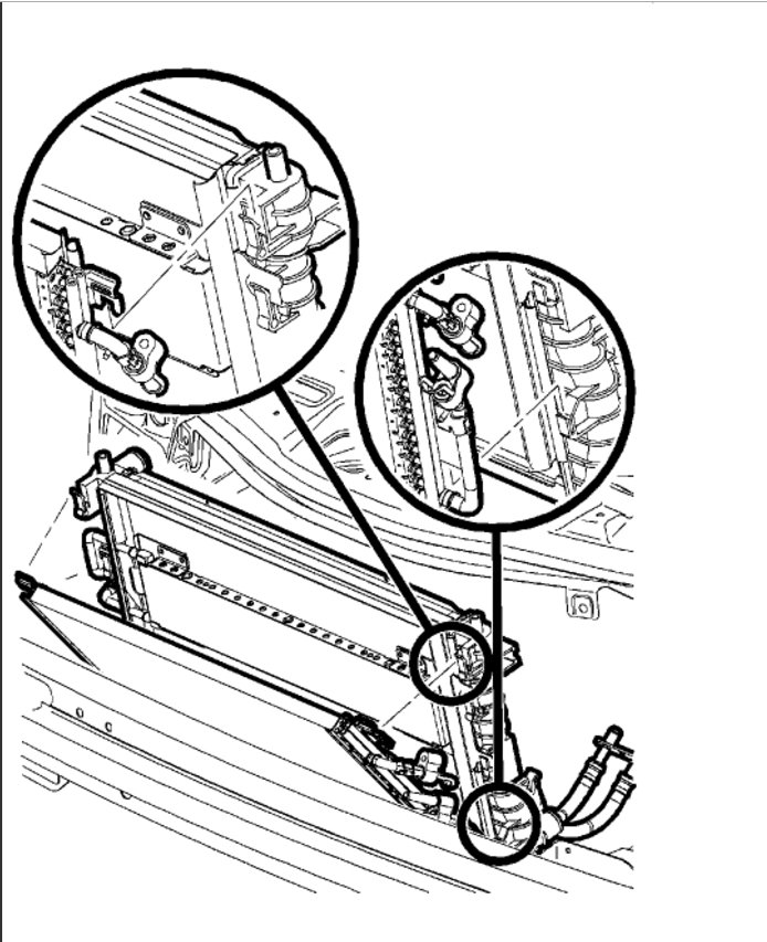

Here is a guide that show what you need to do when doing the job. It looks like the AC may need to be drained down and recharged if you cant sneak it out of there.
Here is a guide that will give you an idea for what you are in for when doing the job.
and
https://www.2carpros.com/articles/how-to-replace-a-car-radiator
Here is a video as well.
https://youtu.be/KxarBcVj1Yg

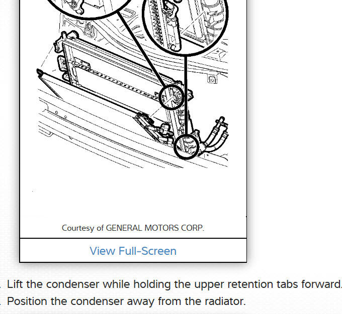

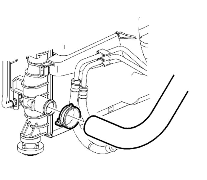

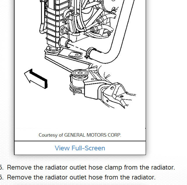

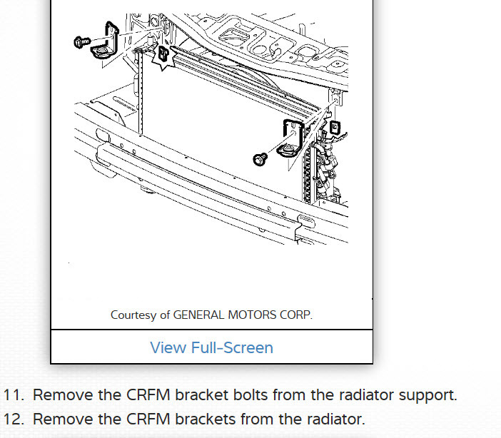

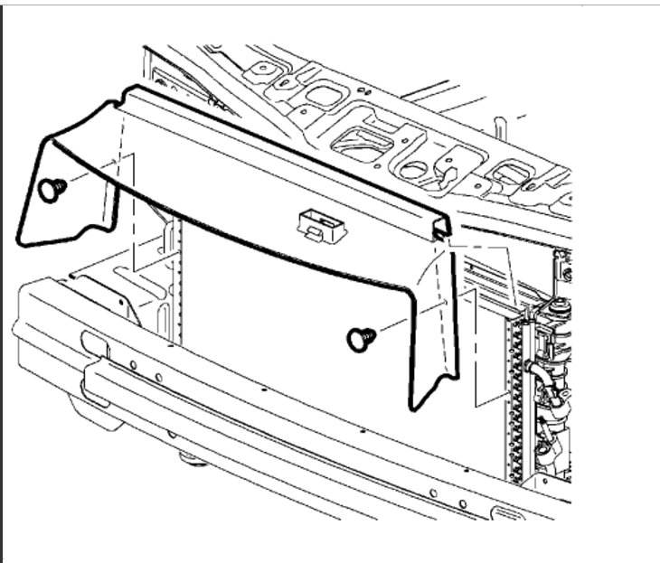

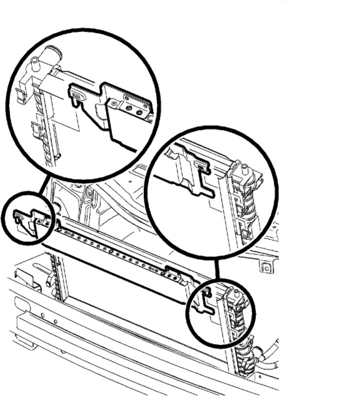

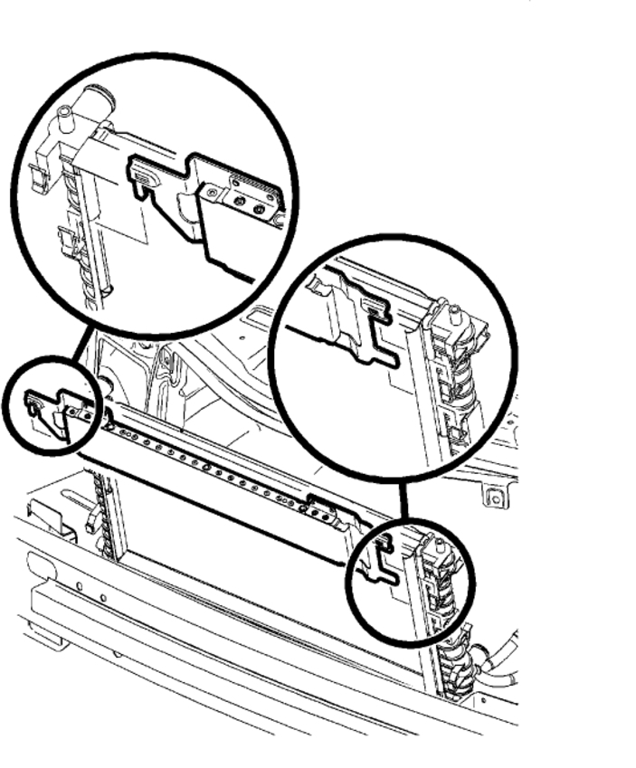

Here are the step by step instructions with diagrams (Below)

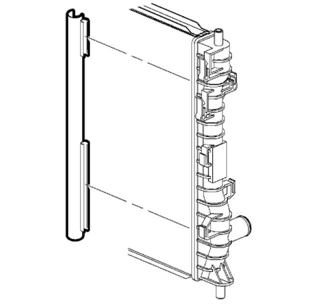

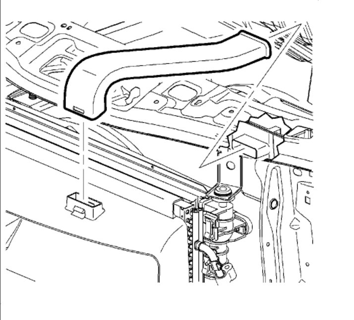

Drain the cooling system. Remove the front fascia. Remove the condenser radiator fan module (CRFM) closeout panel retainers from the condenser. Remove the CRFM closeout panel from the condenser.

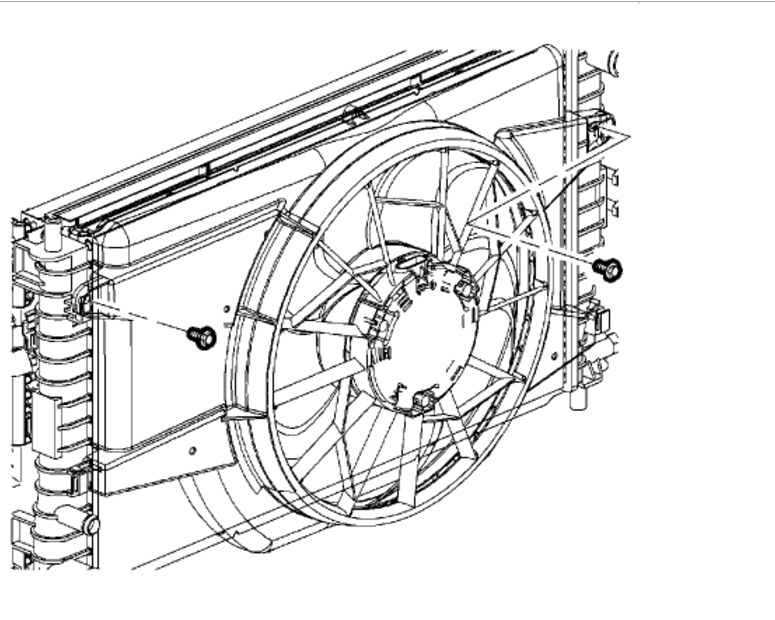

Remove the fan assembly bolts from the radiator. Lift the fan assembly to disengage the lower retention tabs. Position the fan assembly away from the radiator.
Lift the condenser while holding the upper retention tabs forward. Position the condenser away from the radiator.

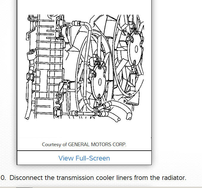

Disconnect the transmission cooler liners from the radiator.Remove the CRFM bracket bolts from the radiator support. Remove the CRFM brackets from the radiator.

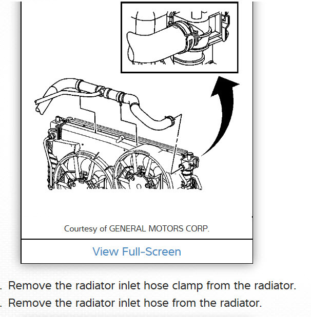

Remove the radiator inlet hose clamp from the radiator. Remove the radiator inlet hose from the radiator. Remove the radiator outlet hose clamp from the radiator. Remove the radiator outlet hose from the radiator.

see pics there are two seals to remove from radiator once it's out.
