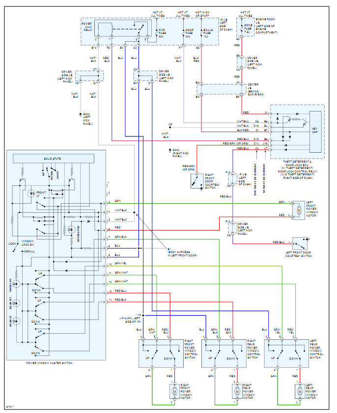

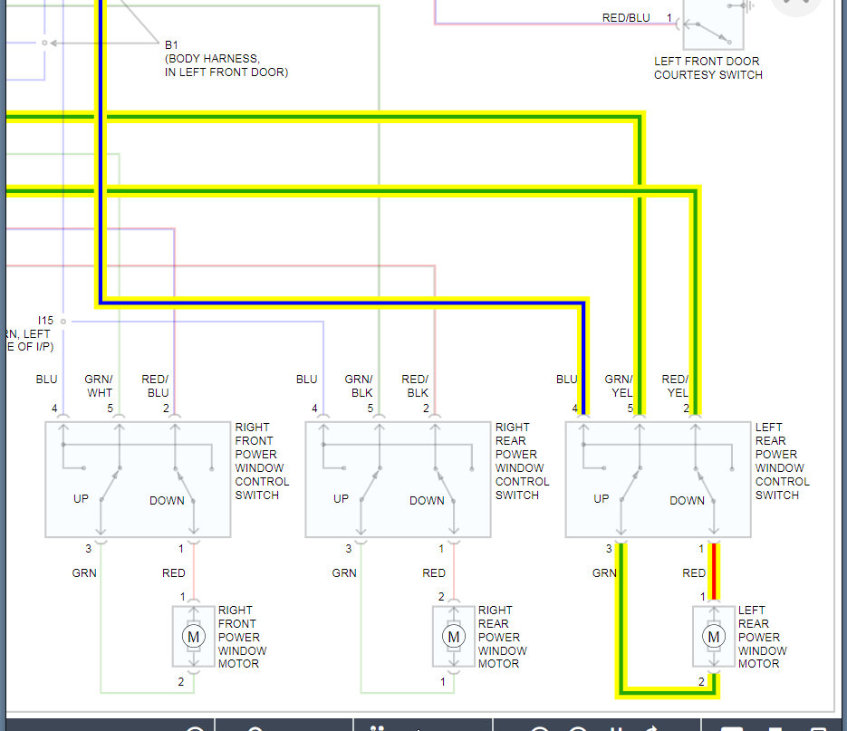

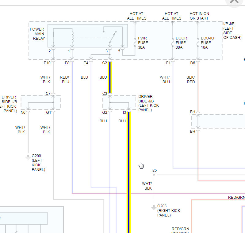

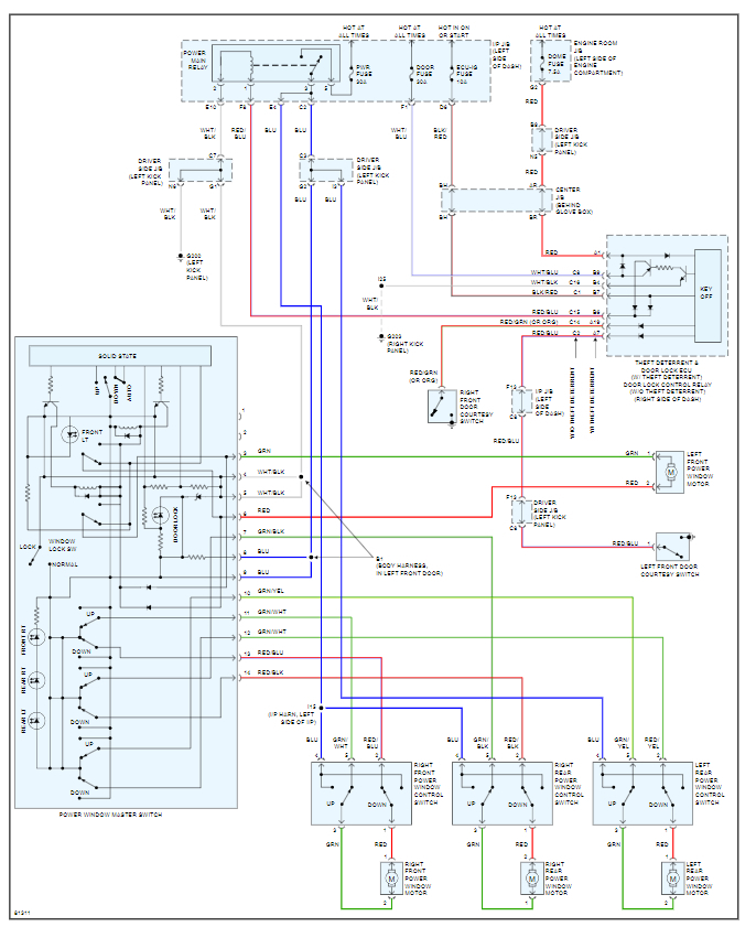

Thank you for your explanation. Can you please provide a wiring diagram for the power window system?
Thank you!
Aug 1, 2020 at 5:57 AM

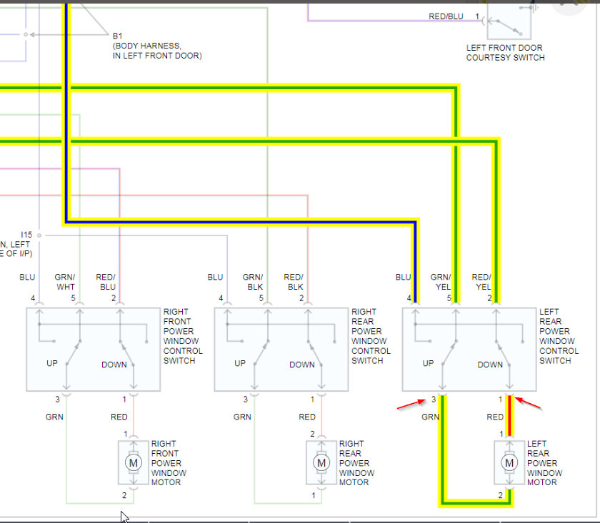

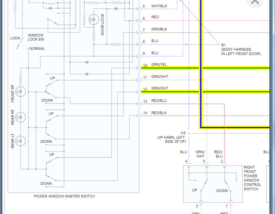

You are welcome. I attached the entire diagram and then close ups for this specific portion.
Aug 2, 2020 at 11:18 AM
AVALON1995
  • 121 POSTS

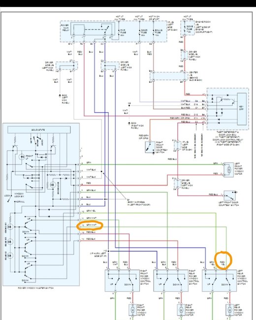

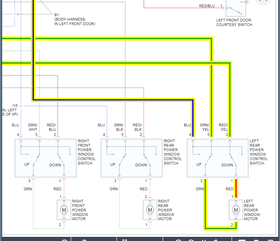

Thank you for providing the diagrams. Correct me if I'm wrong, but isn't there an error on the diagram? Please take a look at what I circled in orange in the attached picture.
Cheers!
Aug 2, 2020 at 6:38 PM

Yes. You are correct that the wiring color labels appear to be wrong. That happens every once in a while. Good catch.
You should be able to use the test light method if you are jumping power to the correct terminals.
Looks like you need to be touching power to pins 1 or 3 to get the motor to change direction. The motor doesn't care where it is getting the power from as long as it has power to one side and a path to ground on the other side. My guess is, you are removing the connector and applying power to one of these pins but due to the connector being unhooked, it doesn't have a path to ground. So you need to ground the other pin that you are not using. Meaning put power on pin 1 and a path to ground on pin 3 and then switch them to get it to go the other way.
Aug 3, 2020 at 12:05 PM

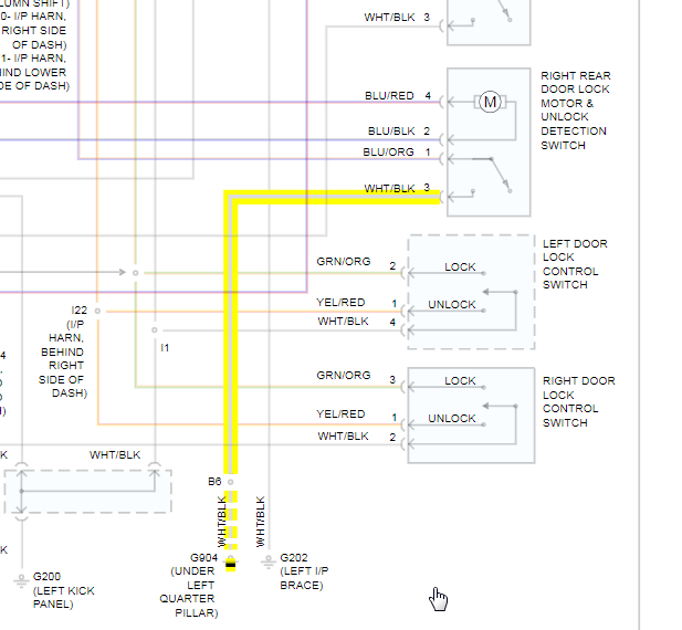

So, for my power door lock, it needs just power and no ground. On the other hand, for my power window, it needs both power and ground. Is that correct?
Thanks!
Cheers!
Aug 4, 2020 at 12:10 PM

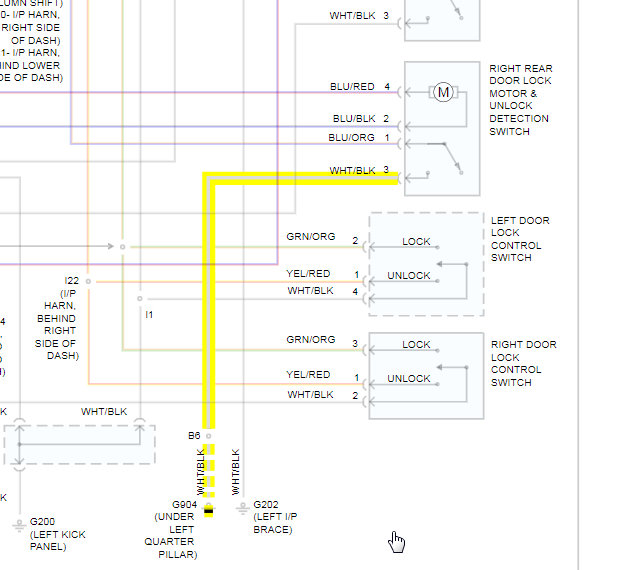

That is correct. Look at the difference between this wiring diagram for the door lock and the one I attached previously for the window motor. You will see that the door lock motor has its own ground. So if you apply power to this it will operate on whichever pin you put the power too because it has a path to ground.
The window motor comes from the switch and returns to the switch and it does not have its own ground so you have to supply the ground if you disconnect the switch to test it.
Remember you need power and a path to ground in order to operate the motor. If you have no path to ground then it is an open circuit. Does that make sense?
