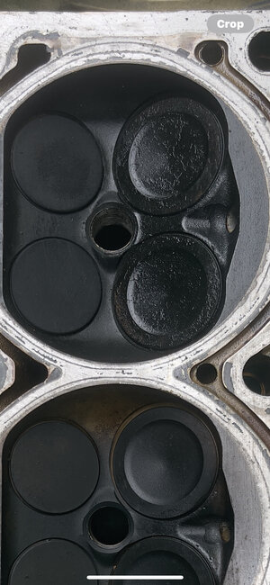

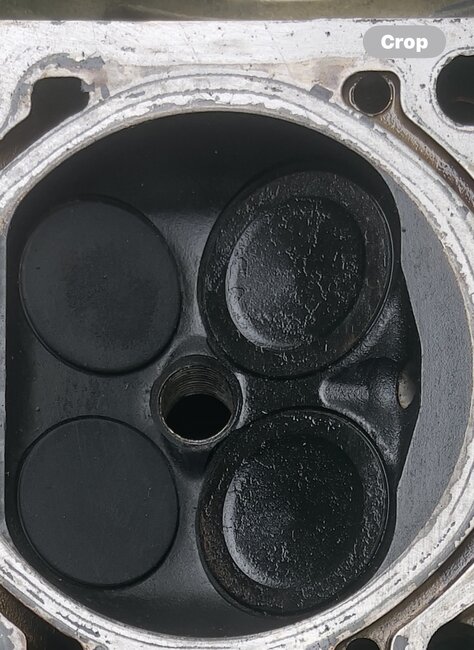

One last question for now. Please advise me on this valves on the head cylinder, I got two which looks a little bit oily. Let me upload the image.

I noticed it looking that way when I took out the top, but I have turn the camshafts to inspect its opening and closing, it opens well and closing needly.I am truly not a professional mechanic, but I am a professional in cars electronics and electrical, maybe about 60% in mechanics, but I am a fast learner.

I would just clean them up. That could be oil or coolant hard to tell which. But if you go through the heads and refresh them it shouldn't be an issue when you put the engine back together.
