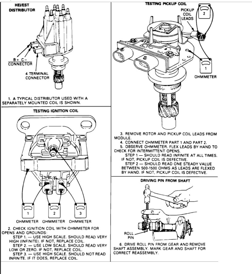

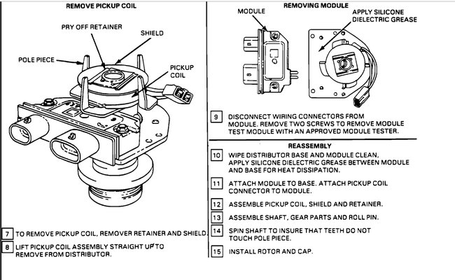

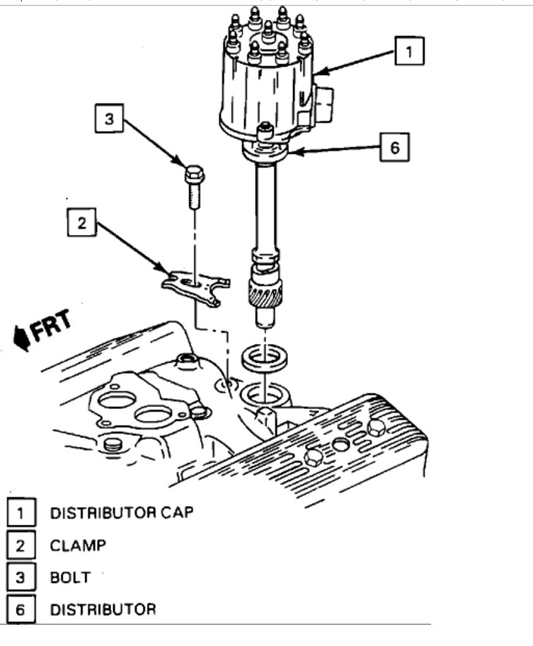

how to replace pickup coil?
Aug 19, 2017 at 8:50 AM
  • 55,711 POSTS
You need to mark the distributor in relationship to the rotor and cap. When you take it out it will go back in slightly off. just move the distributor housing to match the rotor and cap.
You will need a vise as well.
Here are some diagrams to show you how to do it (below):
