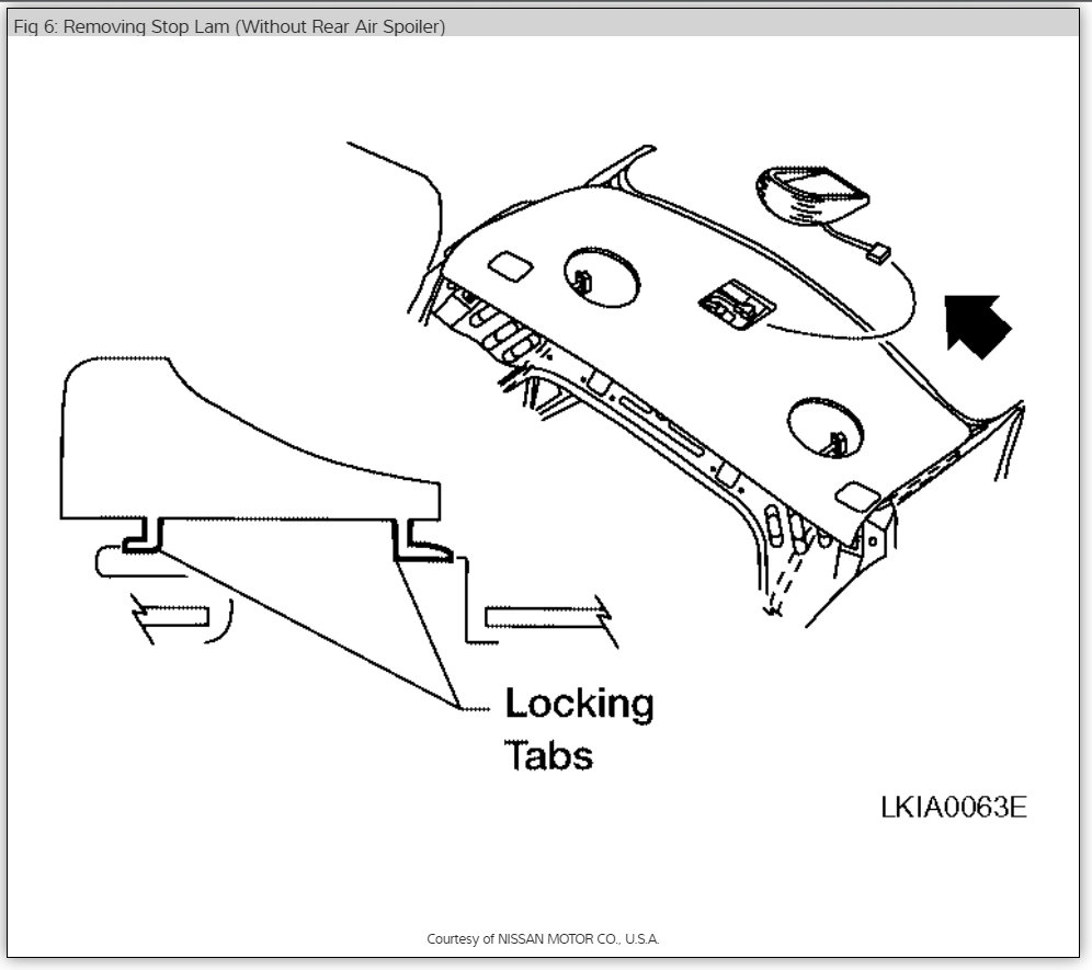

I want to replace the middle brake light from my 2006 Bluebird Sylphy but I don't know how to remove it. Can anybody give me the right instructions? Thanks in advance.

The bulb is serviced from inside the car by removing the unit from the hat panel. Here is a diagram to help you see whats going on (below)
https://www.2carpros.com/articles/brake-lights-not-working
This guide will give you an of what to do once the housing has been removed.
