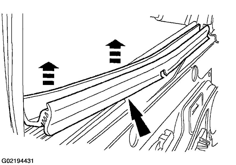

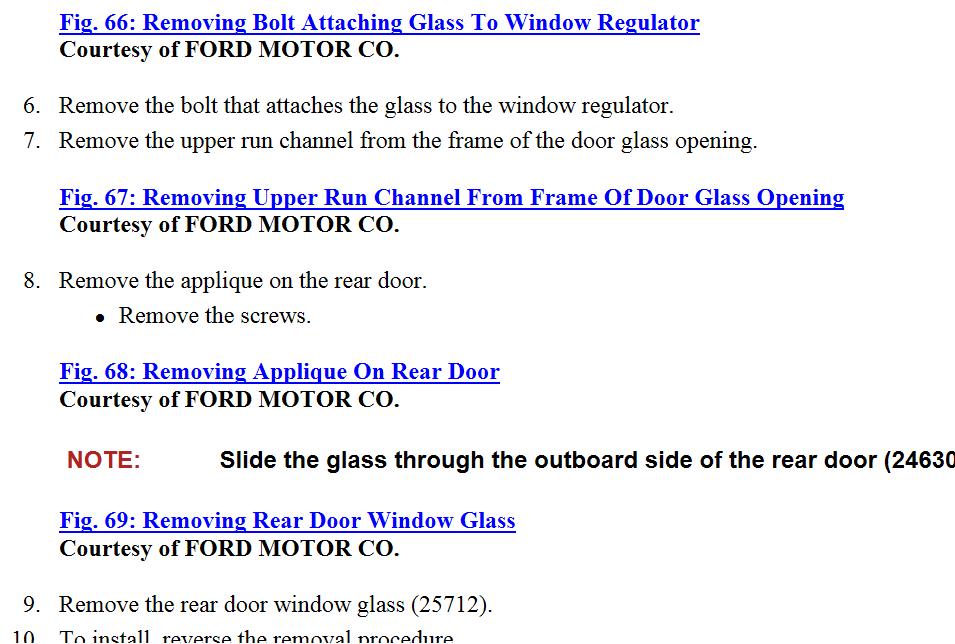

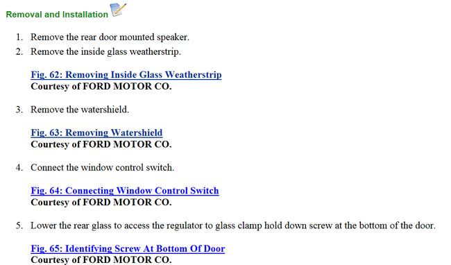

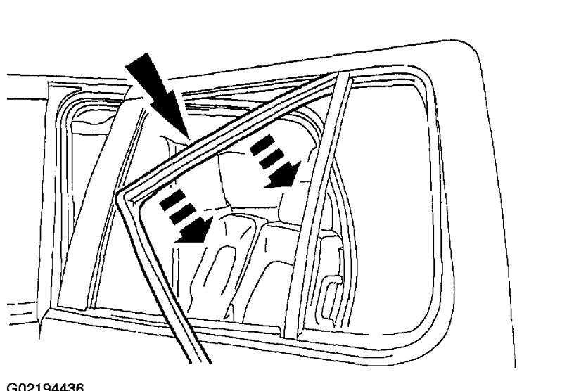

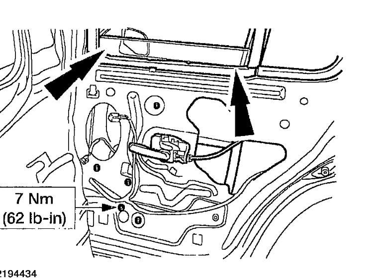

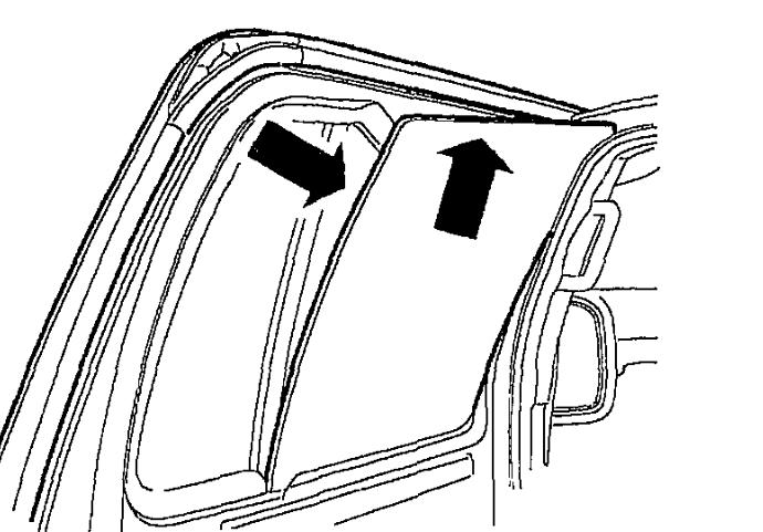

how to replace left rear door window and regulator....
Sep 1, 2014 at 8:14 AM
HMAC300
Experienced Mechanic
48,601 POSTS
see pics part of this you'll have to do with out pics or figure out yourself.
Images (Click to enlarge)
