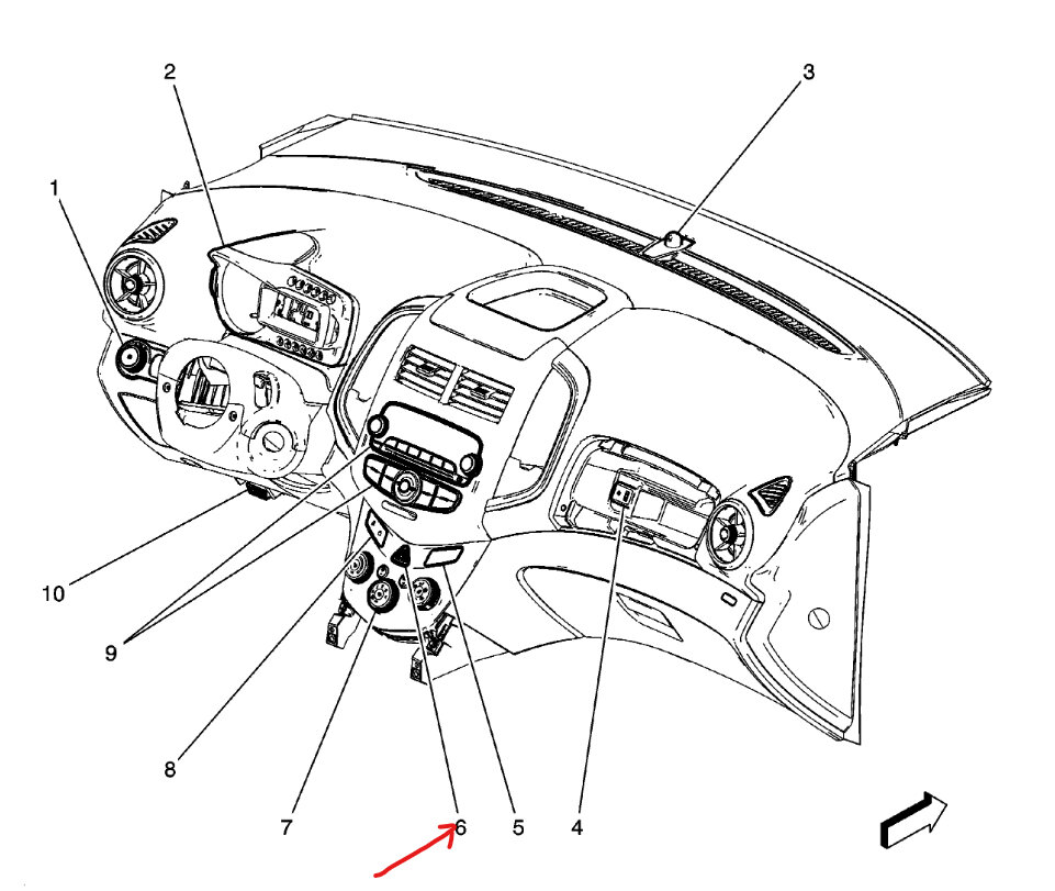

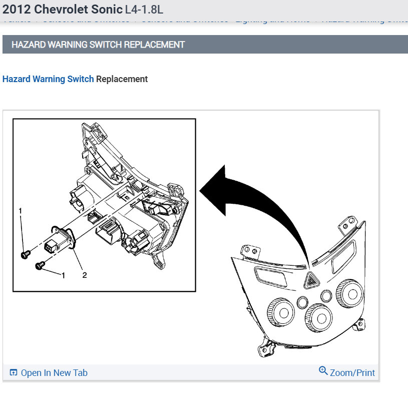

Hello.
The hazard light switch is not activating the indicator lights when pressed.
It was this way when the car was purchased second hand.
The is also no noticeable damage to the existing switch or the area around it.
Aug 27, 2023 at 11:13 PM
  • 55,433 POSTS

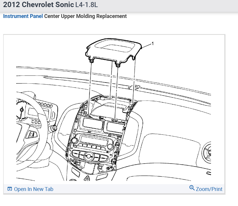

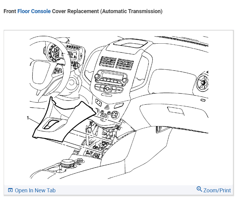

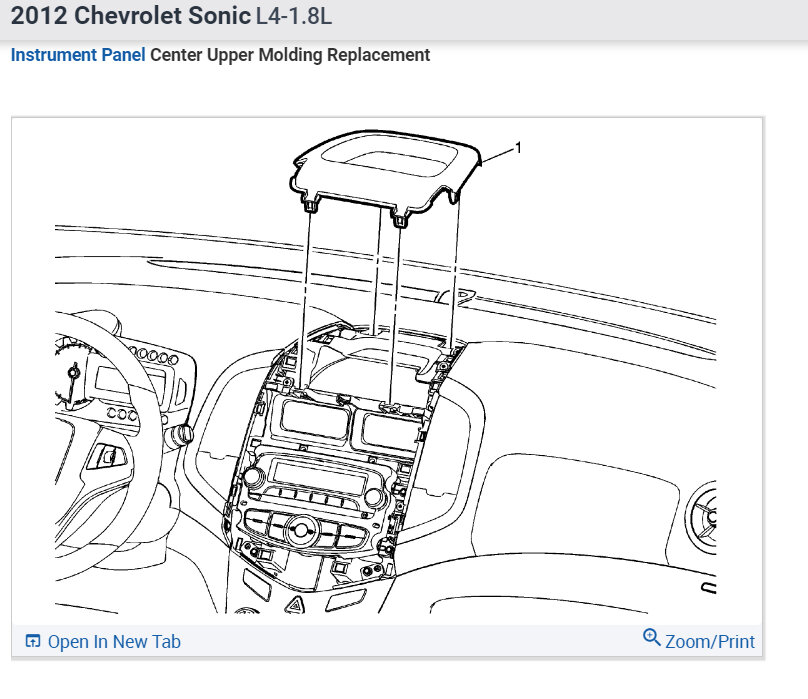

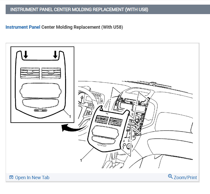

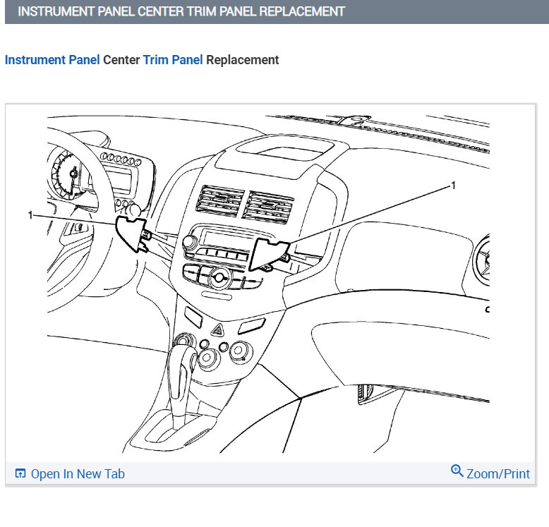

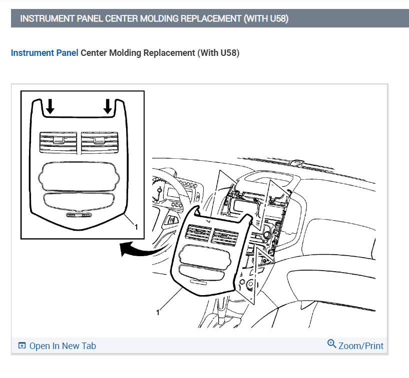

You will need to remove a couple of panels first, here is how to change the hazard switch out. Check out the images (below). Please let us know if you need anything else to get the problem fixed.
