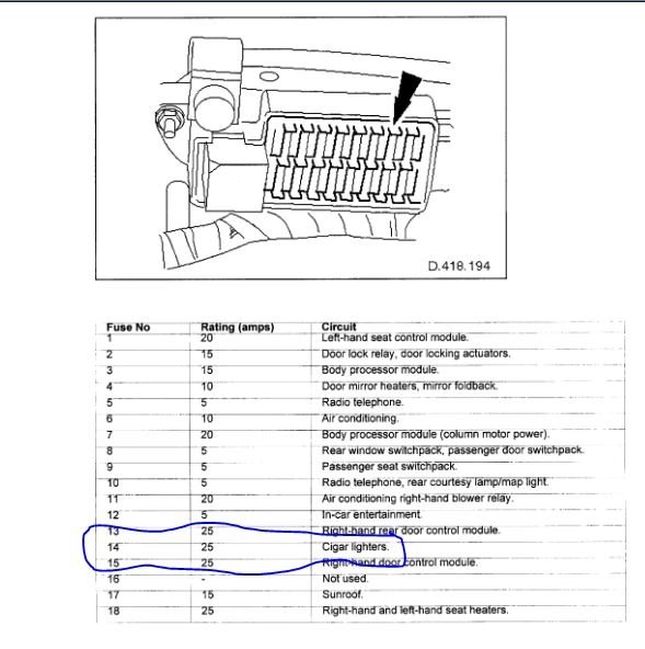

Can I replace this myself, or is it replaced only by the dealer? Is there a do-it-yourself video for this? Also, where do I but the fuse?

Good morning,
According to the wiring diagram for your car, the fuse box at the lower right side kick panel contains the fuse for the lighter. I attached a picture for you and circled the fuse number.
