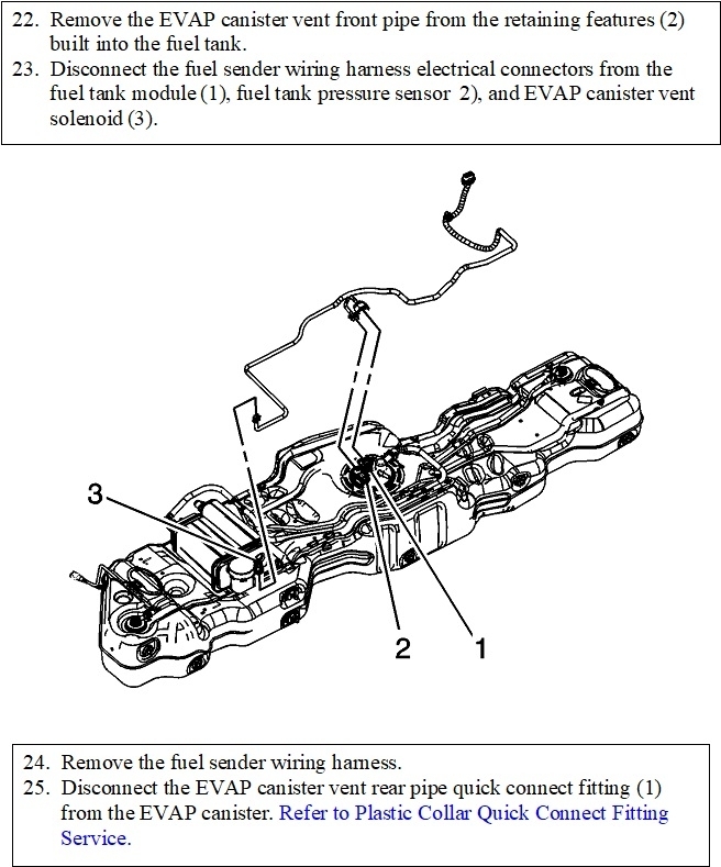

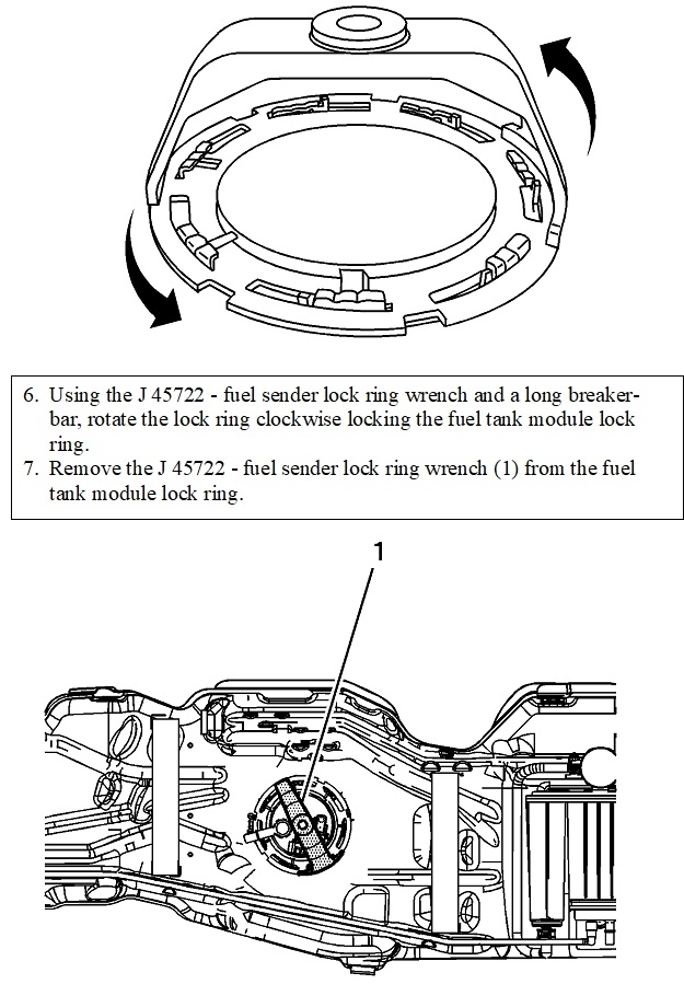

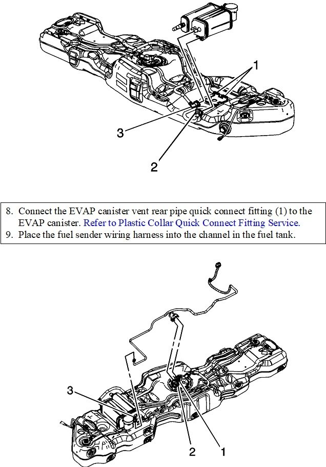

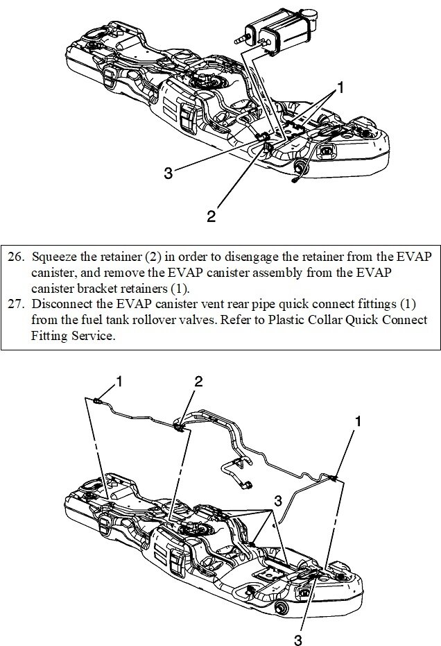

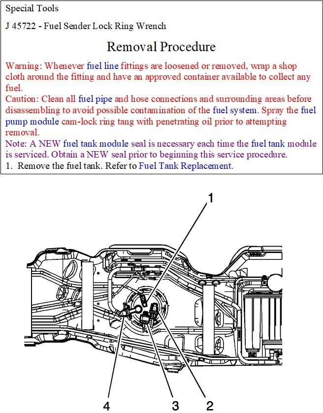

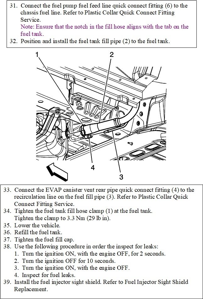

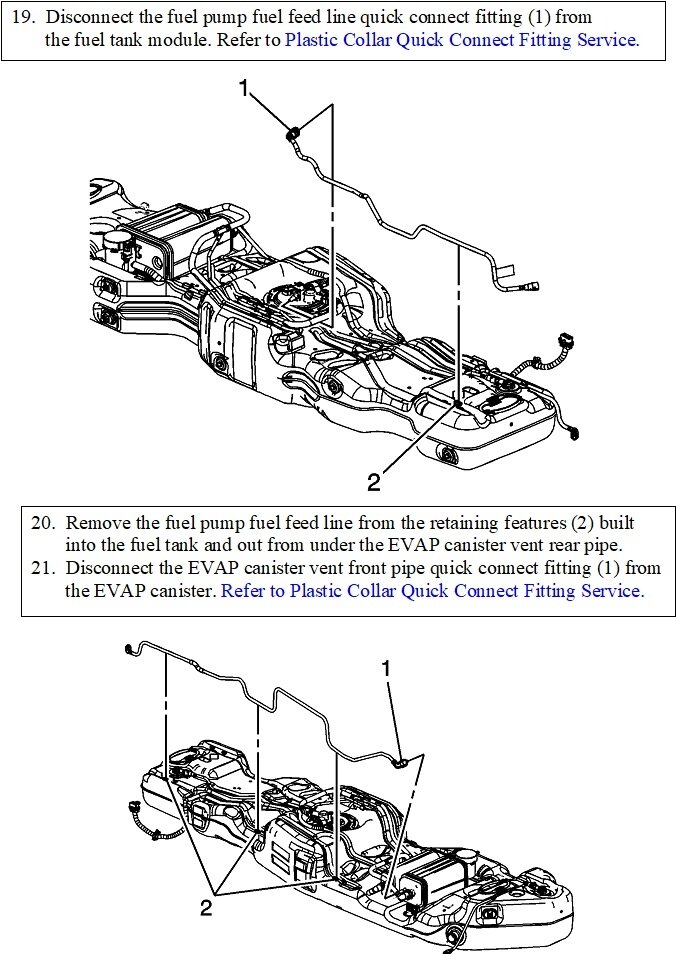

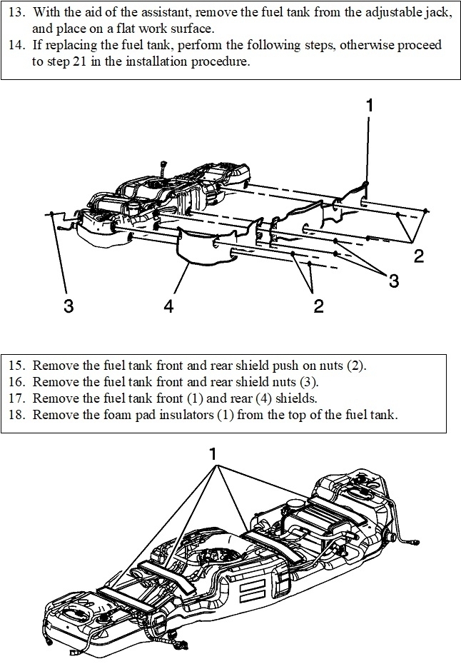

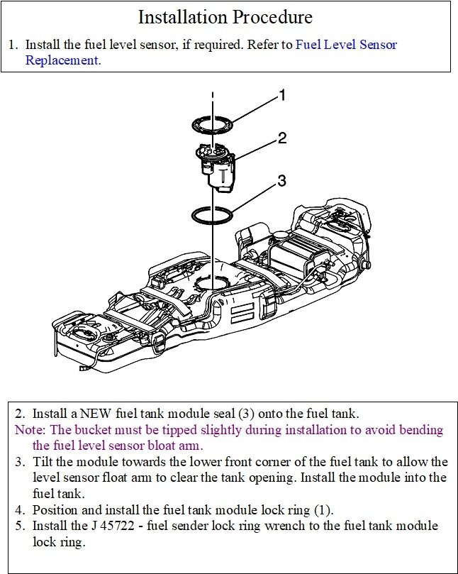

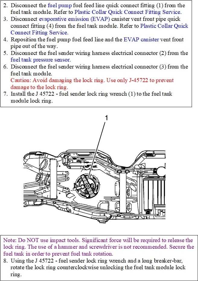

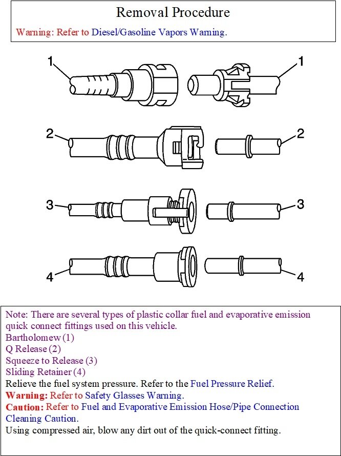

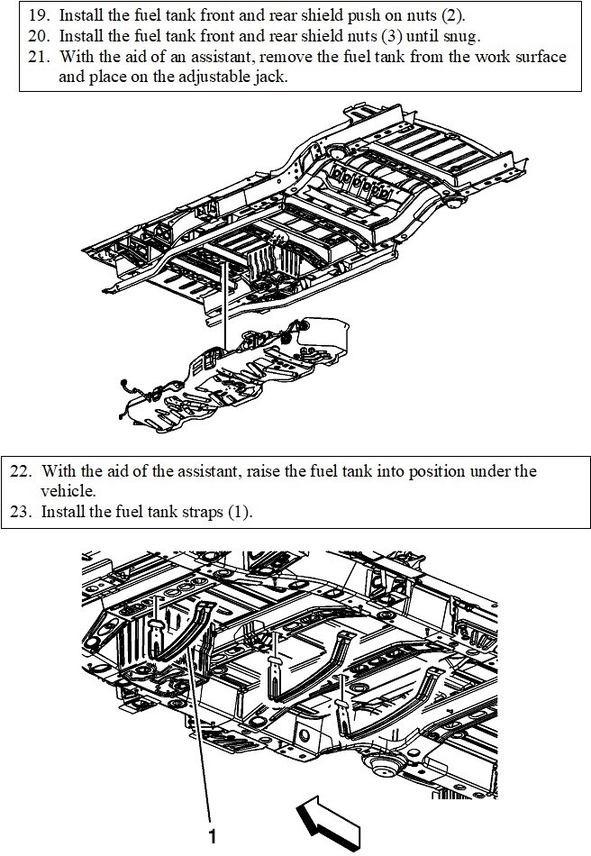

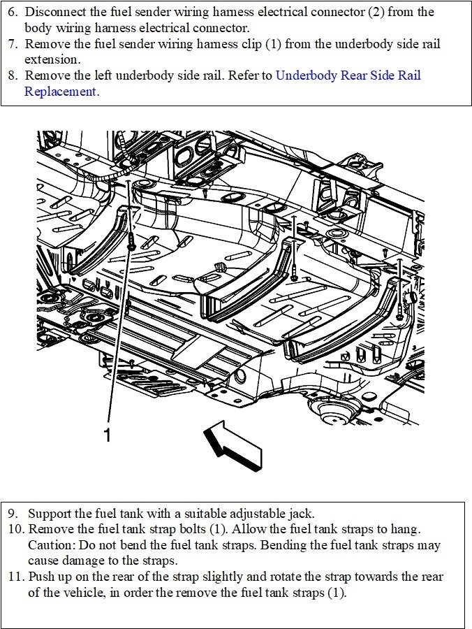

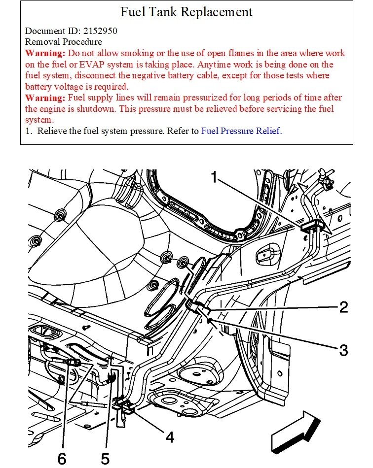

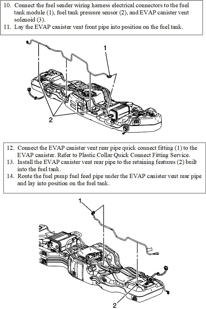

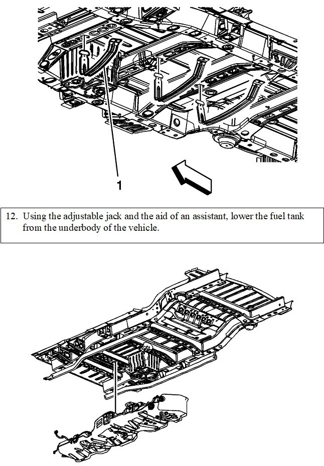

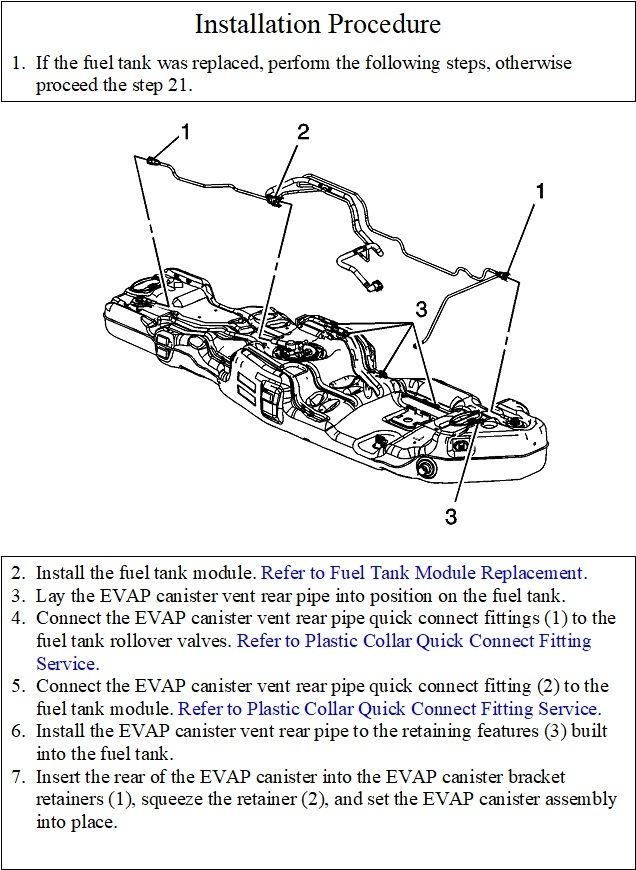

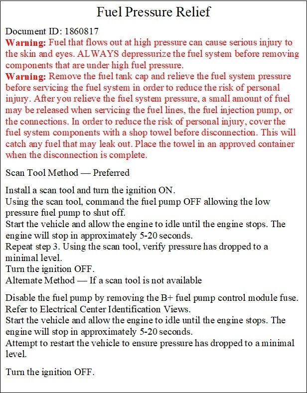

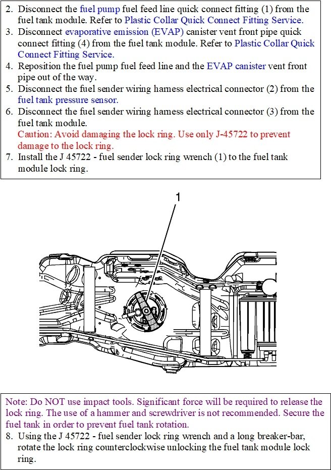

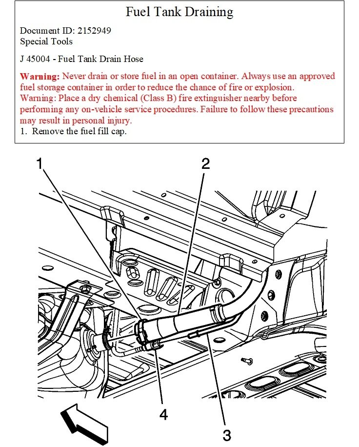

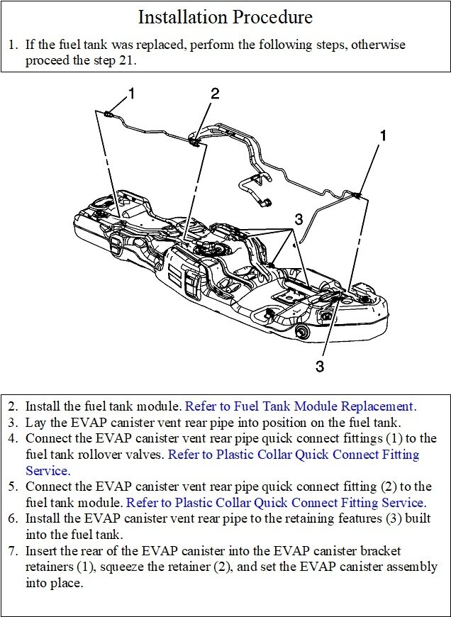

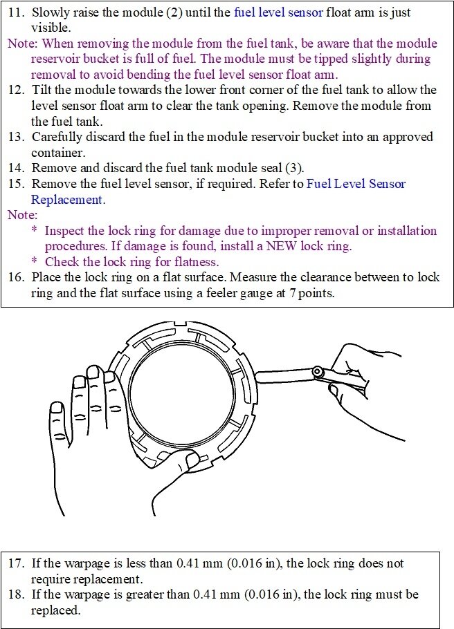

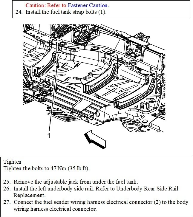

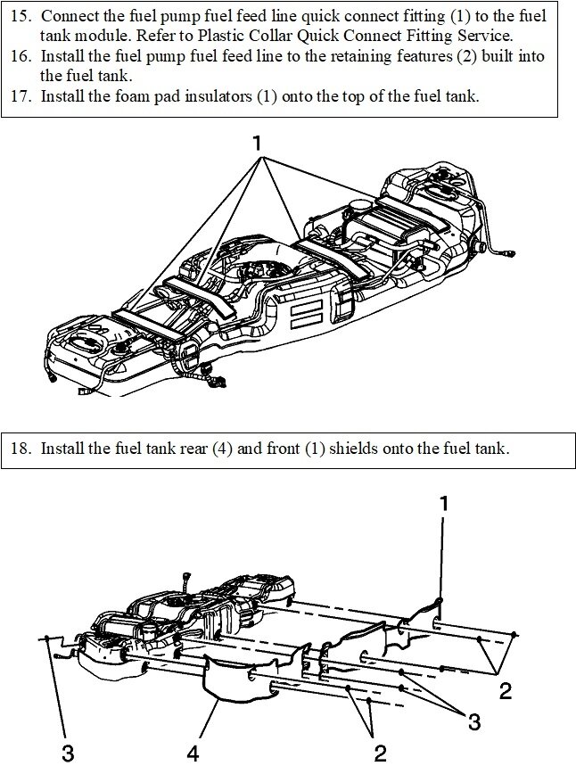

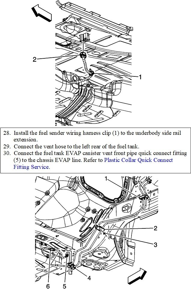

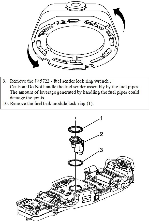

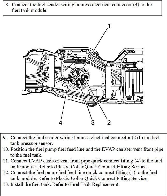

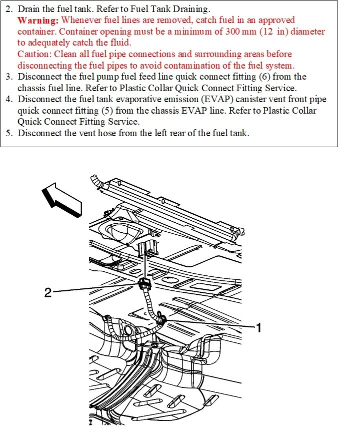

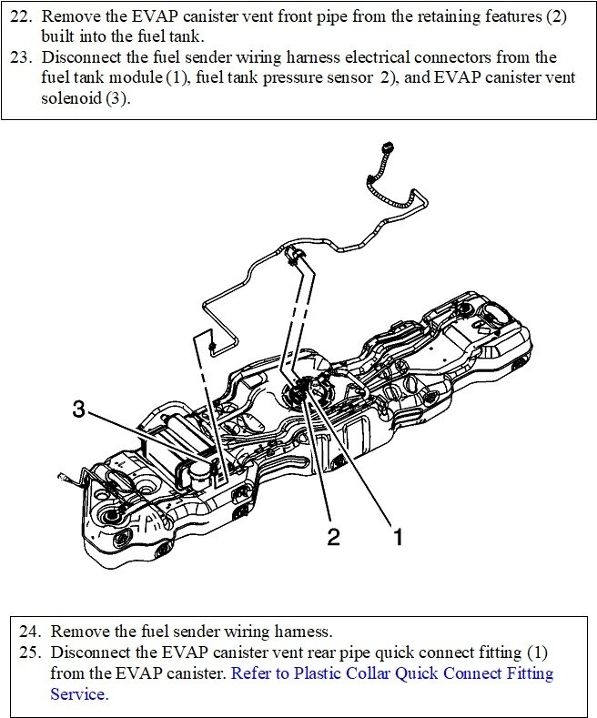

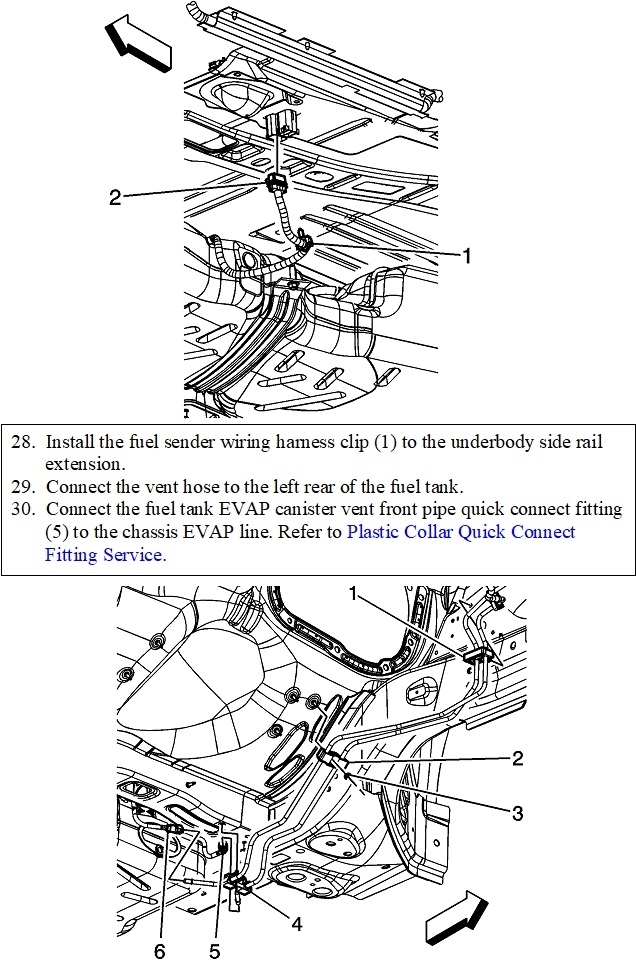

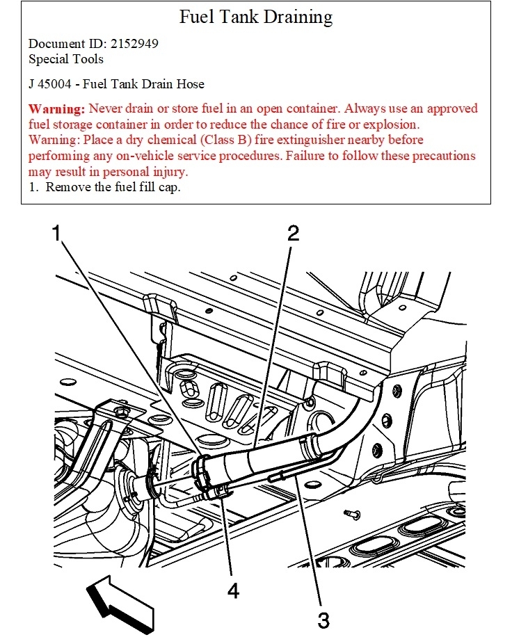

I apologize that you've been waiting so long for a reply, but I can see why. Formatting the instructions for uploading took over four hours. There's a couple of subsections. I'll start with those first in the first three drawings. The next 16 are for removal and installation of the fuel tank. The last seven refer to the pump module assembly. That is the section that pops up for the fuel tank pressure sensor.
