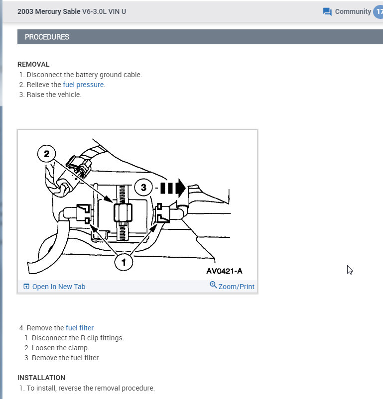

where and how do I replace my fuel filter?
Thanks for your help.
May 12, 2020 at 1:38 PM
I attached the process on how to replace the filter. If you can't find it, just find the fuel lines from the tank and follow them up the fuel rail and you will run into the filter.
Then follow the process to replace. Let me know if you have questions. Thanks
