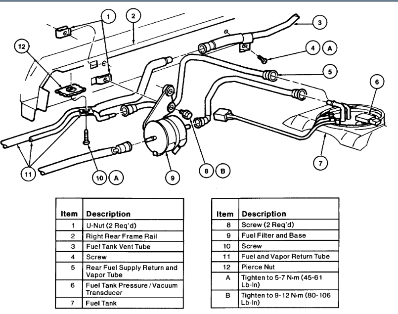

Can you tell me where the fuel filter is located?

They are usually under the car, sometimes at the rear on the p/s and sometimes at the front p/s, but it is under the car and takes a special release tool to get it off. Here is a video to help with the fuel lines and instruction in the diagrams below.

I cant find the fuel filter someone know where?

Under vehicle, passenger side, below seating area, passenger side of fuel tank, mounted on chassis in fuel line

This tutorial shows how to replace a fuel filter.
https://www.2carpros.com/articles/how-to-change-a-fuel-filter
The picture below might help you a little better.Hope this helps and thanks for using 2CarPros.
