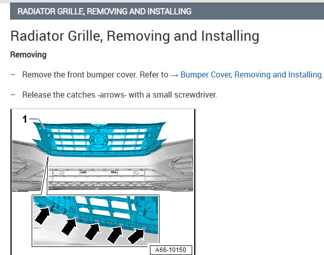

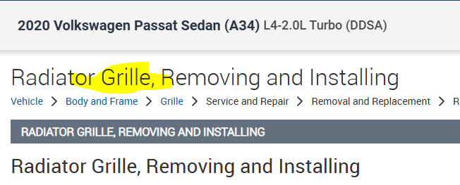

some people say there is a sensor behind it and if I remove the grille I have to recalibrate it is it true? and do you know how the girl is changed
Apr 27, 2026 at 1:25 PM
  • 110,248 POSTS
Hi:

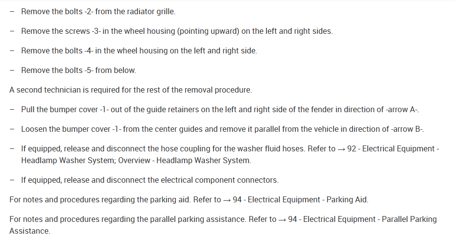

If your vehicle has park assist or parking aid, yes, there is a sensor that requires recalibration.

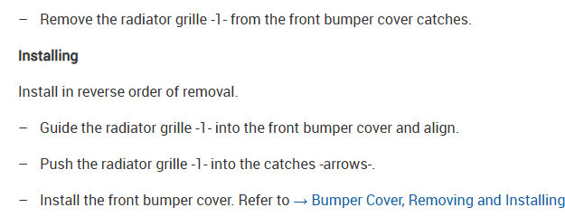

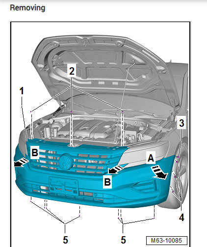

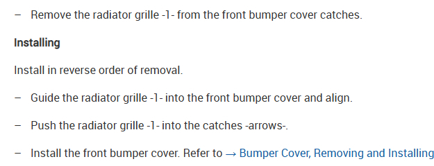

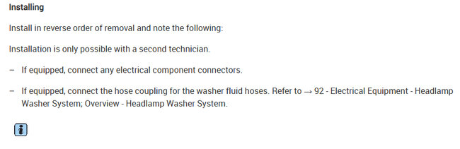

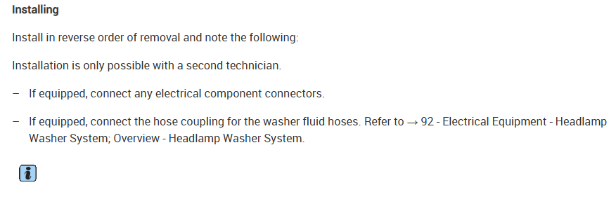

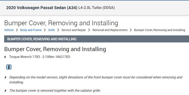

As far as the grille, you will need to remove the front bumper cover. The grille comes off with it.

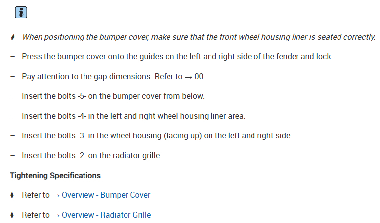

If you look below, I started with the bumper cover removal and then the grille removal
See pics below
