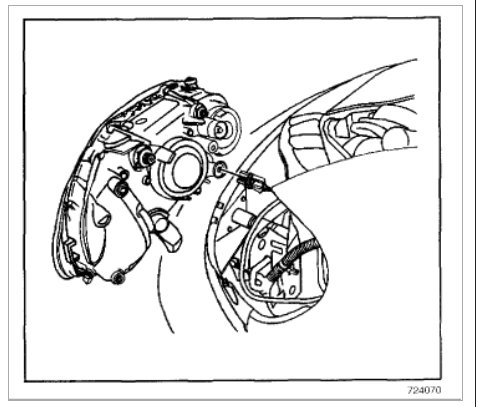

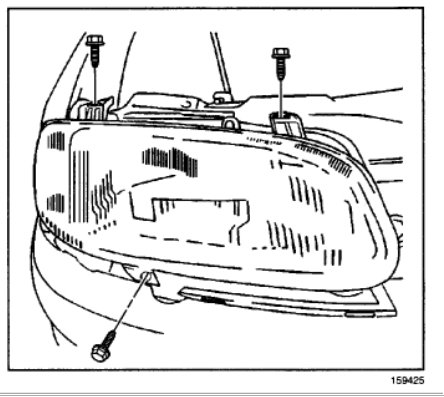

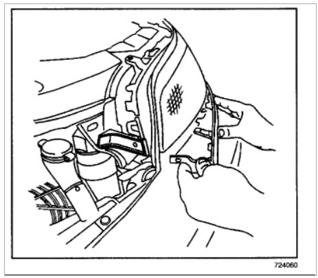

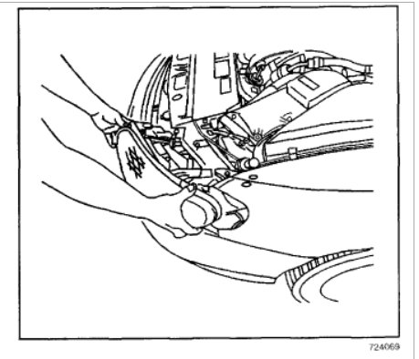

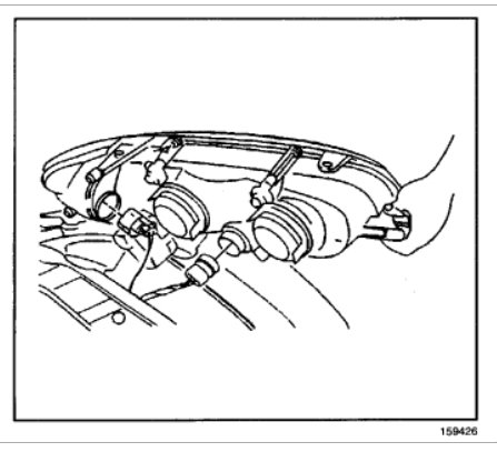

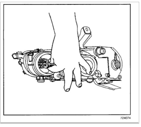

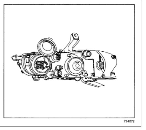

How to replace DRL light bulb? Driver side unable to get hand in to access bulb.
Jan 6, 2018 at 12:00 AM
  • 55,746 POSTS

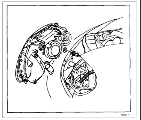

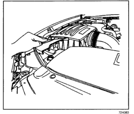

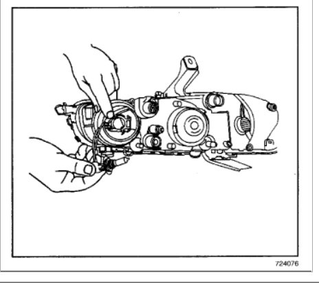

You will need to remove the headlamp lens to replace the DRL bulb. Here is guide that will give you an idea of what you are in for when doing the repair:
https://www.2carpros.com/articles/drl-light-bulb-replacement
Here are diagrams of what it will be like for your car (below).
Jan 7, 2018 at 3:00 AM
ITZALGUD3
Thank you for the prompt reply. Your solution was right on. Had a little confusion removing first headlamp but after figuring it out the other side went smooth. The diagrams and pics were very helpful. Wow! now my DRL lights work on both sides. May have avoided a ticket.
