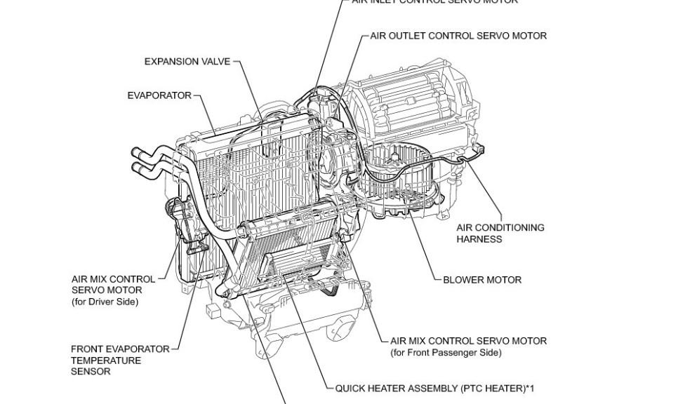

How to replace drivers side blend door actuator?
Dec 29, 2018 at 7:26 AM
Good evening.
Do you have manual A/C controls or automatic climate control? it does make a difference.
I have attached a picture for you of the automatic climate control since you have dual controls. it is under the left side of the dash on the side of the heater case.
https://www.2carpros.com/articles/replace-blend-door-motor.
If you have manual controls then it is a different story. the dash has to be removed to access the actuator.
The labor for the automatic climate control is .8 hours or about fifty minutes.
The labor for the manual is 6.5 hours.

Thanks for the information. do you know what you have to remove to get to it? thanks, Bill
Dec 30, 2018 at 1:18 AM
BILL JUSTICE
  • 5 POSTS
this is automatic climate control, forgot to mention that.Thanks Bill
Dec 30, 2018 at 1:20 AM
Just the bottom cover under the dash by your feet. it should have a couple of small bolts holding it then you need to get under the dash and up to the side of the heater case.

Is there any difference between 2WD and AWD models? I have a 2013 Limited AWD. I am only getting hot/warm air on Driver side vents.
Gratefully,
Troy Taylor
May 16, 2026 at 7:39 AM
  • 55,400 POSTS
Nope, there is no difference between the AWD and 2WD models for the HVAC system. It sounds like the drivers side blend door actuator is not working.
