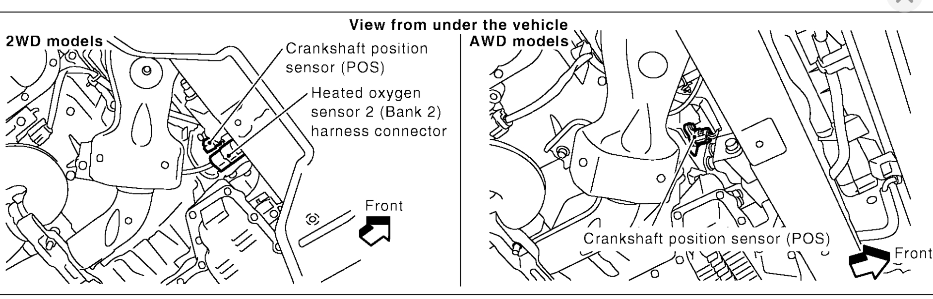

How to replace crankshaft sensor?
Friday, November 13th, 2020 AT 12:21 AM
MECHANIC
52,796 POSTS
Good morning,
I attached a YouTube video for you on the replacement. All the 3.6 engines are the same for replacing the sensor.
https://www.youtube.com/watch?v=rtR5zvqwOpo
Why do you think it is the sensor? Do you have a code that identifies a sensor issue? When you crank the engine, the tach should move on the dash. If it does, the sensor is working sending a signal to the ECM.
As far as the rest, can you hear the fuel pump run when you turn on the key?
Did you check for spark at the plugs?
