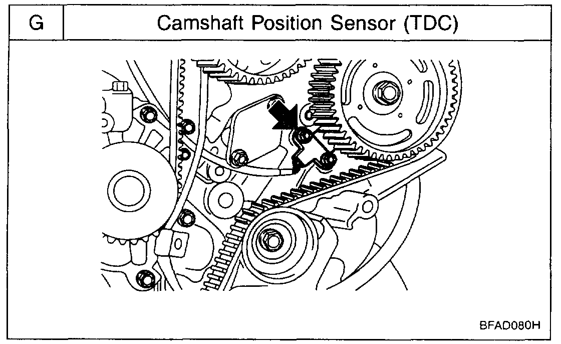

the car wont start, it turn over but it wont start.
Dec 21, 2018 at 11:53 AM
  • 110,240 POSTS
Are you sure the cam sensor is the problem? The camshaft sensor on this vehicle is difficult to replace. It is behind the timing belt cover. I attached a picture for you to see it. Now, you say the car won't start. The cam sensor won't cause this. If the sensor does not operate correctly, sequential injection is may not occur and the engine may stall or run irregularly at idle or fail to accelerate normally. However, it will run.
With that in mind, read through this link. It discusses the most common causes of a crank no start.
To determine what may be causing it not to start, you should first check to see if there is spark and fuel to the engine.
