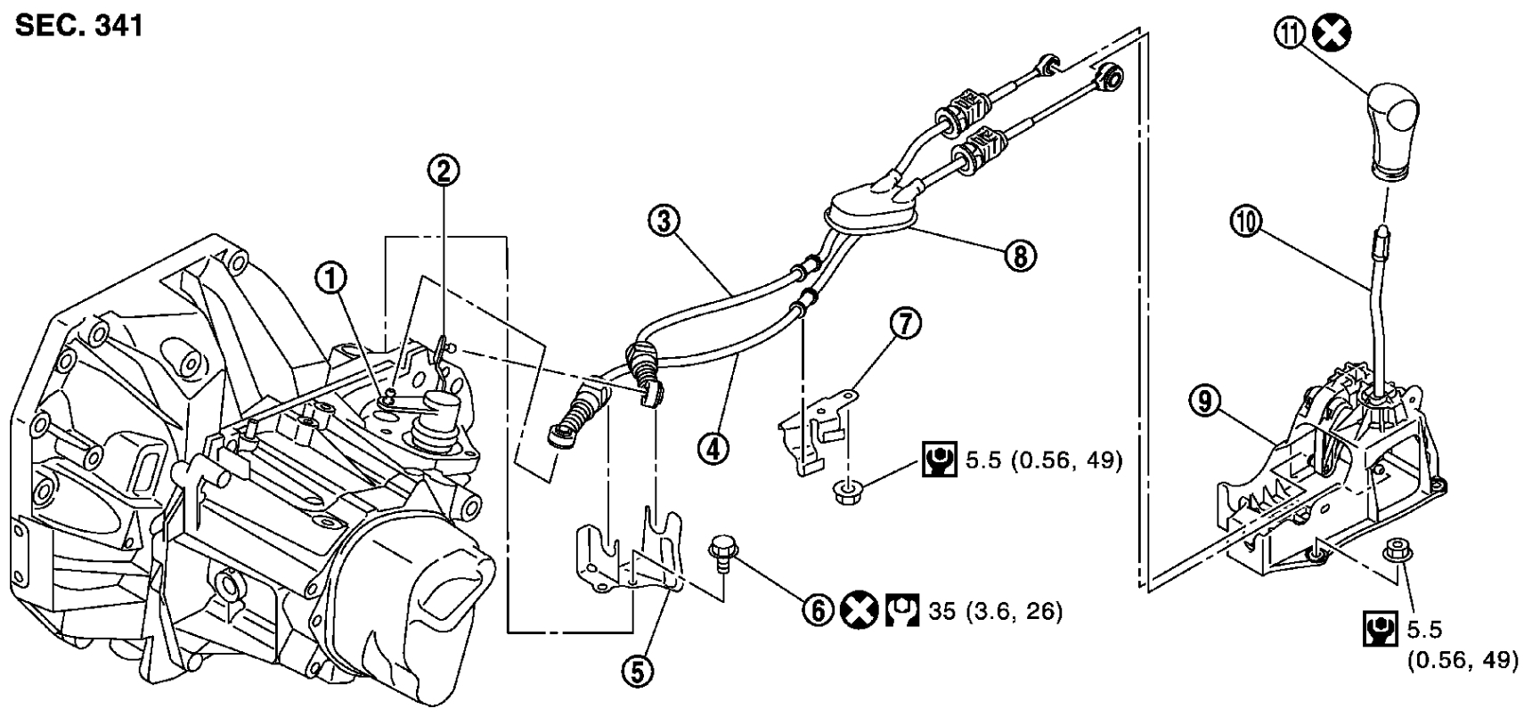

Could you help me in replacing my shift cable control assembly system for my vehicle listed above 5-speed manual transmission 1.6 l?
Jan 1, 2025 at 6:00 AM
  • 55,690 POSTS

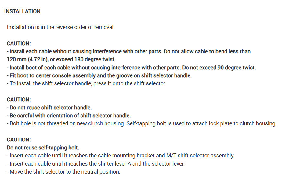

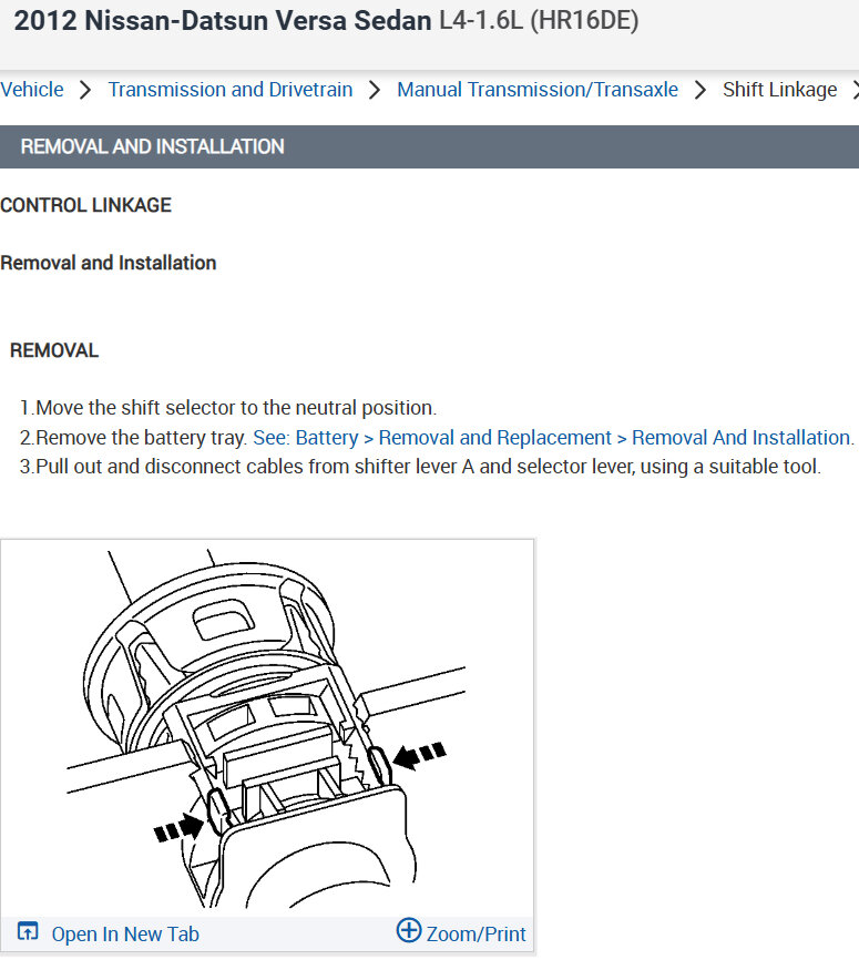

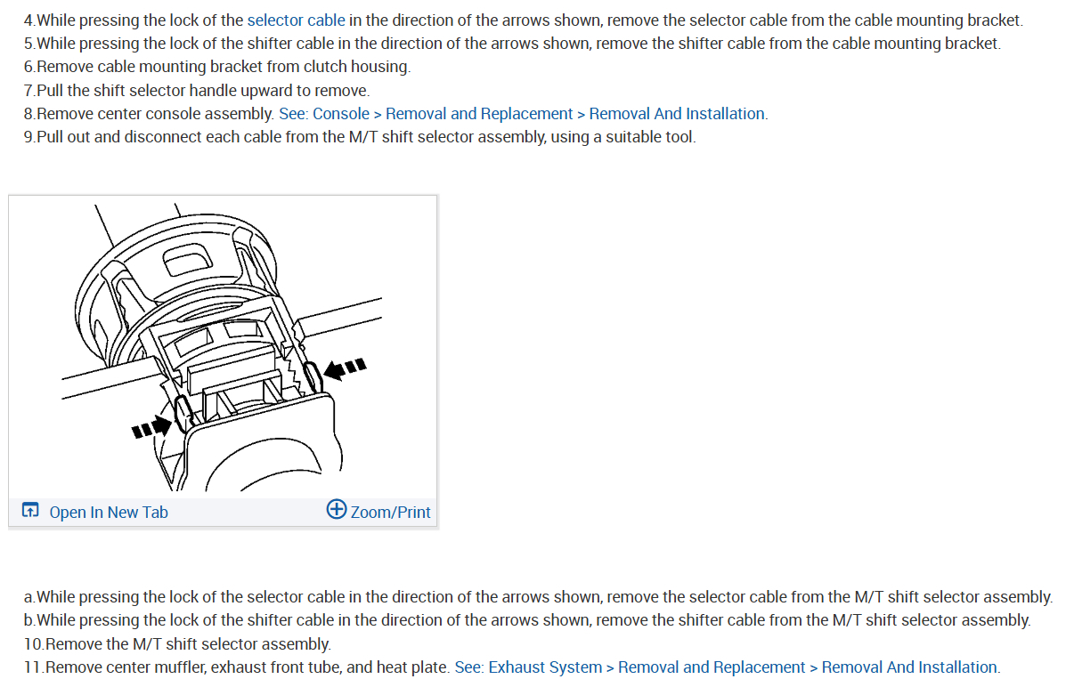

Sure, here is the overview of the system and how to remove and replace the shift cables, you will need to so some adjustments which I have included for you as well. Check out the images (below). Let us know if you need anything else.
