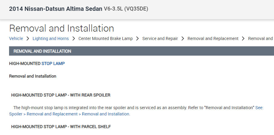

The plastic casing around the brake light in the back of my car which is mounted above the trunk of my car is broken and makes sounds while i play music. How do i replace it or how do i get that specific part?
Feb 27, 2024 at 5:34 AM
  • 110,244 POSTS

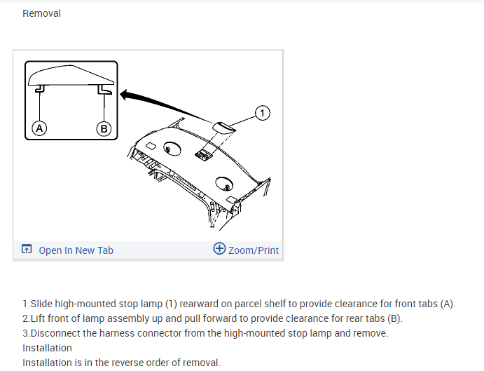

Hi:
I attached the directions below for removing the light assembly. Is that what you are referring to? If it isn't, could you upload a few pictures of the part?

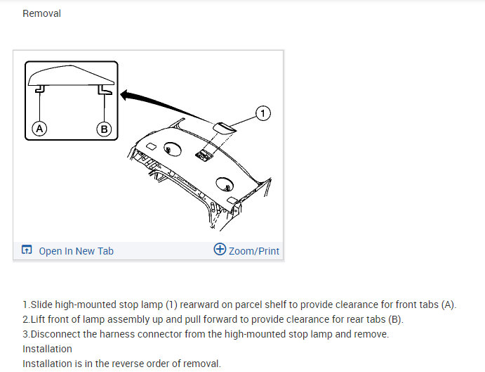

See pics below
