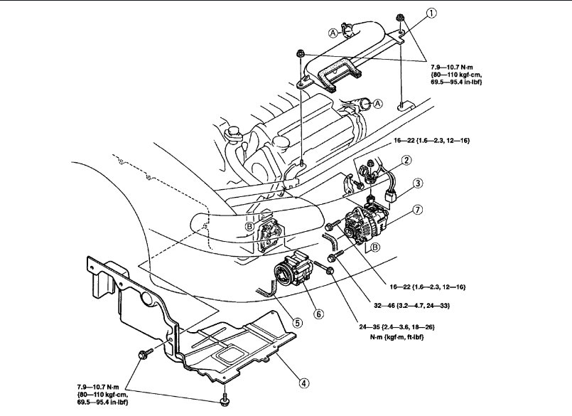

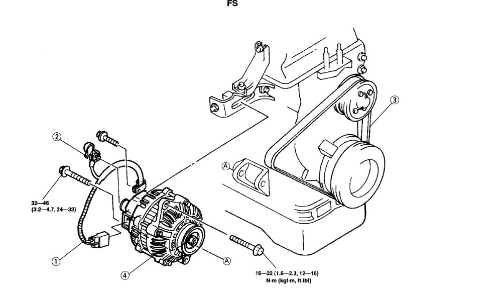

What do I take off to remove the alternator?
Sep 6, 2018 at 1:55 AM
Good morning.
There are two different models for the alternator. I attached both models below and a picture for each.
FS MODEL GENERATOR
Removal/Installation
Caution:
- Reversing the battery connections or using high-voltage testers will damage the rectifier.
- Do not start the engine while the connector is disconnected from terminals L and S It can damage the generator.
- When the battery cables are connected, touching the vehicle body with generator terminal B will generate sparks. This can cause personal iniury, fire, and damage to the electrical components. Always disconnect the battery before performing the following operation.
Note: Battery positive voltage is always present at generator terminal B when the battery is connected.
1. Disconnect the negative battery cable.
2. Remove the warm up three way catalytic converter.
3. Remove in the order shown in the figure.
4. Install in the reverse order of removal.
kl

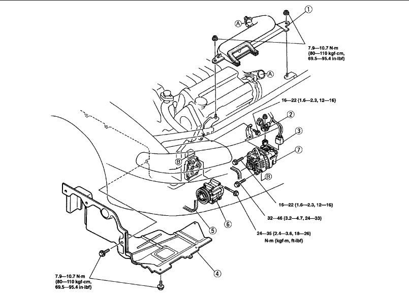

KL MODEL GENERATOR
Caution:
1. Fresh-air duct
2. Generator terminal B wire Inspect for damage and corrosion
3. Connector
4. Splash shield
5. Drive belt
6. Compressor
7. Generator
