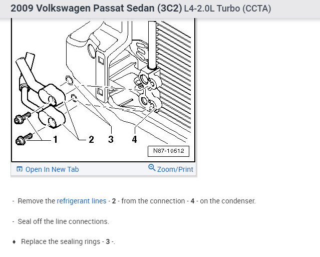

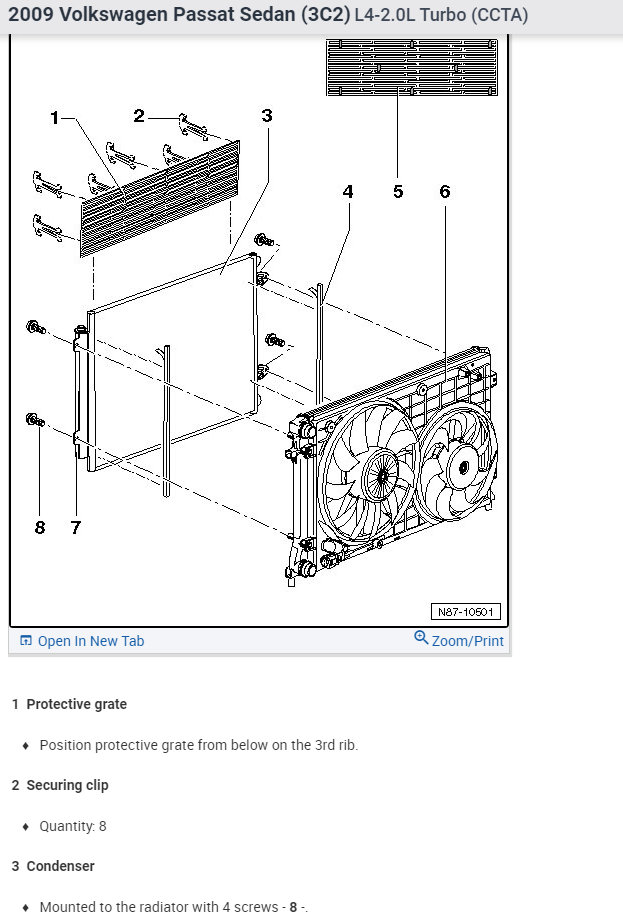

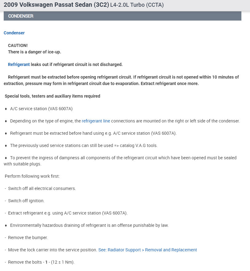

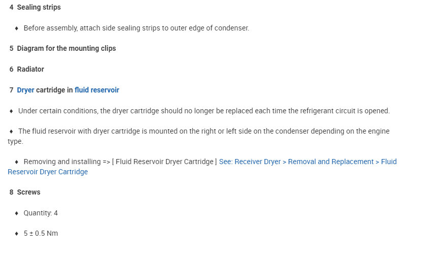

What are the steps/procedures to replace the A/C condenser?

Keep in mind that before changing out the condenser, you will first have to discharge the A/C system using the appropriate method.
Here is a helpful guide on that:
I have attached the condenser replacement procedure below.
Let me know of any questions.

Take a look at the attached images on the previous post, you will see the condenser replacement procedure.
