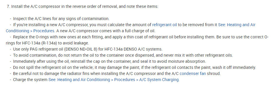

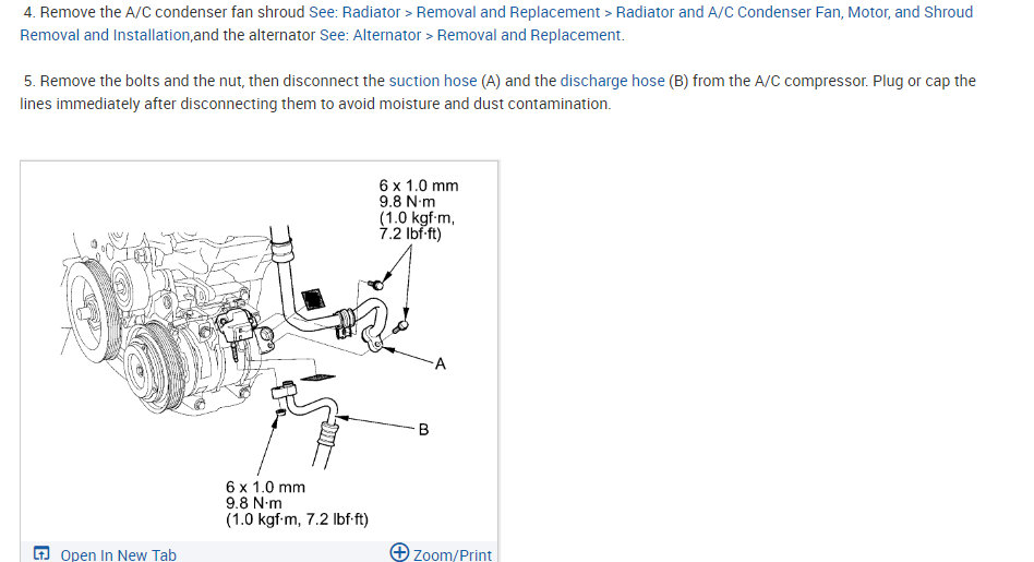

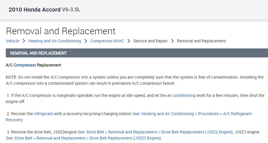

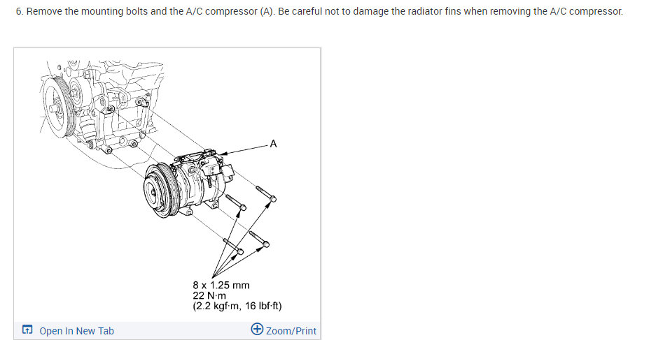

V6, 3.5l. A/C compressor replacement instructions needed.

If the old one is bad, it is important the system is flushed out. Most times, the condenser is replaced as well.
As far as the compressor, I attached the directions I have below. Take a look through them and let me know if it helps.
Take care and Happy 4th!

Removed alternator and compressor and fan, all good.
