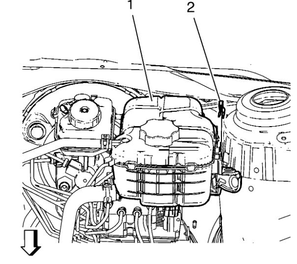

2. Remove the radiator surge tank clip (2).
3. Remove the radiator surge tank (1).

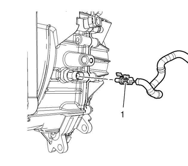

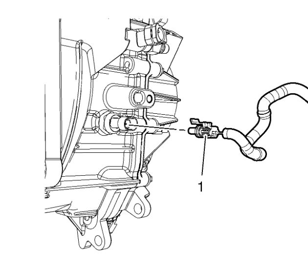

5. Disconnect the electrical connector (1) from the backup lamp switch.

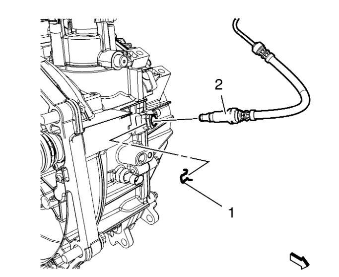

Note: Before disconnecting the clutch actuator cylinder front pipe, remove the clutch/brake fluid from the reservoir tank.
6. Remove the clutch actuator cylinder front pipe retainer (1).
7. Disconnect the clutch actuator cylinder front pipe (2) from the clutch actuator cylinder pipe elbow.

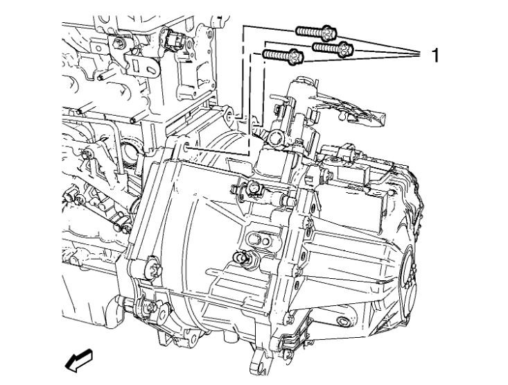

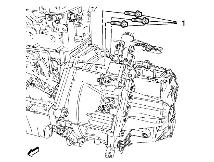

8. Remove the 3 upper transmission bolts from engine (1).

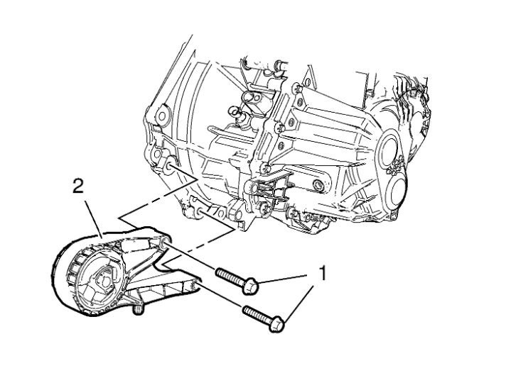

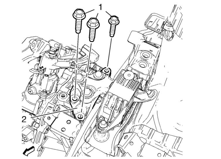

11. Remove transmission front mount from transmission (2). Remove 2 bolts (1).
12. Remove the transmission mount bracket bolts (1) and the rear transmission mount bracket (2).

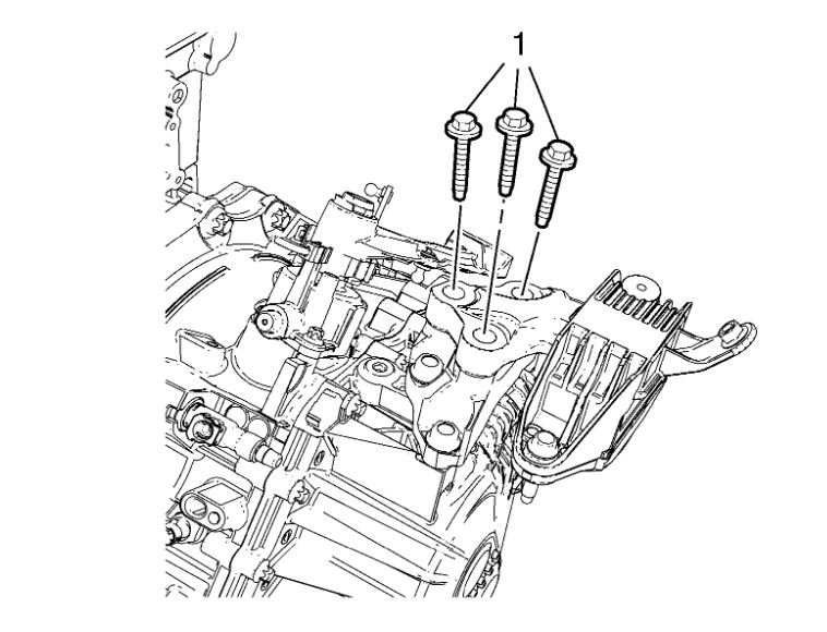

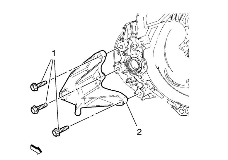

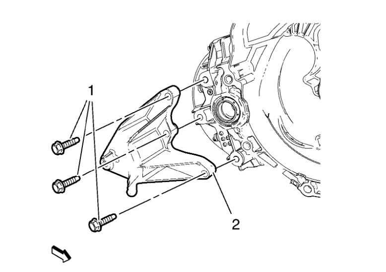

20. Remove transmission mount bracket - left side from transmission (2). Remove 3 transmission mount bracket bolts (1).

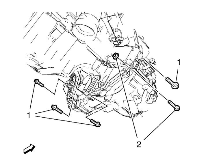

22. Remove 4 transmission lower bolts (1)
23. Remove transmission lower bolt and nut (2)
