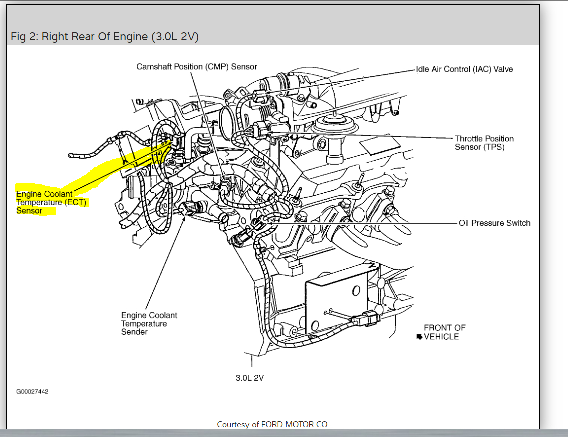

SCGRANTURISMO
  • 4,897 POSTS
Your vehicle's Engine Coolant Temperature Sensor (ECT) is located on the back of the engine near the thermostat. In the diagrams down below I have included a diagram of the ECT. Please get back to us with how everything turns out.

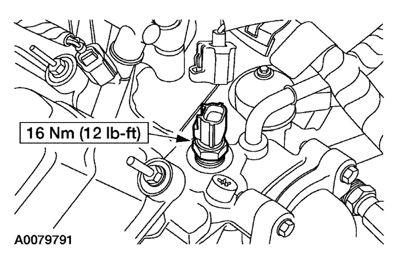

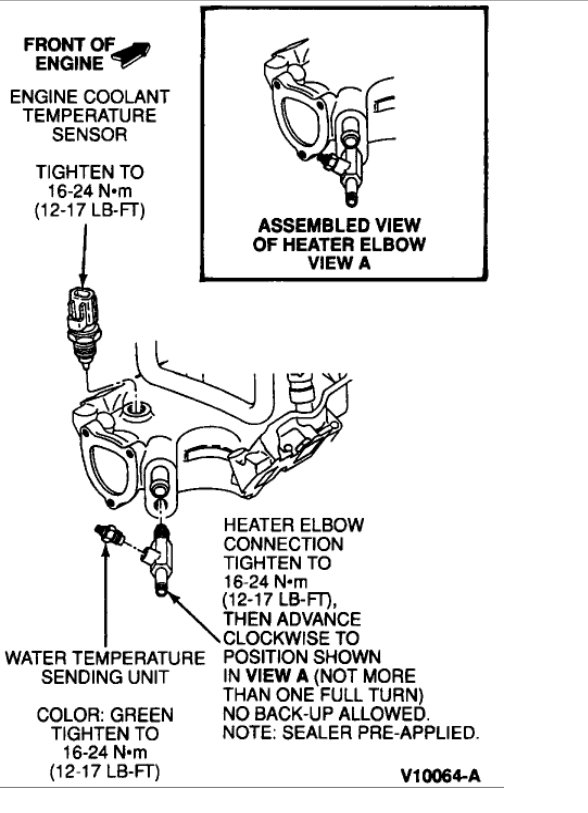

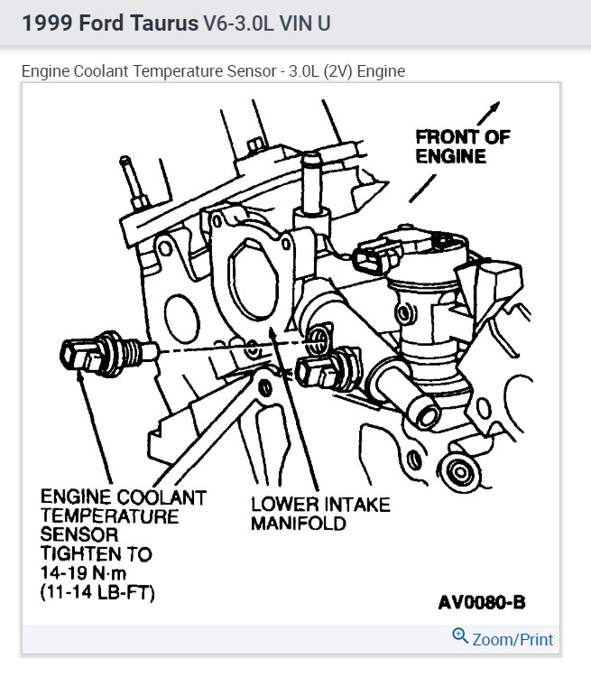

JMGONZALEZ
where can i find the heating sensor on a 1999 ford taurus wagon
Jun 8, 2021 at 10:52 AM (Merged)
BLUELIGHTNIN6
  • 16,542 POSTS
if you are referring to the engine coolant temperature sensor than it is located on the rear of the engine block near the thermostat
Here is a diagram below:

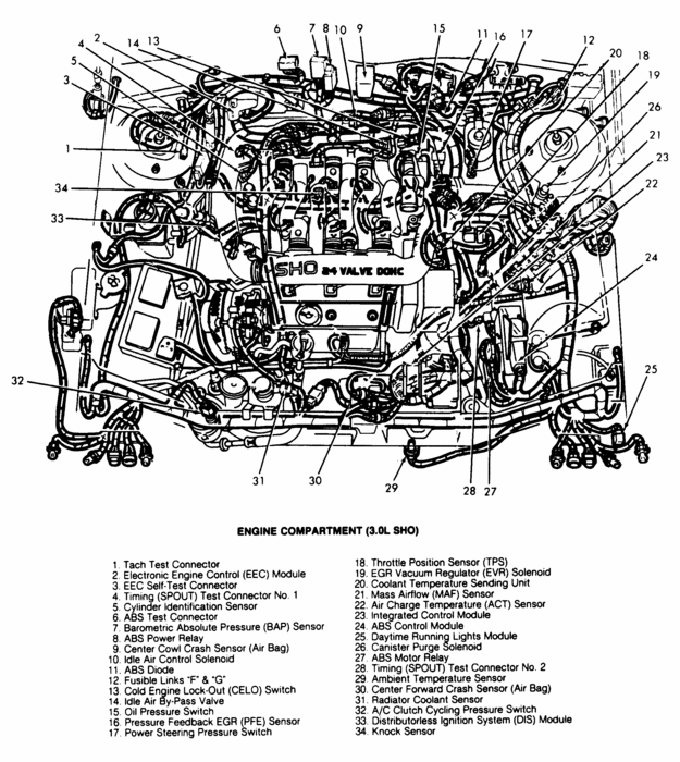

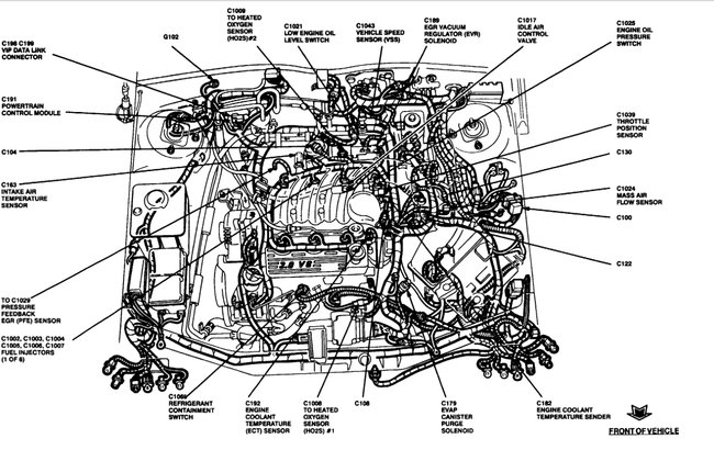

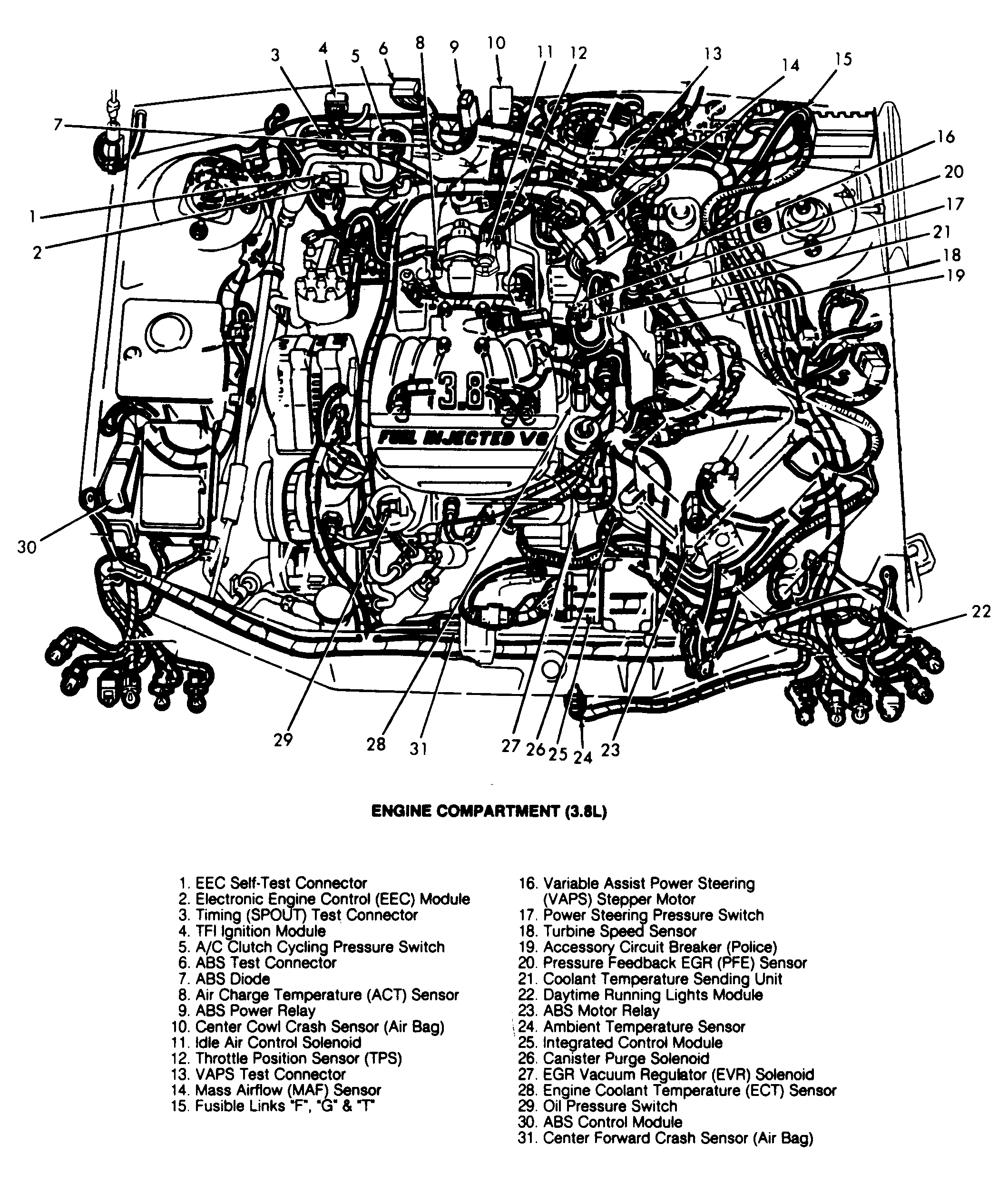

KINGVISION
My temperature gauge has been fluctuating and I believe the temperature sending unit may be bad.
Jun 8, 2021 at 10:53 AM (Merged)

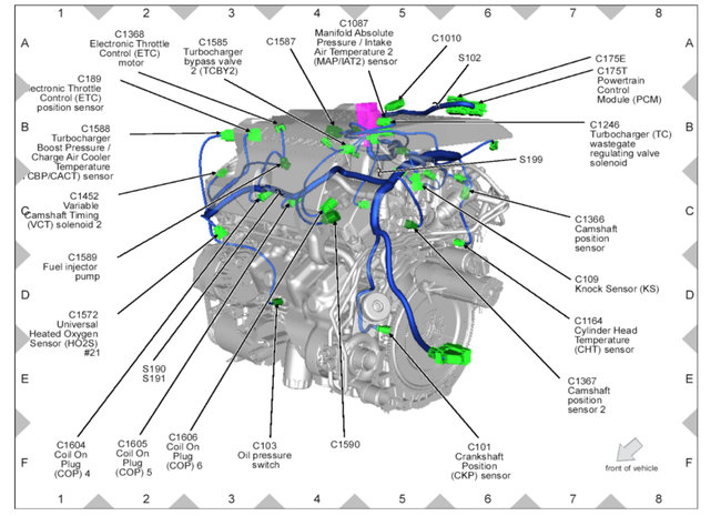

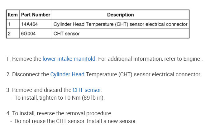

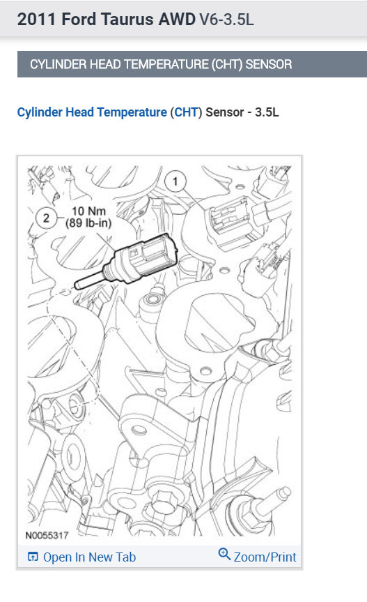

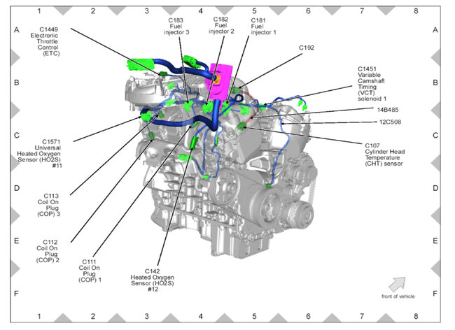

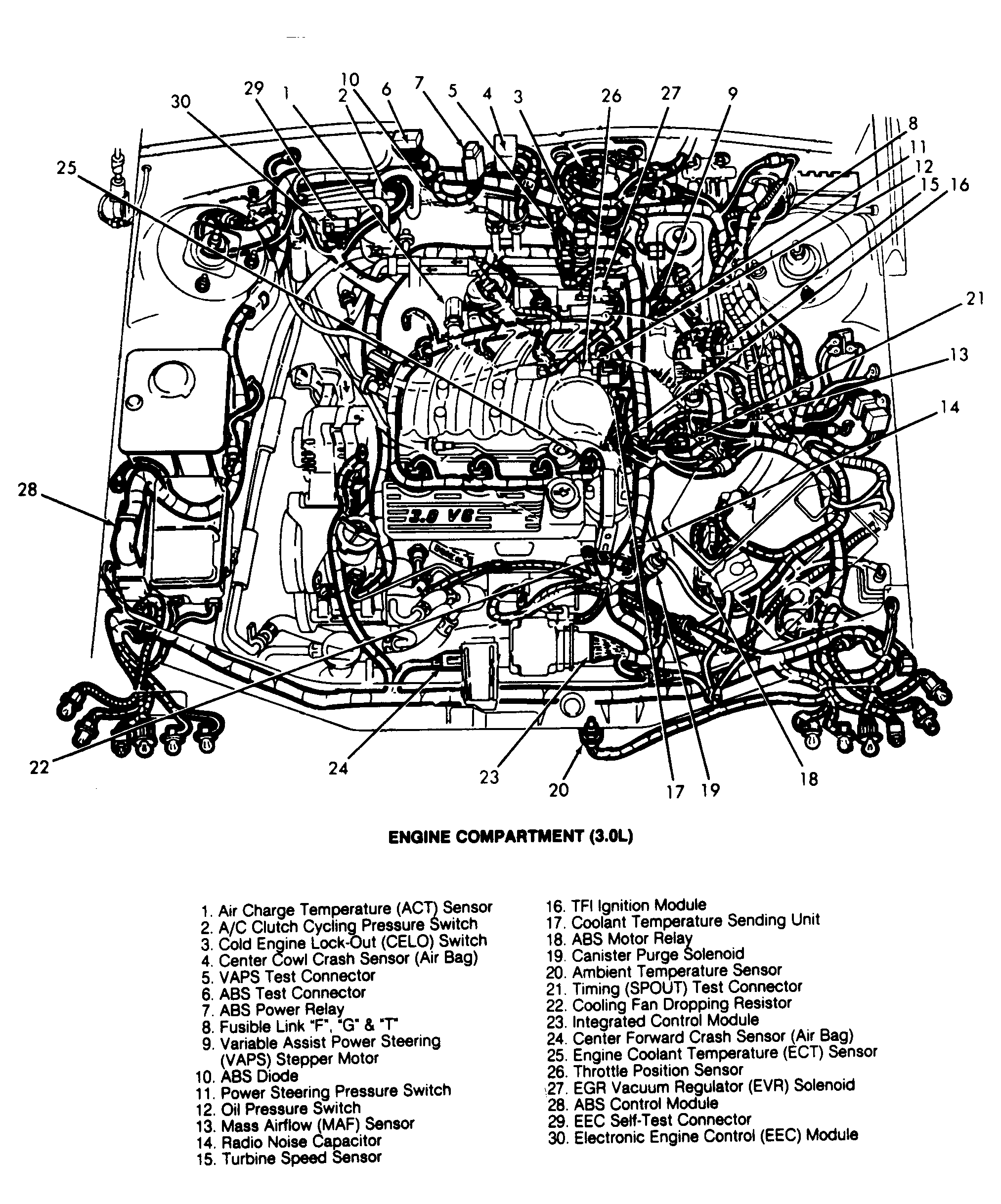

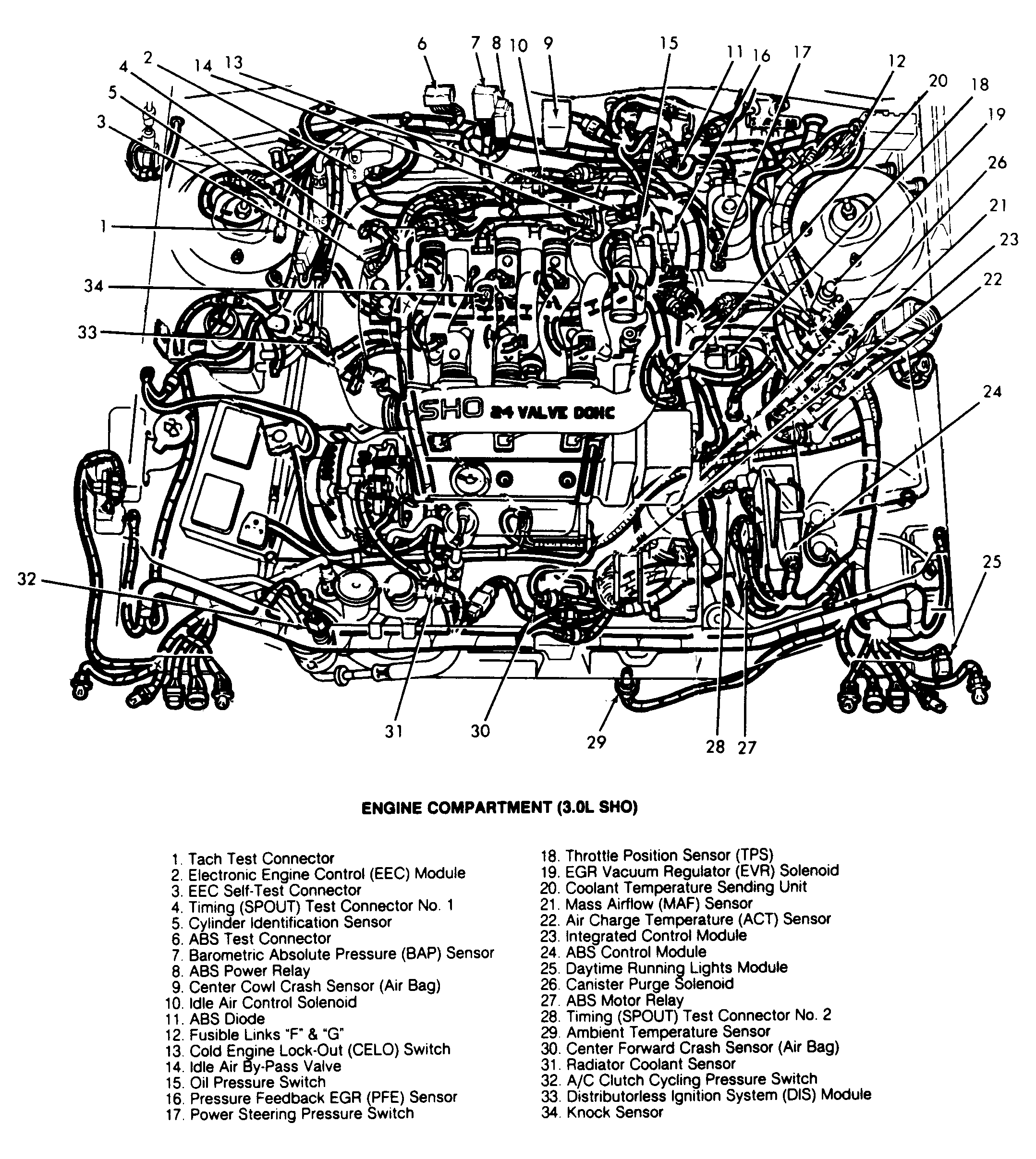

RIVERMIKERAT
  • 6,106 POSTS
Image #1 1992 Ford Taurus 3.0 sensors locations on the top left side of the engine.
Image #2 Taurus 3.0 SHO sensors locations, by the throttle body.
Image #3 Taurus 3.8 sensors locations, at the top left rear of the engine.
KINGVISION
Thank you. It was the 3.8 by the way. I had kept thinking that was it, but for some reason it didn't look the same as the one I ordered. Thanks again.
