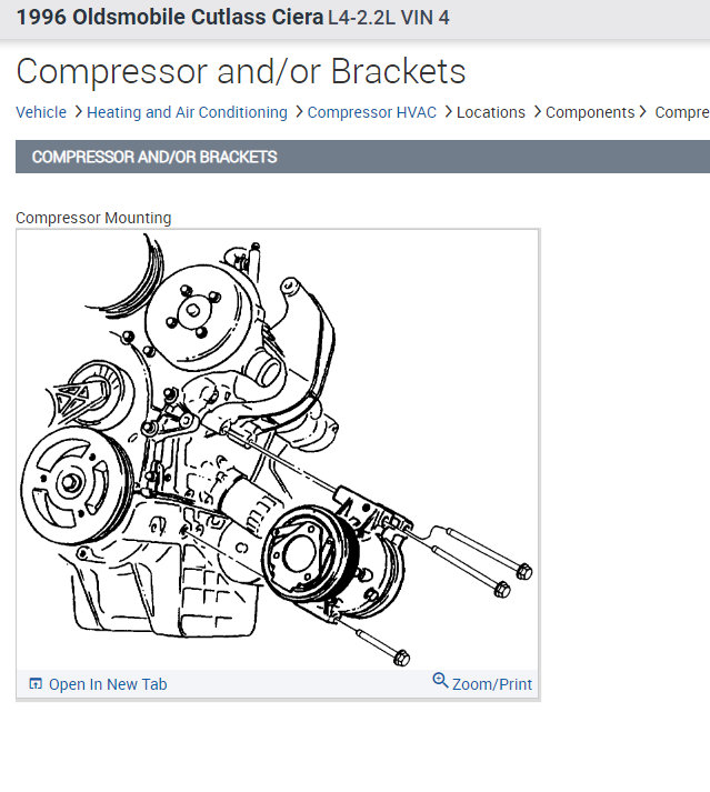

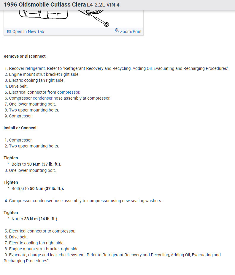

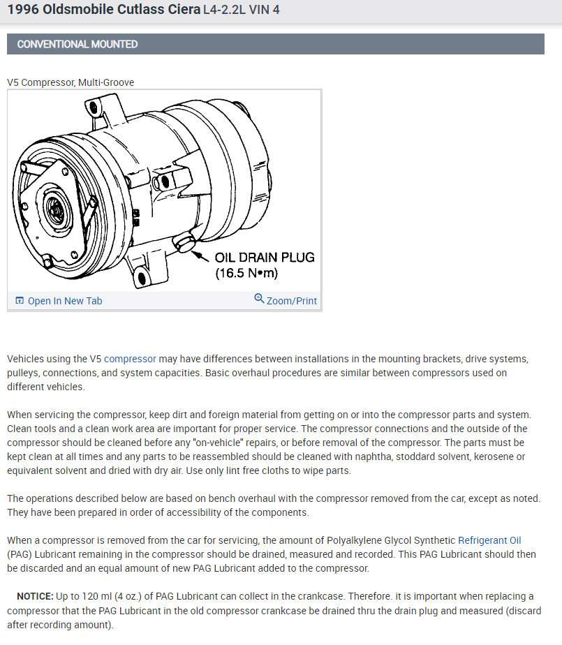

Replacing the A/C compressor can be done in a reasonable amount of time depending on your comfort level.
Before taking off any of the hoses you will have to evacuate the A/C system.
Here is a helpful video of how to do that:
https://youtu.be/4EqdrBVb0sY
The serpentine belt needs to be removed before you take out the A/C compressor.
You might find this article helpful:
https://www.2carpros.com/articles/replace-air-conditioner-compressor
I have attached the replacement procedure for the A/C compressor below.
