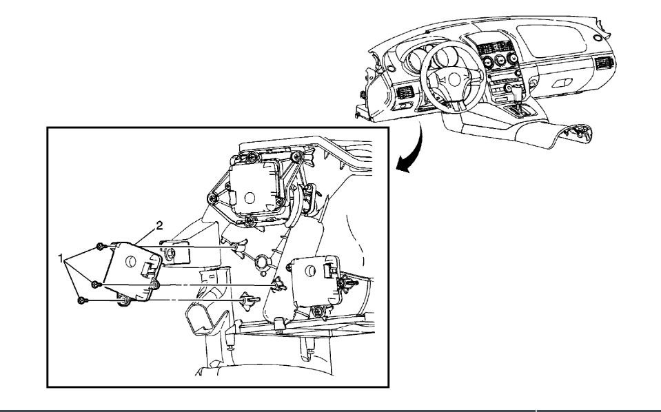

Do you have any instructions or diagrams on how to get into the vehicle listed above to replace the blend door actuator?
May 12, 2020 at 8:25 PM
Good morning,

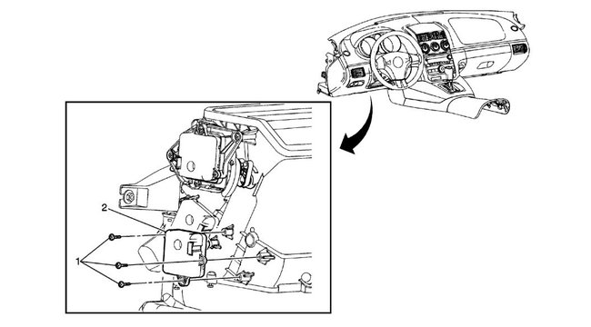

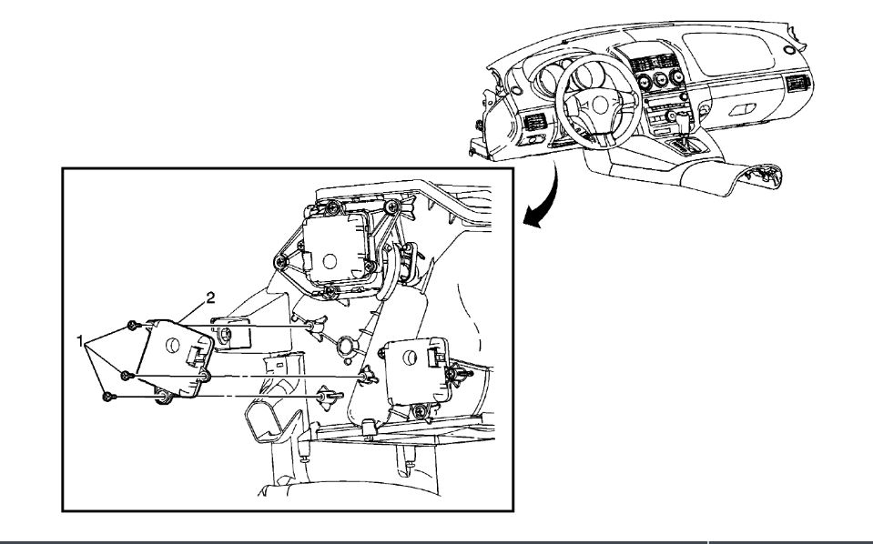

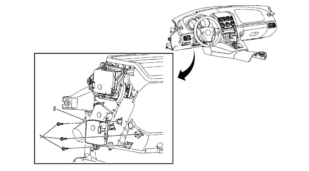

You have 2 actuators, one for the left and one for the right.
What is the exact issue you have with the actuators?

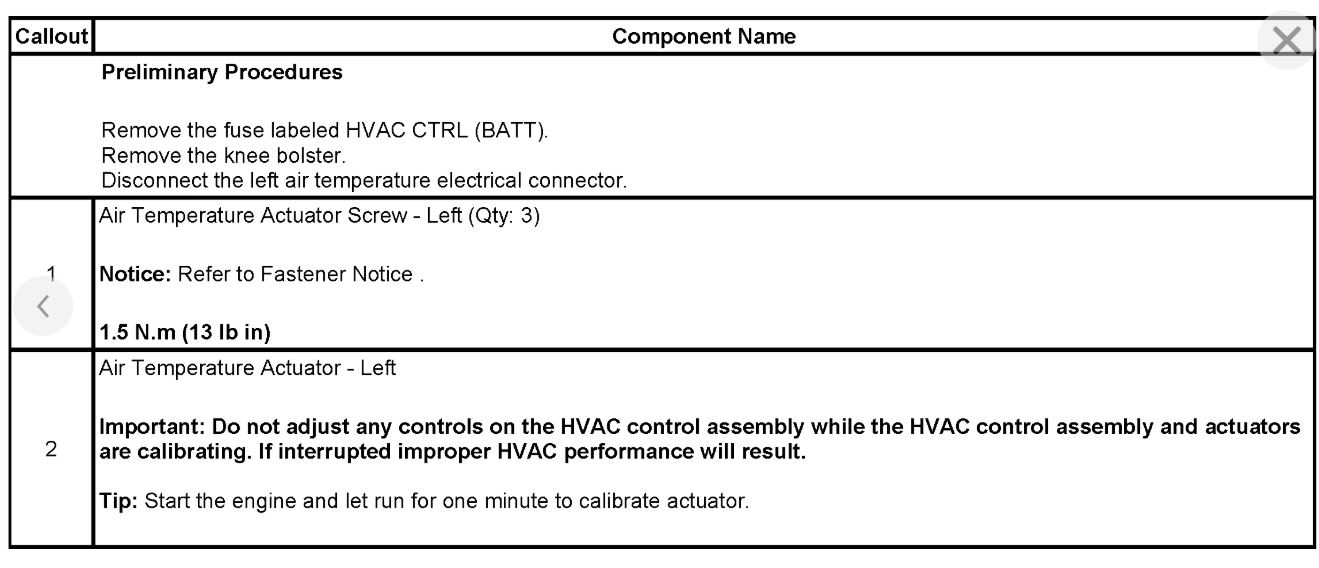

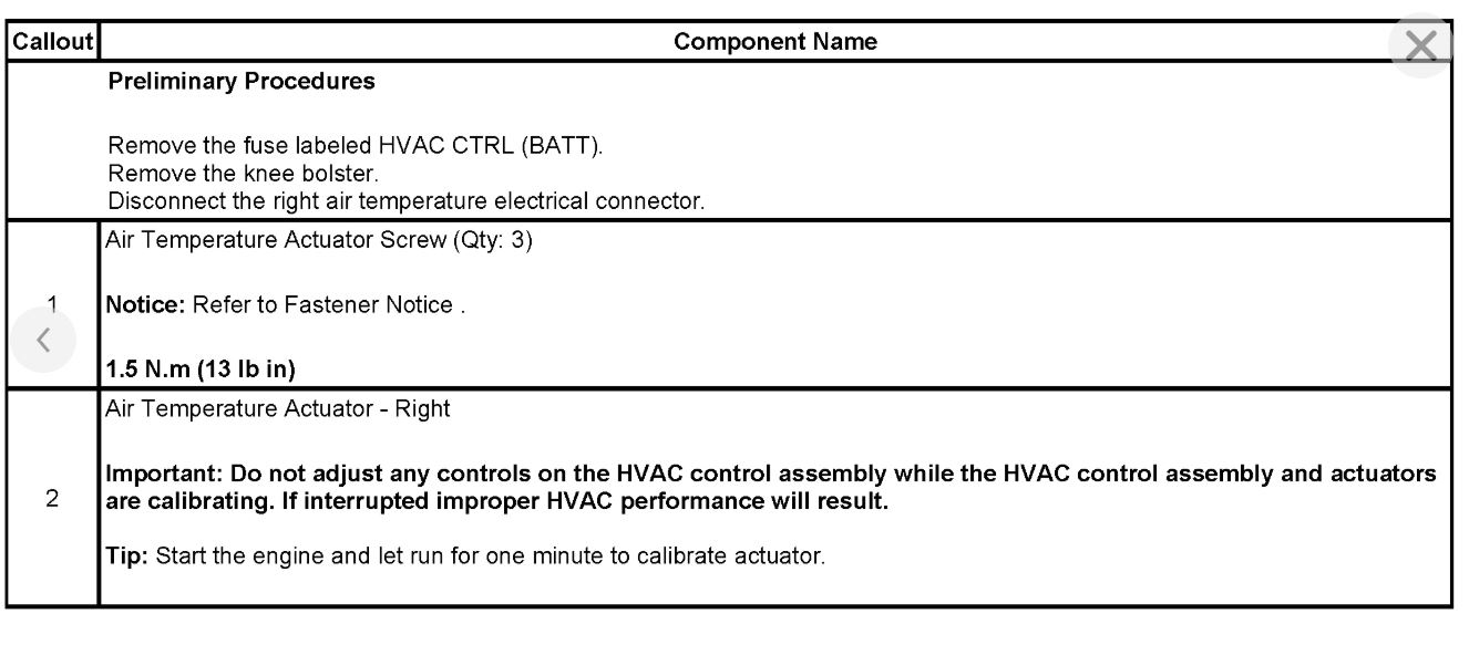

I attached the procedures and pictures for you of the blend doors.
May 12, 2020 at 9:48 PM
WANGOTANGO
The car is so small and compact. I thought you might have "specific" to vehicle instructions how to dismantle to reach component part that needs replaced. For example, I had to remove a quarter body panel to access the battery in order to change it out...
May 12, 2020 at 10:02 PM
The actuators are under the left side of the dash on the side of the HVAC unit.
All you need to do is go under the left side of the dash by the fuel pedal for access to them. There are 3 there and I already attached which one is fro which side for you.
