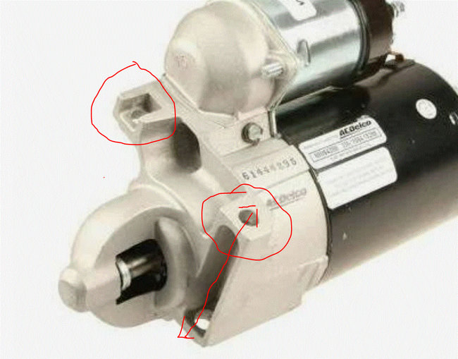

I can't find all the starter bolts. I'm sure I'm going to have to remove other items to get to the starter. Can you tell me what I need to remove and in what order please?
May 28, 2022 at 11:57 AM
  • 110,244 POSTS

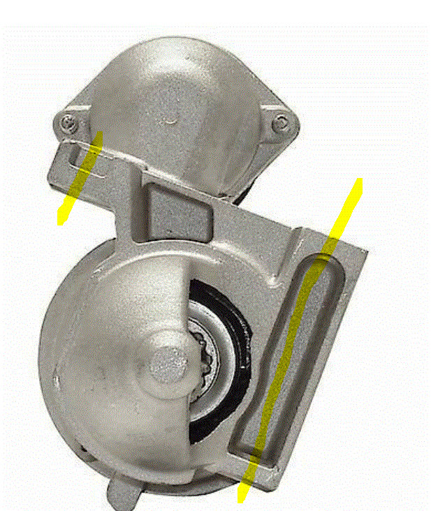

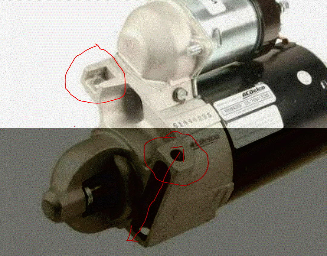

There are two bolts that hold it in place. If you look at pics 2 and 3 below, I highlighted or circled the bolt locations from two different points of view.

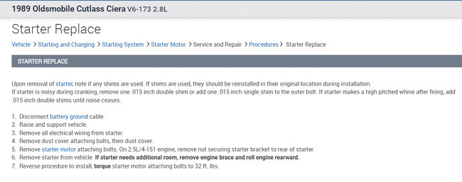

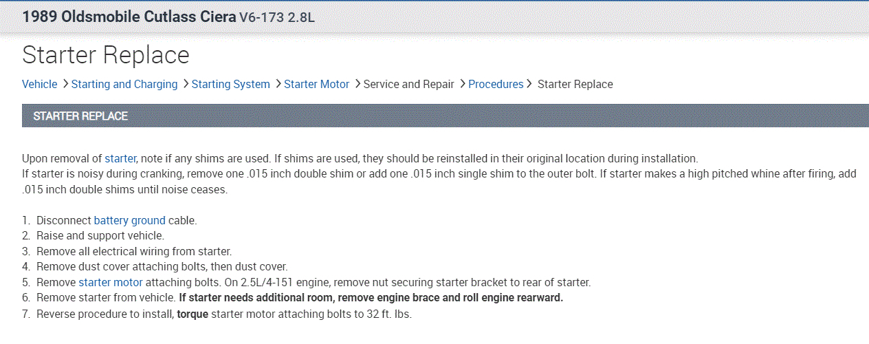

Pic 1 is the very basic directions from my manual. However, here is a link you may find helpful:
Please make sure the battery is disconnected prior to working on or around the starter motor.
