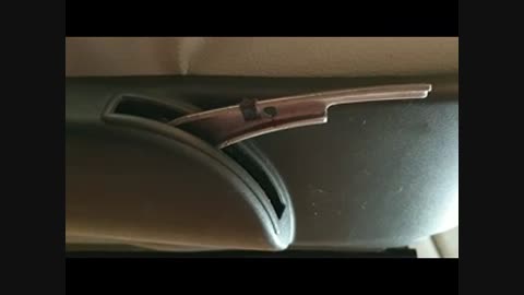

I am in the UK at the moment and I am trying to change the front leather seat covers on my sister's Saab 9-5 Estate.
The passenger seat has a lever on the left side and I am not sure what it does.
To remove the plastic trim at the base of the seat I have to take the plastic trim off of this lever. It seems that I need a magic wand as it does not want to budge. Do you know what I need to do to get this plastic trim off? I will post a picture from my iPad after I have posted this question (am on my Laptop at the moment).

I have actually been able to remove this piece from the lever. There was a small tab holding the plastic in place and one had to pry it away from the lever and then pull the handle off. I will post some images shortly.

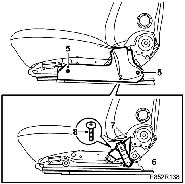

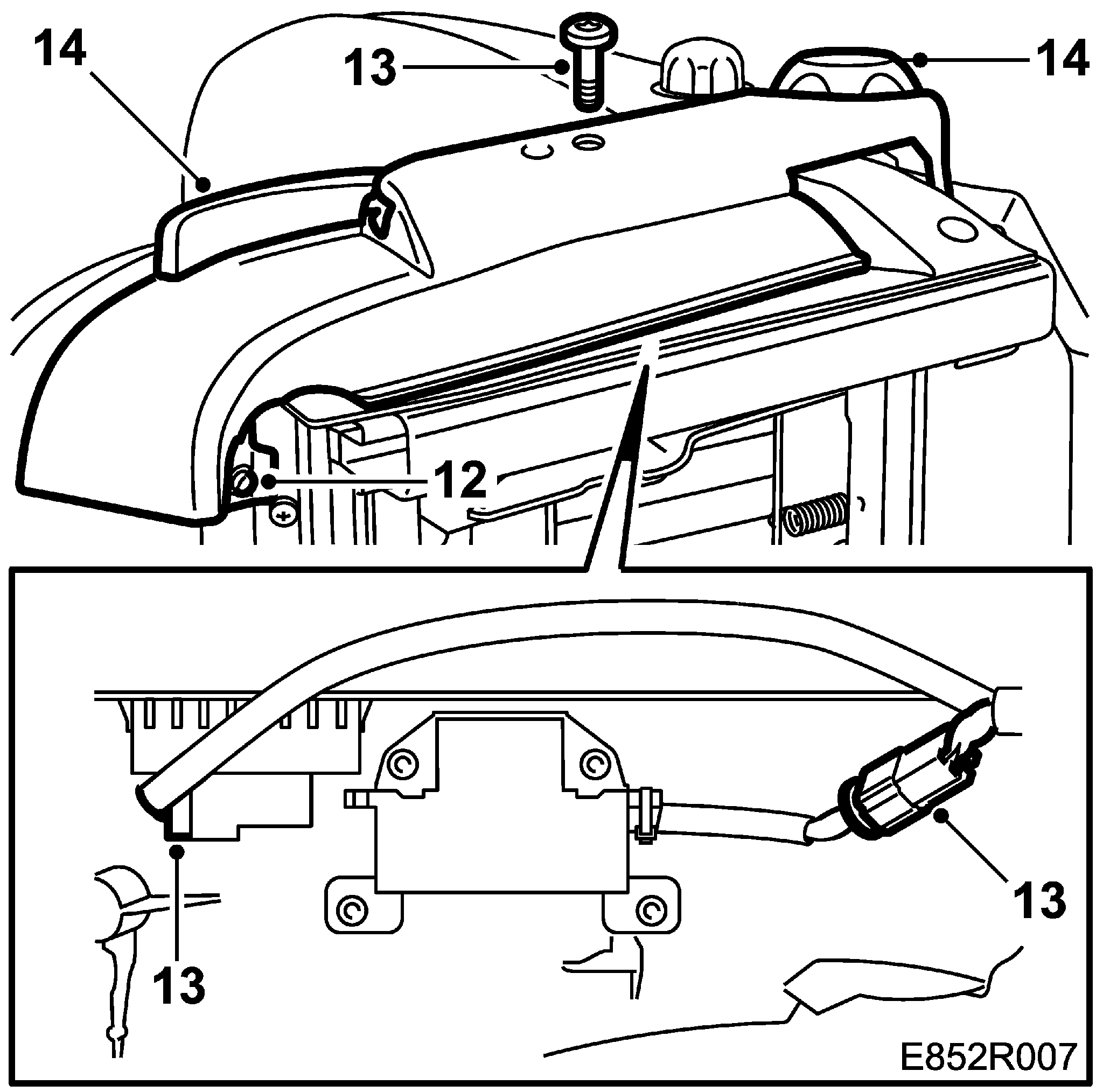

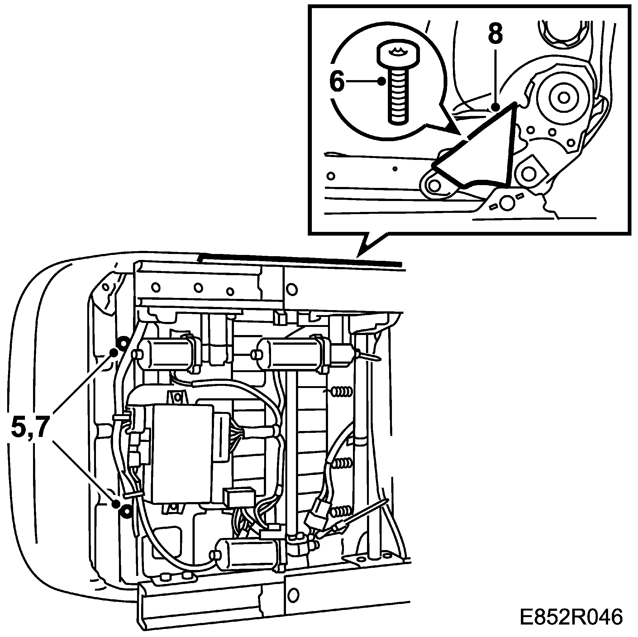

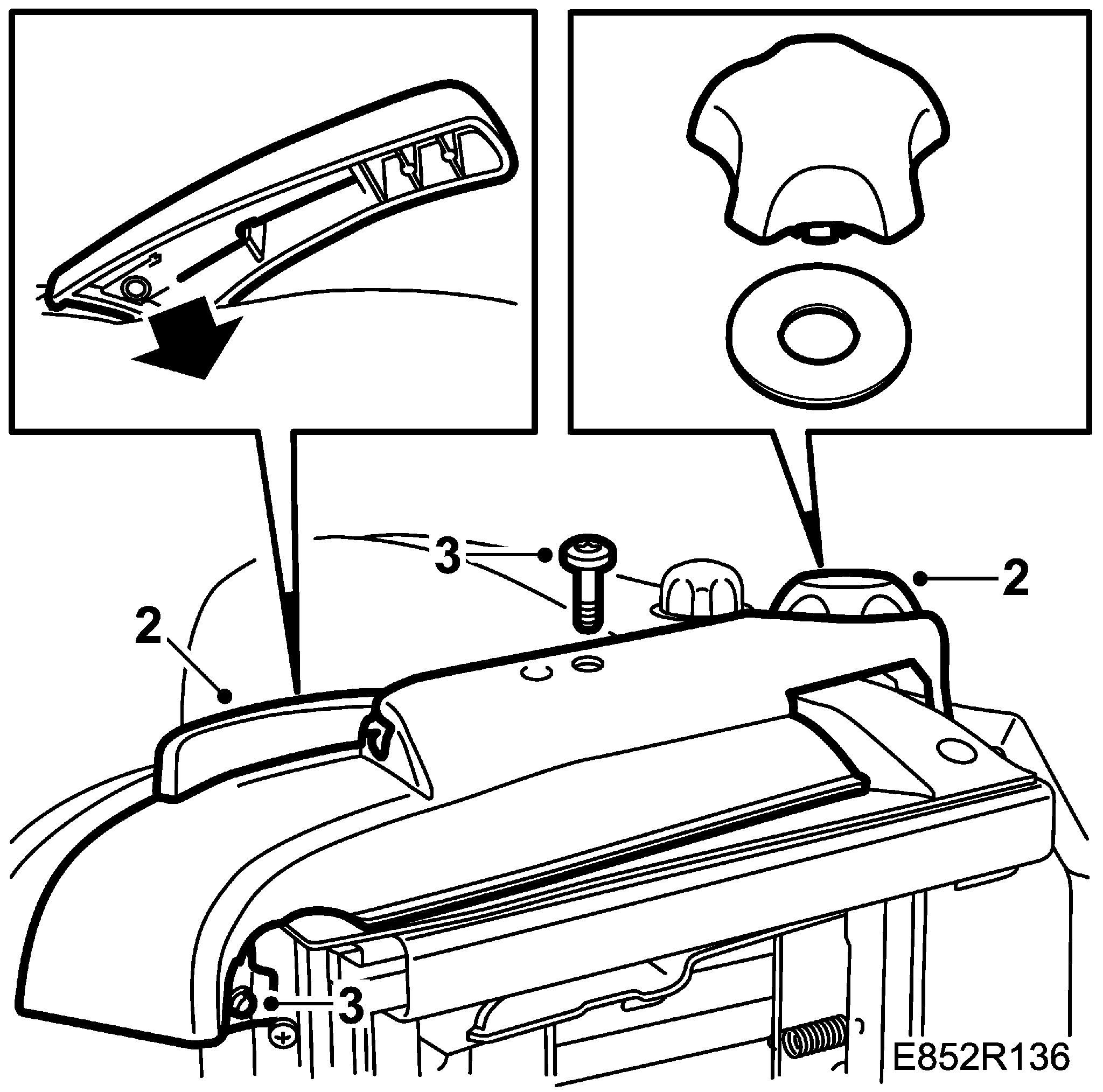

3. Remove the upper seat cowl, 2 covers and 3 screws.
Electrically adjustable seat: There is a protective cap on the tip of the front screw. Keep this cap safe and refit it to the screw to prevent damage to the electrical cables.
Pull the cowl backwards and bend up the rear edge, then pull it forwards.
4. Electrically adjustable front seat: unplug the connector for the switch and memory buttons, if any.
pic 2

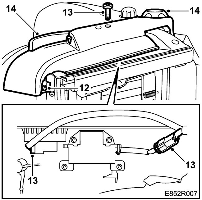

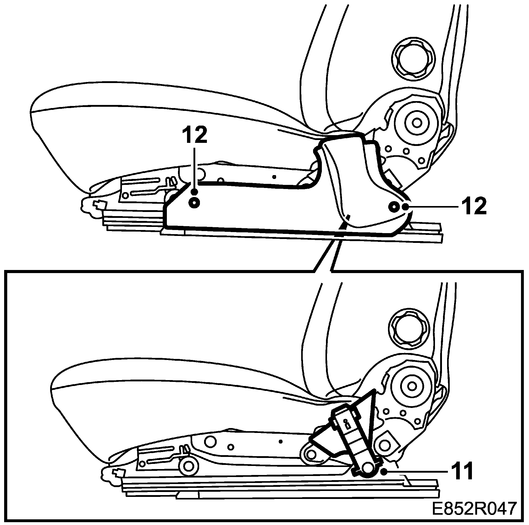

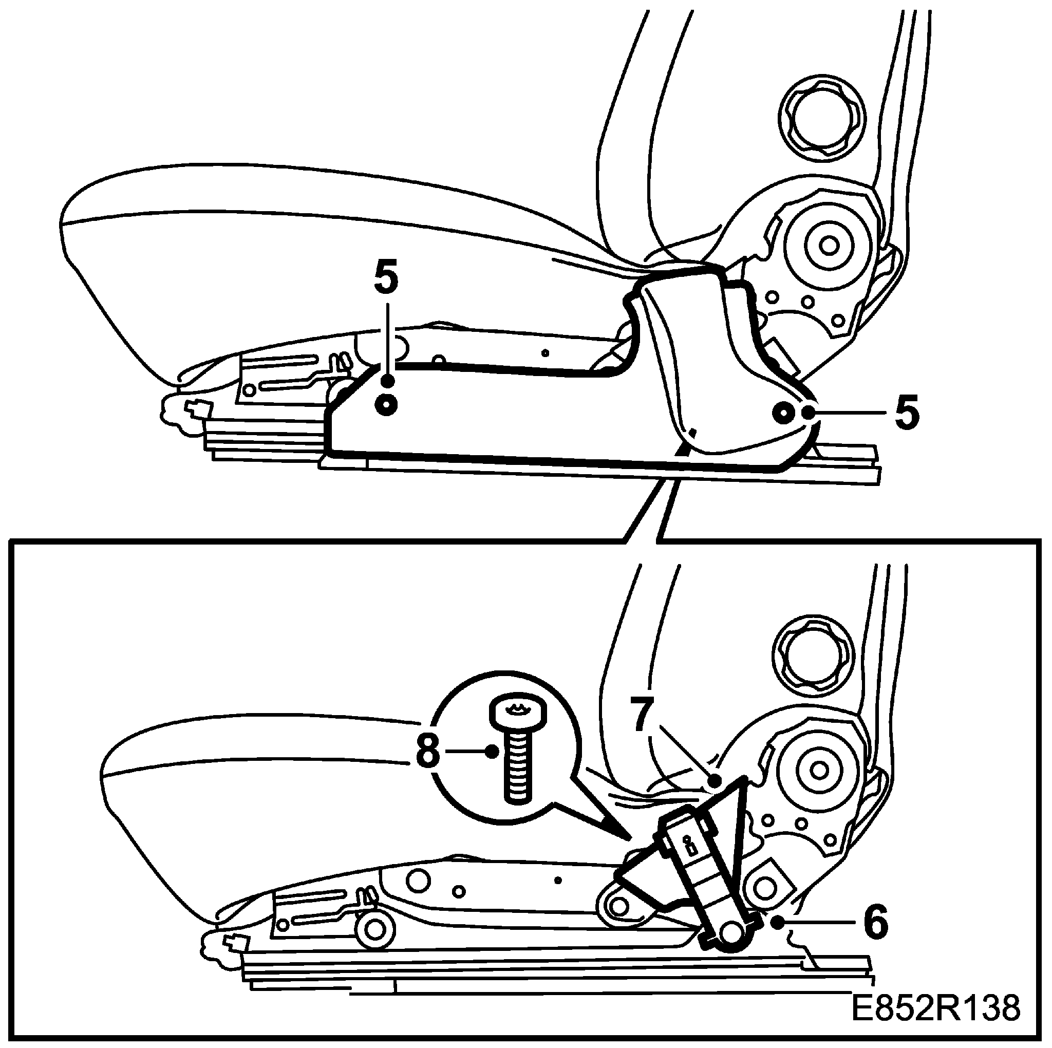

5. Remove the lower seat cowl, 2 screws.
pic 3
6. Remove the seatbelt mounting, 1 bolt.

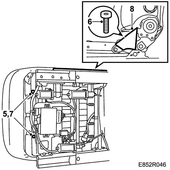

7. Remove the plastic cover on each side of the backrest joint.
These plastic covers are for holes used to reach the bolts securing the rear edge of the seat.

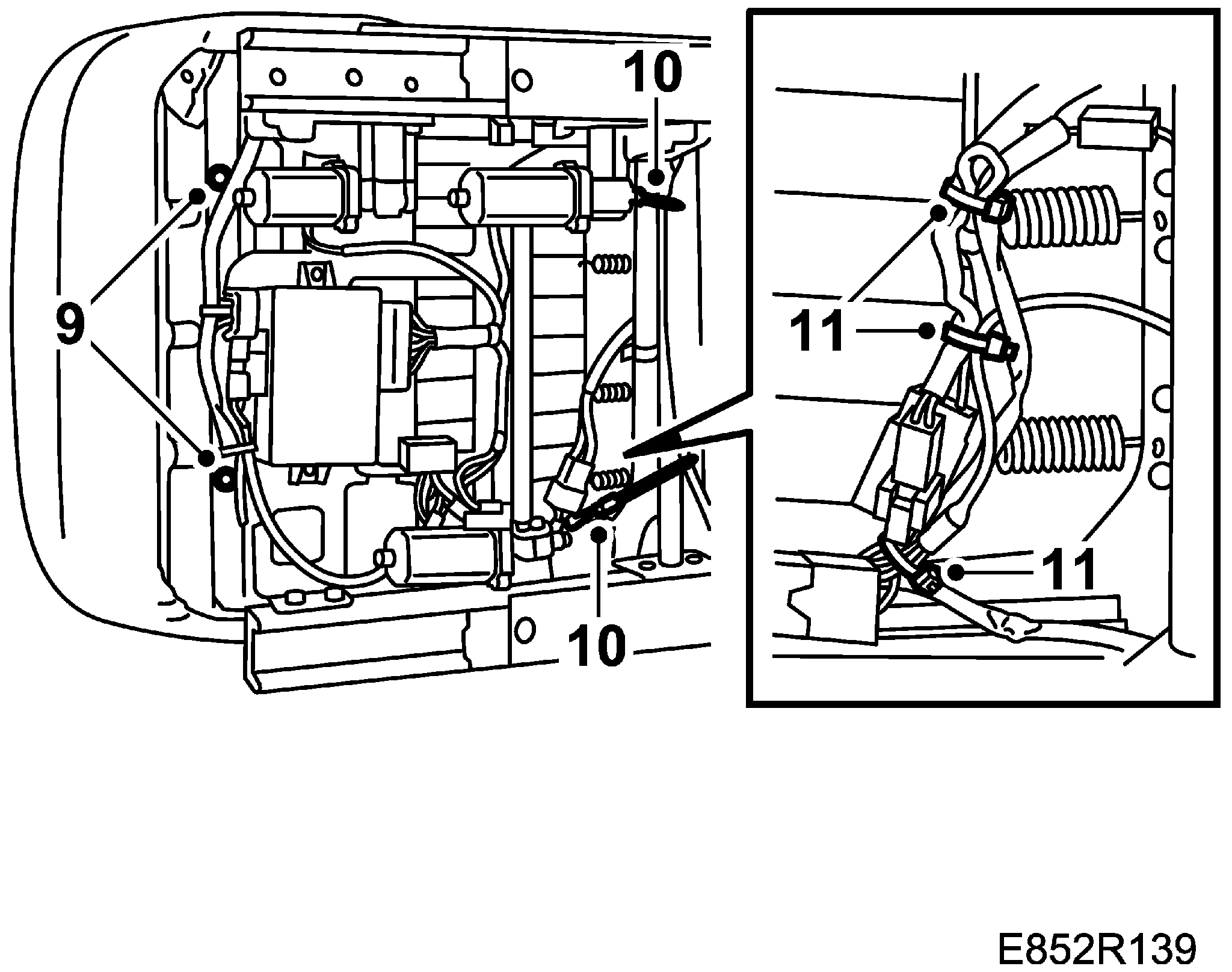

8. Undo the seat cushion at the rear, 2 screws.
9. Undo the seat cushion at the front, 2 screws.
pic 4

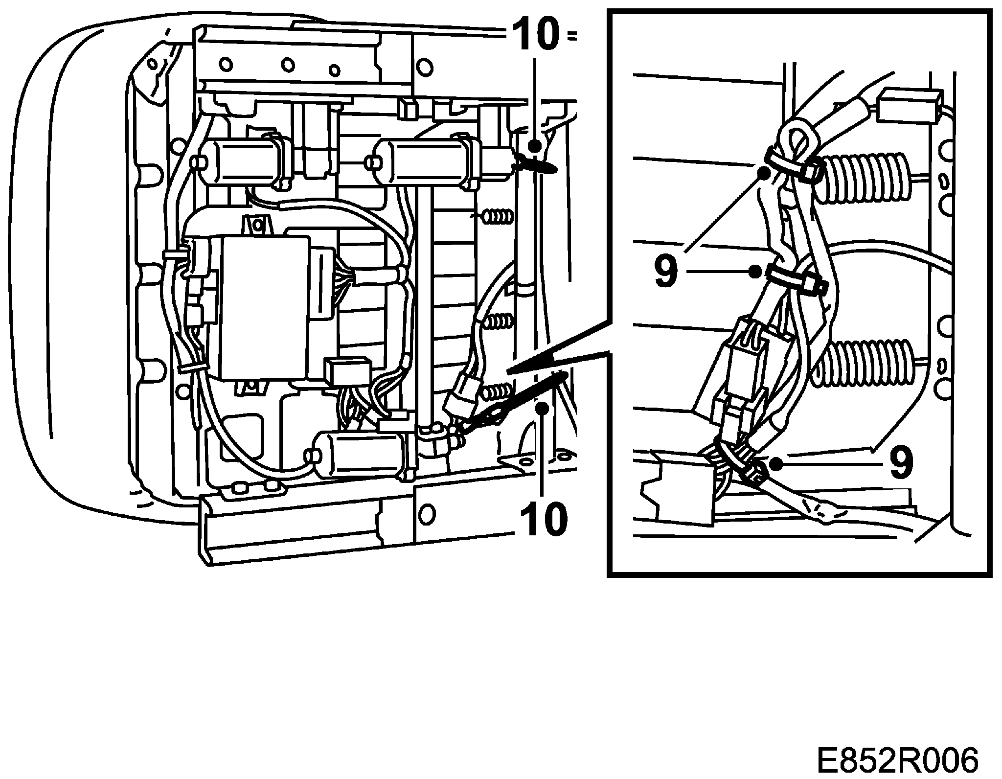

11. Cut off any cable ties. Unplug and mark the connectors.
Remove the seat cushion.

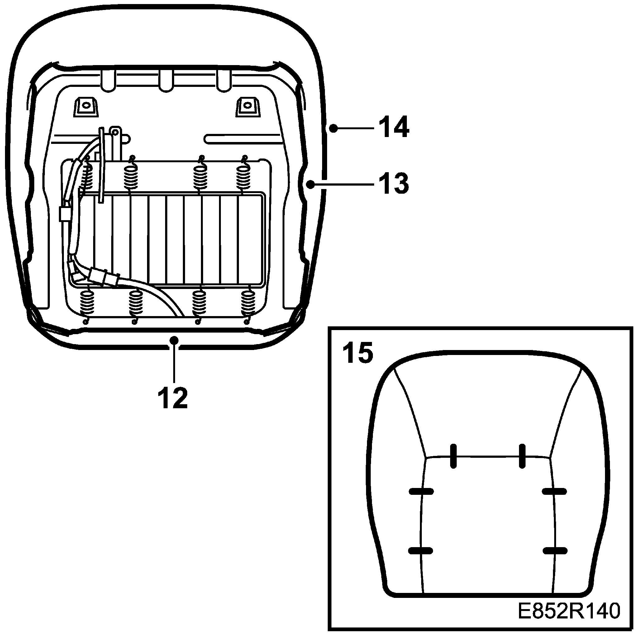

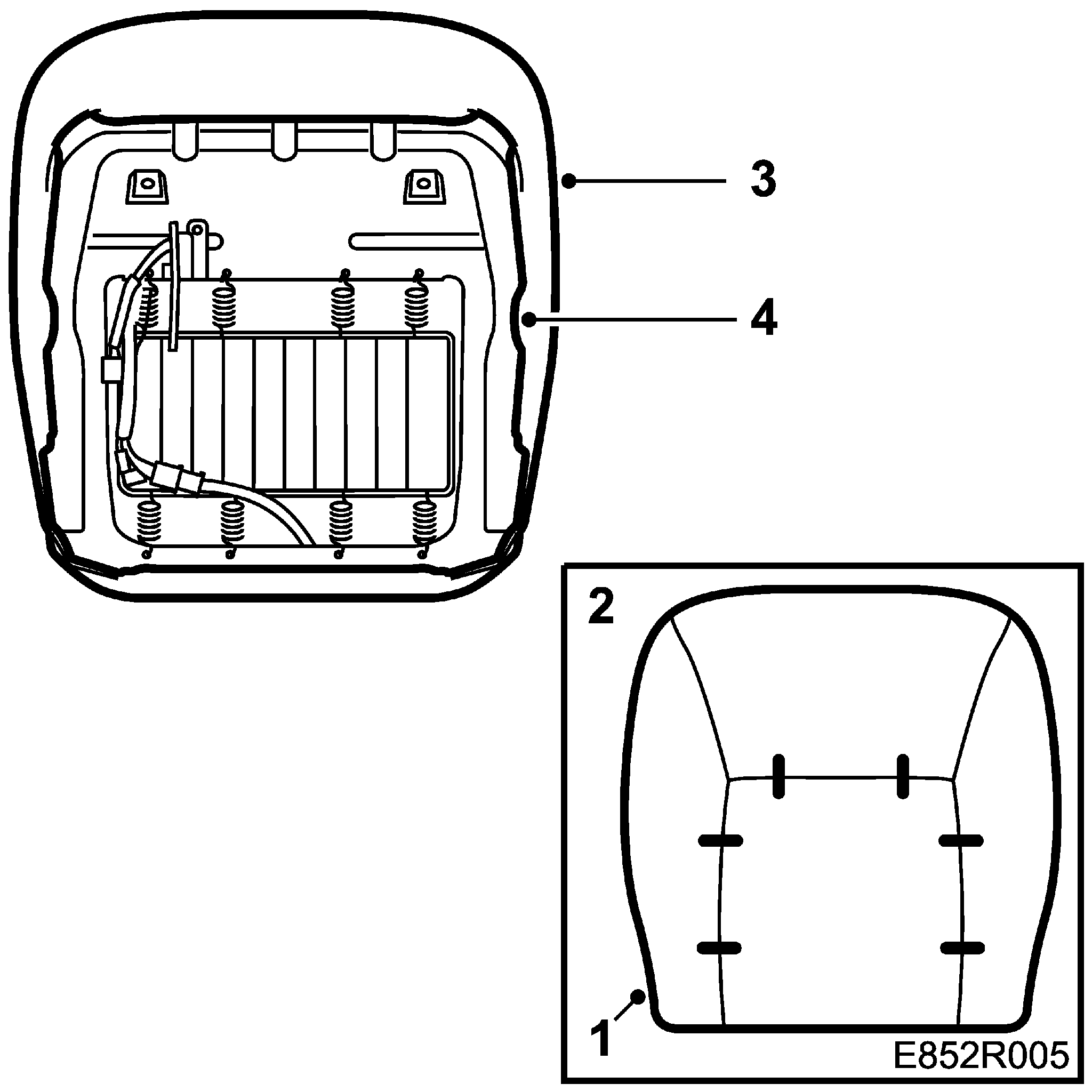

12. Release the upholstery strip at the rear of the seat base.
pic 5
13. Release the upholstery strip along the edges of the seat base.
14. Lift the seat base away from the foam cushion.
15. Cut the staples securing the seat upholstery to the foam cushion.
16. Remove the seat upholstery.

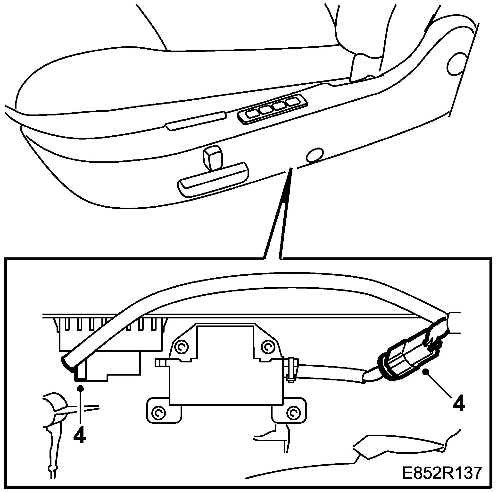

pic 6
1. Fit the seat upholstery over the foam cushion.
2. Fit the staples using the pliers in fitting kit, upholstery staples, 84 71 062.

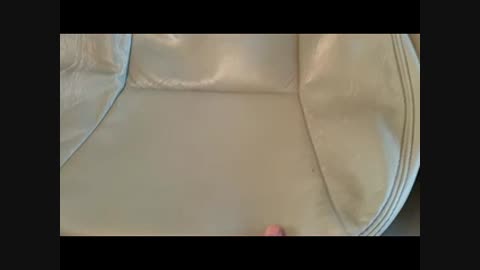

I didn't take a video of the seat covers before and after but I will take some photos of the old seat covers and a video of the new covers. But here is the lever video that prompted me to write this question. By the way, the driver's seat took less than half the time than the passenger seat, because I knew what to do this time around. :)

Here are the videos of the old and new seat covers. The old covers are on the left and the new ones on the right.
As a matter of interest I actually separated the seat backs from the rest of the seat. This made it much, much easier to fit the back of the seat cover over the metal frame of the seat as it is a very tight fit in the extreme corners (the seat cover needs to be stretched over the metal frame, which is impossible to do with the seat back attached). The torx bolts that attach the seat back to the seat are T50's. The torx bolts that hold the seat to the car chassis are T40's.

9. Take a small flat head screw driver and pry the lever cover off of the lever on the side of the seat. This is done by moving the lever down then fully up and taking the screw driver to the inside of the plastic cover and unlatching it from the metal part of the lever. See video from Thursday, August 1st, 2019 at 10:45 AM above.

27. Attach the side lever plastic trim by sliding it on to the naked metal lever and make sure you hear a click which means that the small round tab has engaged the hole in the metal lever.
