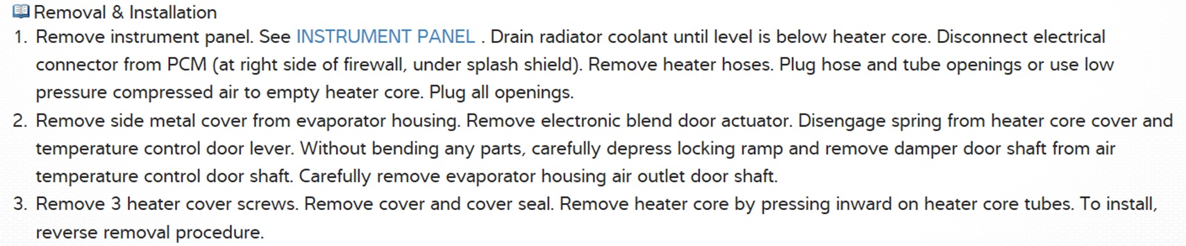

I got the hose disconnected , and i got the dashboard passenger side loose . Now i'm stuck .

the dash has to come out. see pic for instructions on pulling heater core.
