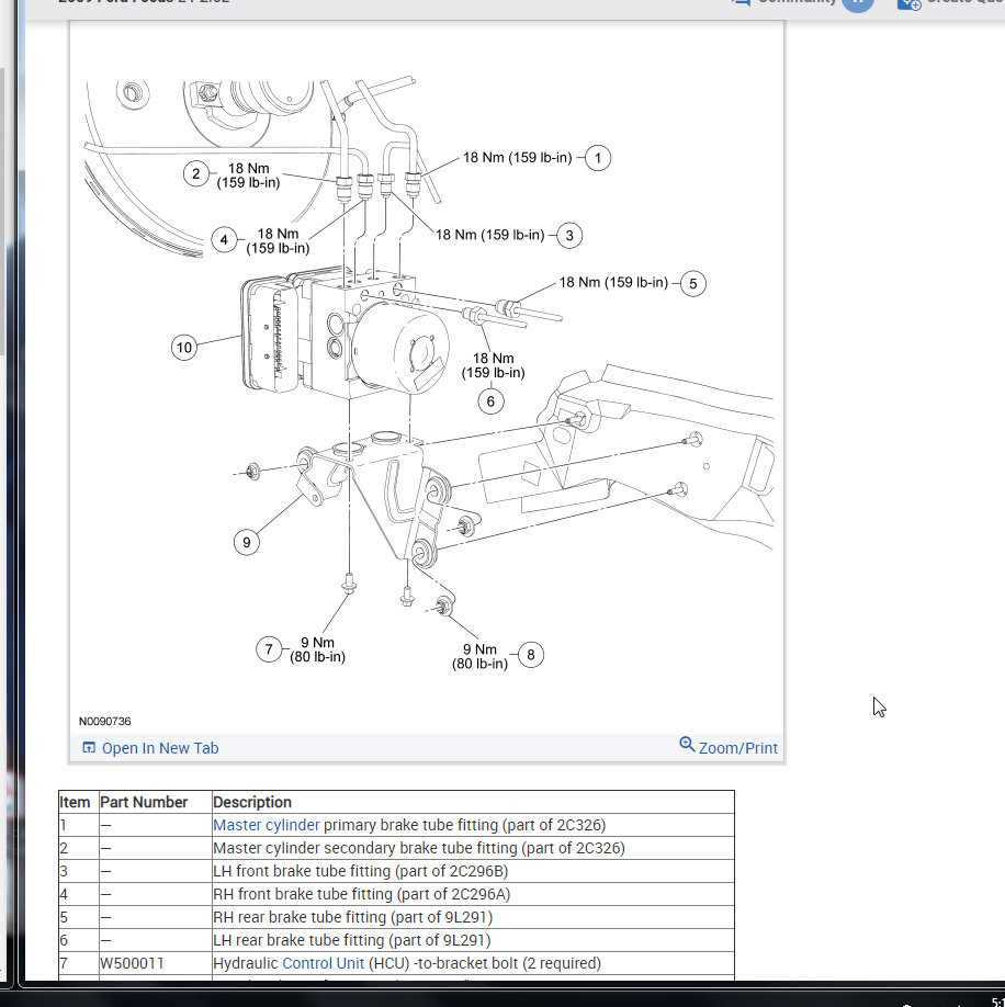

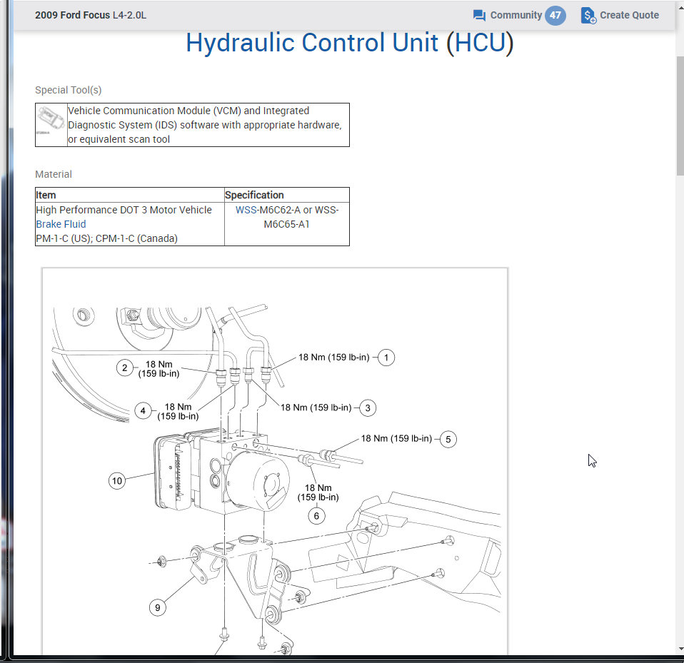

my ABS unit has failed on it.. was hoping someone might tell me the best way to remove it i plan on sending it to a shop to be repaired..
May 22, 2021 at 3:18 PM

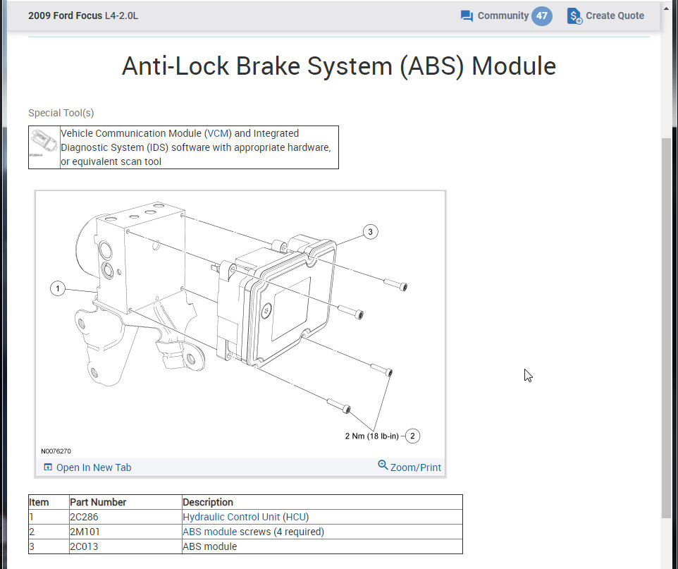

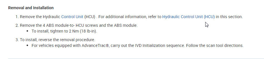

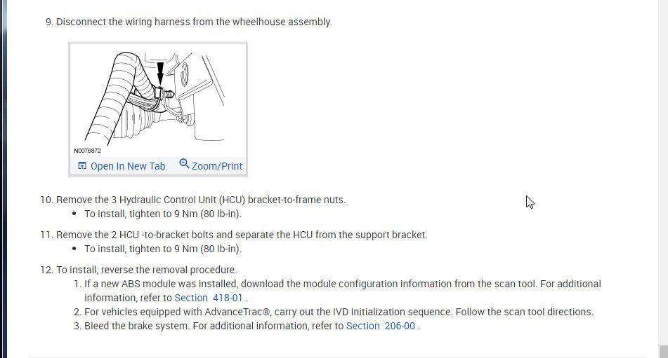

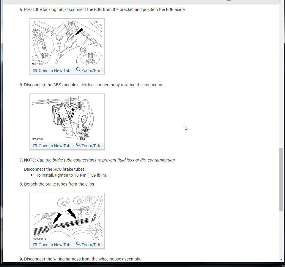

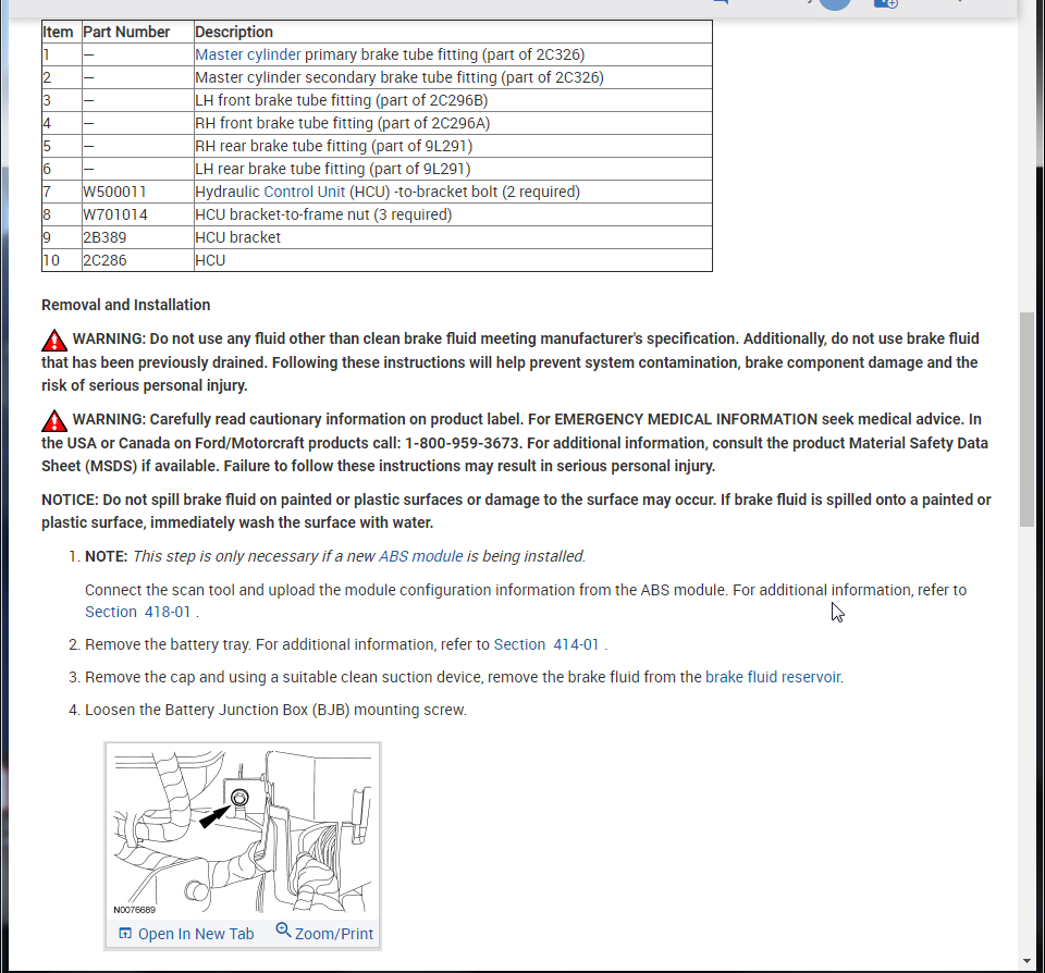

I am attaching the process from the manual. here is a guide that will help with step by step instructions:
https://www.2carpros.com/articles/how-to-replace-a-abs-controller
Below is the process from the manual. It appears the HCU needs to come off as well which means you need to bleed the ABS and then the brakes when you are finished. If you can get this off without taking the hydraulic lines off then that will keep you from bleeding the system but I don't remember if that is possible on this one.
Please let us know if you have other questions. Thanks

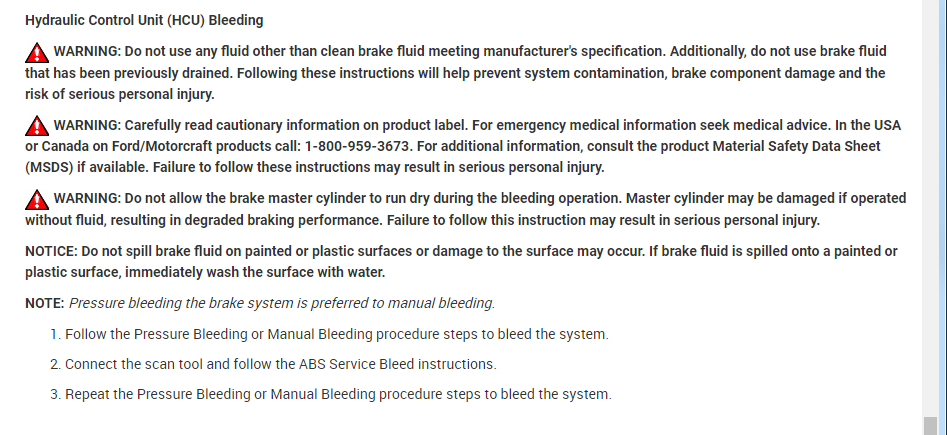

Thank you for the information. is there any special way I would have to bleed the HCU unit? I looked at the room around it did not see any way to get the ABS unit out of the car without taking it out together..
May 23, 2021 at 1:36 PM

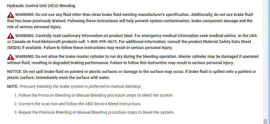

Yes. There is a process and it requires a scan tool to activate the ABS so that it bleeds the air out. However, this pushes the air out into the base brake system so you need to do this first and then bleed the brakes.
See below for the details.
May 24, 2021 at 12:32 PM
